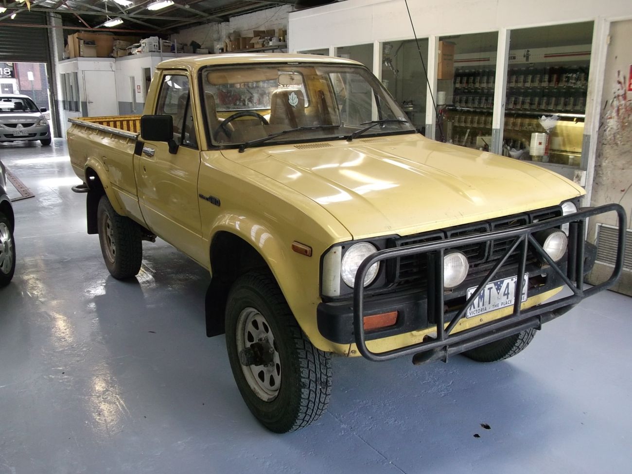

Hi to everyone from downunder. I'm from Melbourne (Australia) & I'm on the tailend of a megga restoration that started about 2 years ago. Originally had no intent on doing a write up but since I got so much good info off Yotatech & you lot in the US, I thought the least I could do was to share my adventure!
I've always had a thing for these first generation 4x4 pickups. In Australia Toyota marketed them as Hilux's and were aimed fair & square at farmers & commercial enterprises. Sold as both 2 & 4WD, they were as solid as grandpa's axe. But sexy they were not! No fancy decals or color schemes here. You guys got SR5's with 22r's & 5speeds. We got 18r's or l4 diesels, 4 speeds & rubber floor mats.... Also very few shortwheelbase units found there way downunder, most are 40 series LWB.
Anyway, I came across this truck while out looking at some real estate out bush. It was parked on the verge with a for sale sign. To the casual observer it didn't have much to offer, but it was absolutely 100% unmolested and complete. Not much rust & the styleside tub was in very good condition. Unfortunately it had done about a million miles and was very tired. But I had vision, (much to my wifey's dismay)
So I negotiated a very fair price & drove it back home. Hmmmm.
It actually looks better than it really is.

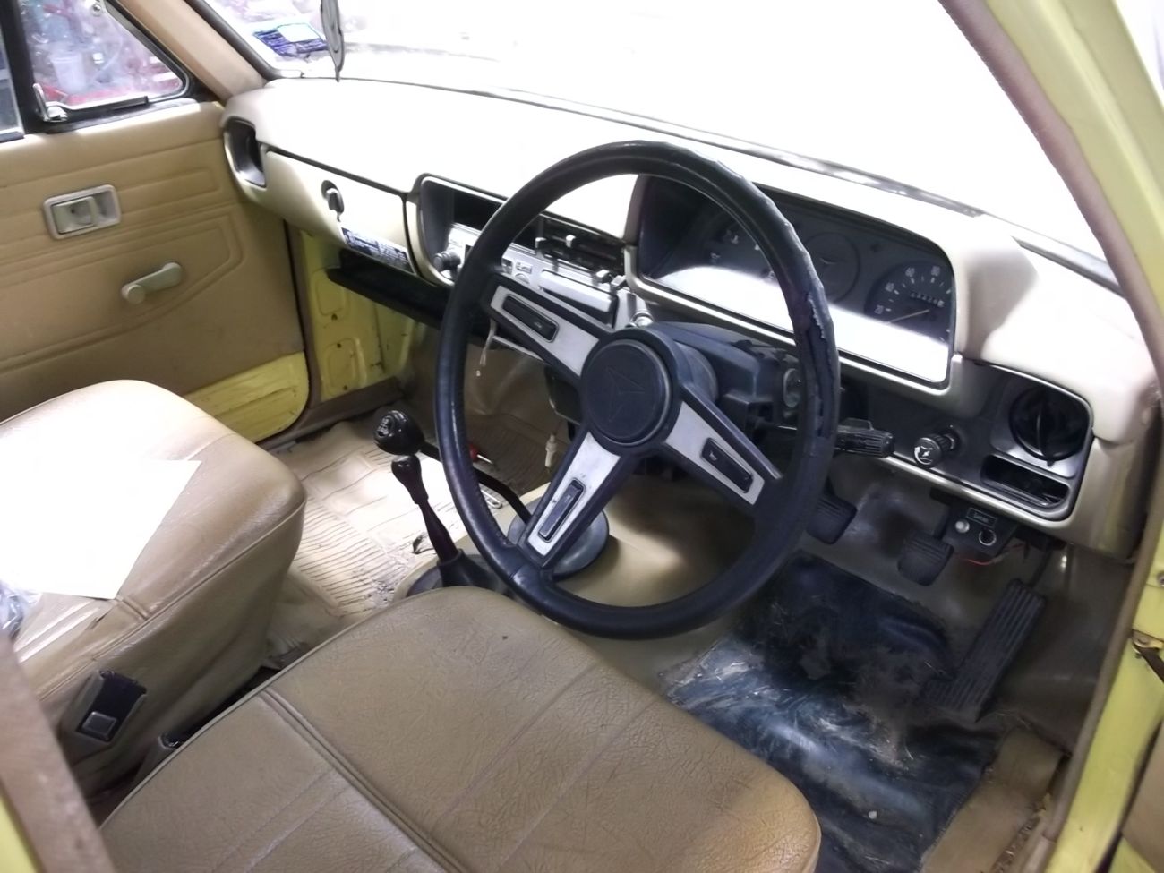

So we got the RN46 model body, which means long wheelbase, simple trim, no carpet or kick trims, no slider cab glass, no power steer, no 5 speed, no tacho.
Strangely though we got bucket seats, SR5 steering wheel (go figure!), braced tailgate & thoroughly ugly rear step bar. Also all vehicles had flipper windows in the doors. Airconditioning was an expensive dealer fitted option. Very rare.

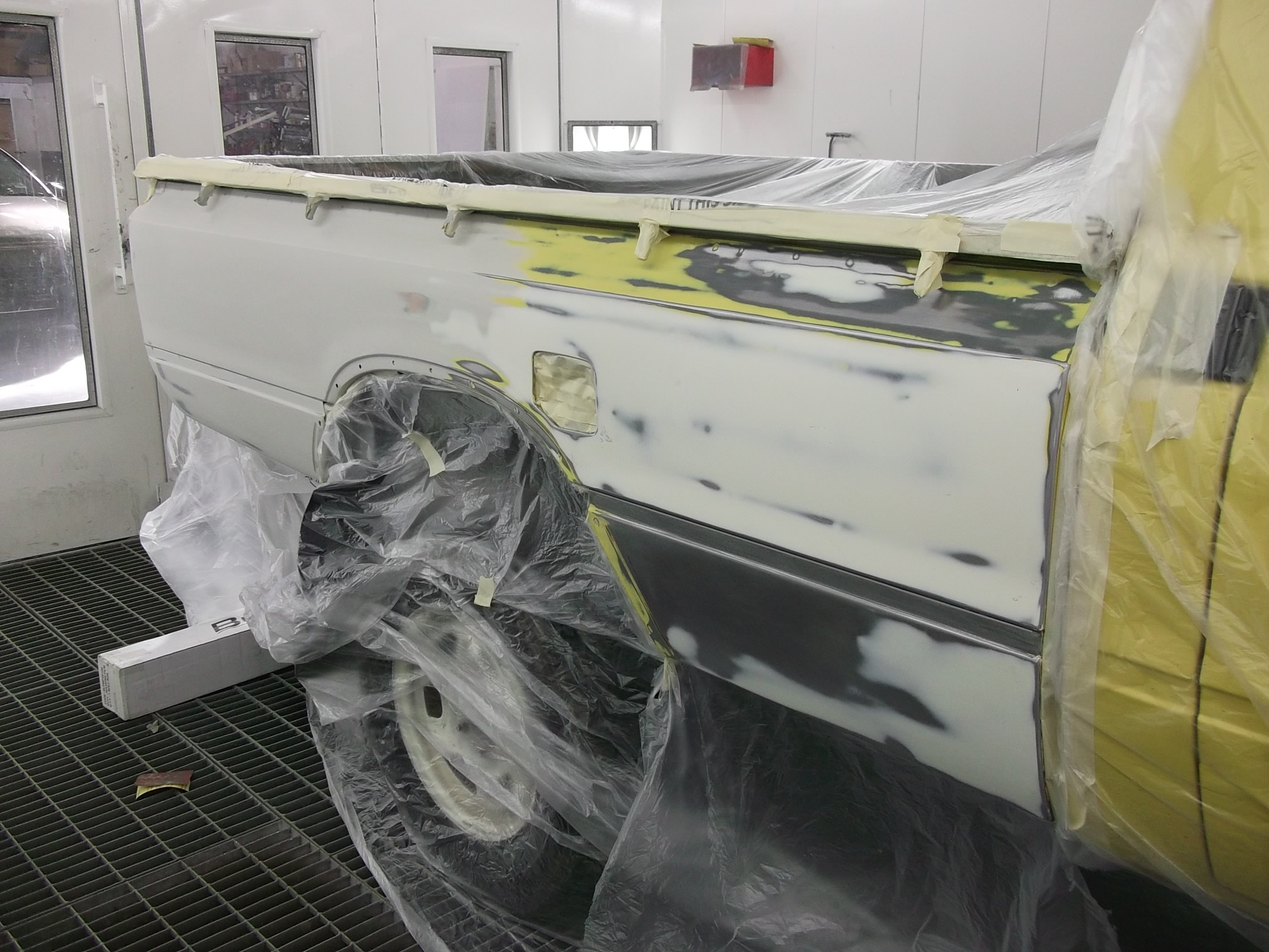

The plan was simple. Quick buzz & bondo, repaint & drive. I didn't really expect to do a full on body off resto but it was like squeezing bubble wrap & I sought of got carried away.

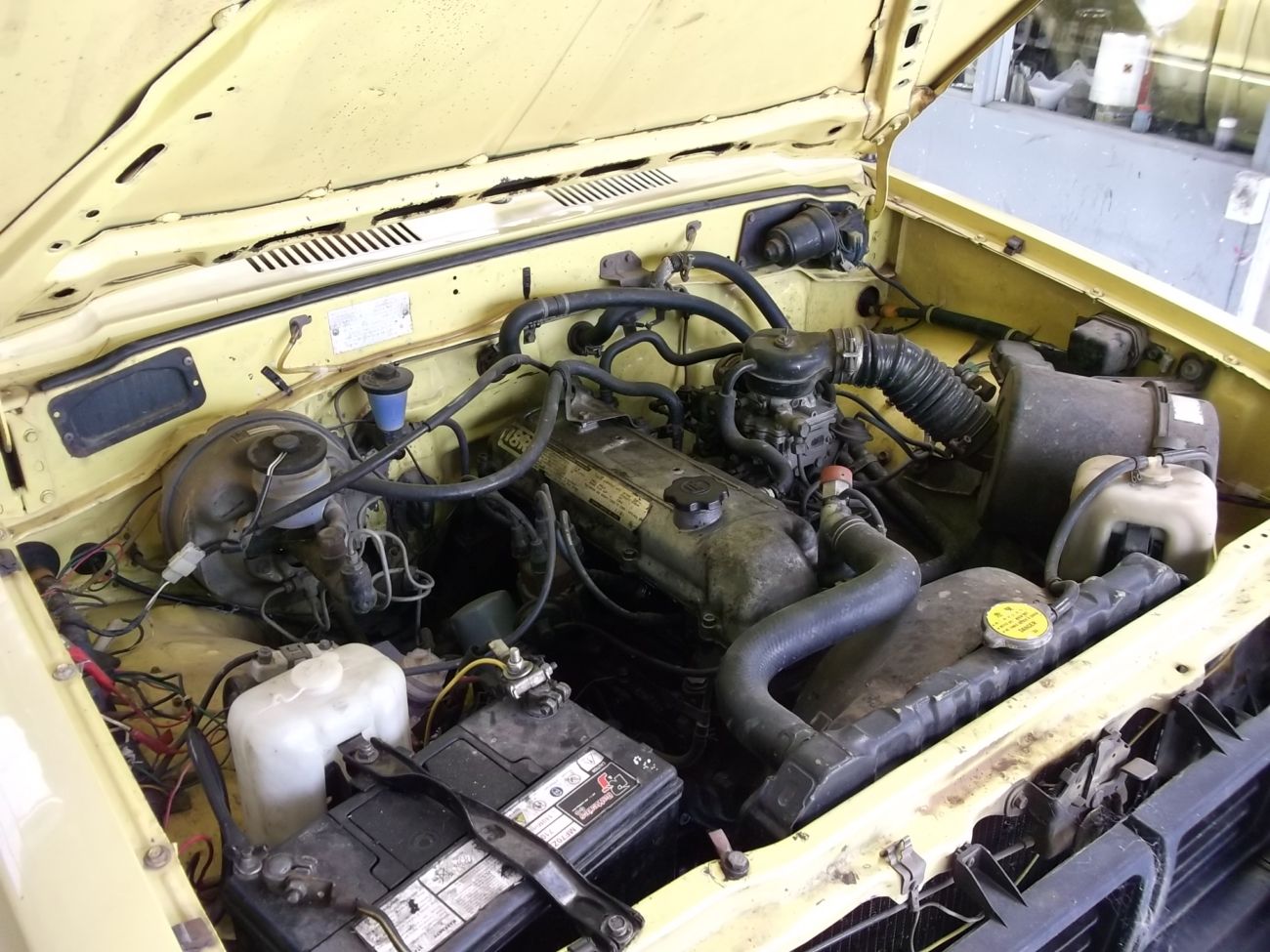

I was happy to retain the 18r in the short term. Some one had previously replaced the timing chain & tensioner so it was fairly quiet. It had some pretty serious oil leaks but it ran OK. I figured if I liked the truck, then a 22r or later 3rz would not be too big a deal.
The front axle seals were shot & steering & suspension needed work. The driveshafts needed attention but the transfer still worked. 1st gear was noisy & the oil light flickered at idle. The original Aisin carby had leaky throttle shafts & the secondaries didn't work. Suspect vacuum diaphragm no good. Had some rust under the windscreen rubber. Previous owner attacked it with silicone. Bad idea! This would prove to be a bigger issue than I had thought.
Front shock mounts had at some stage cracked & been welded. Need to fix properly. Standard issue fencing wire was holding the shifter together. Original push button AM radio & unhacked dash with couple small cracks in crash pad.

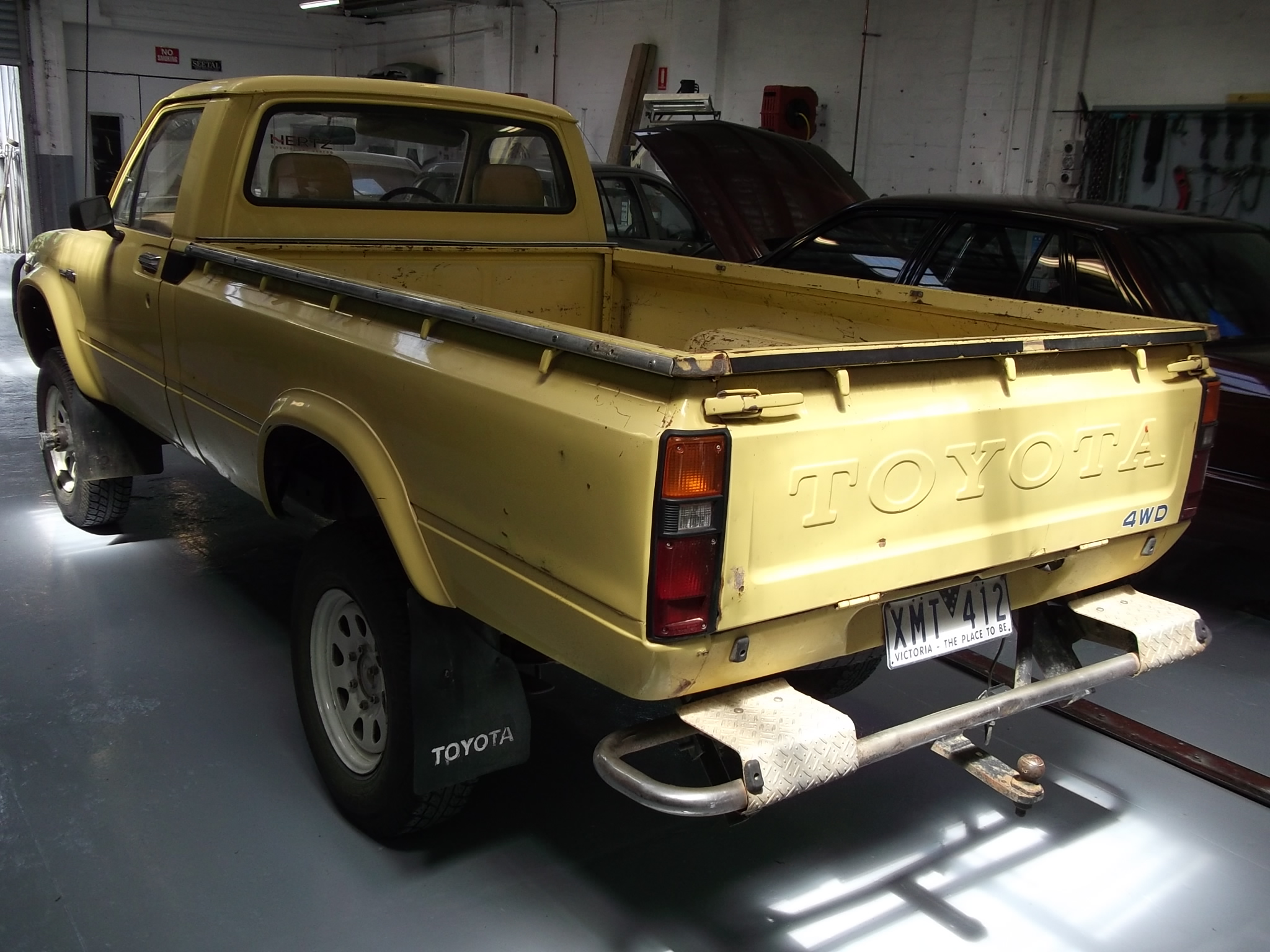

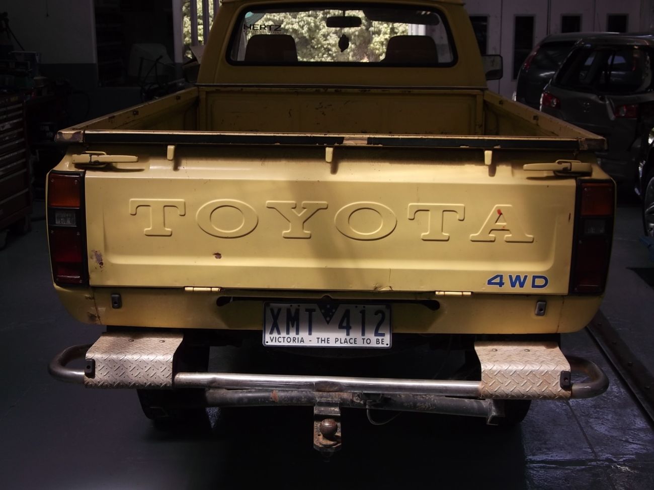

So how original is this truck? Well there is zero bog (bondo) anywhere. Every panel is factory. The lwr valance is perfect. It even has the little plastic gaskets on the valance where they meet the fenders.

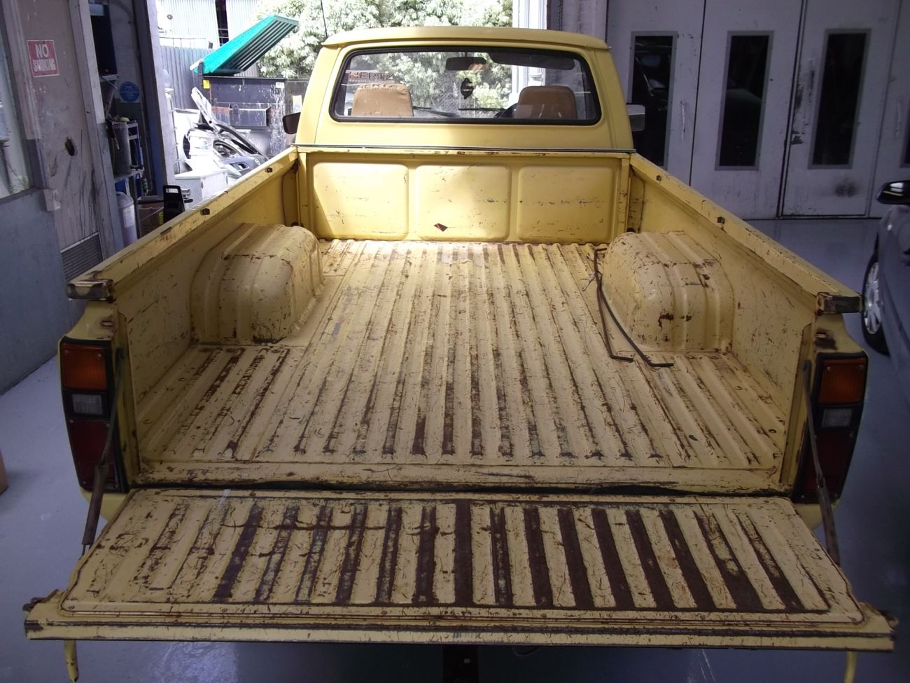

The rear tub has a heap of dents but is largely rust free. At nearly 8 feet long those dents really add up!

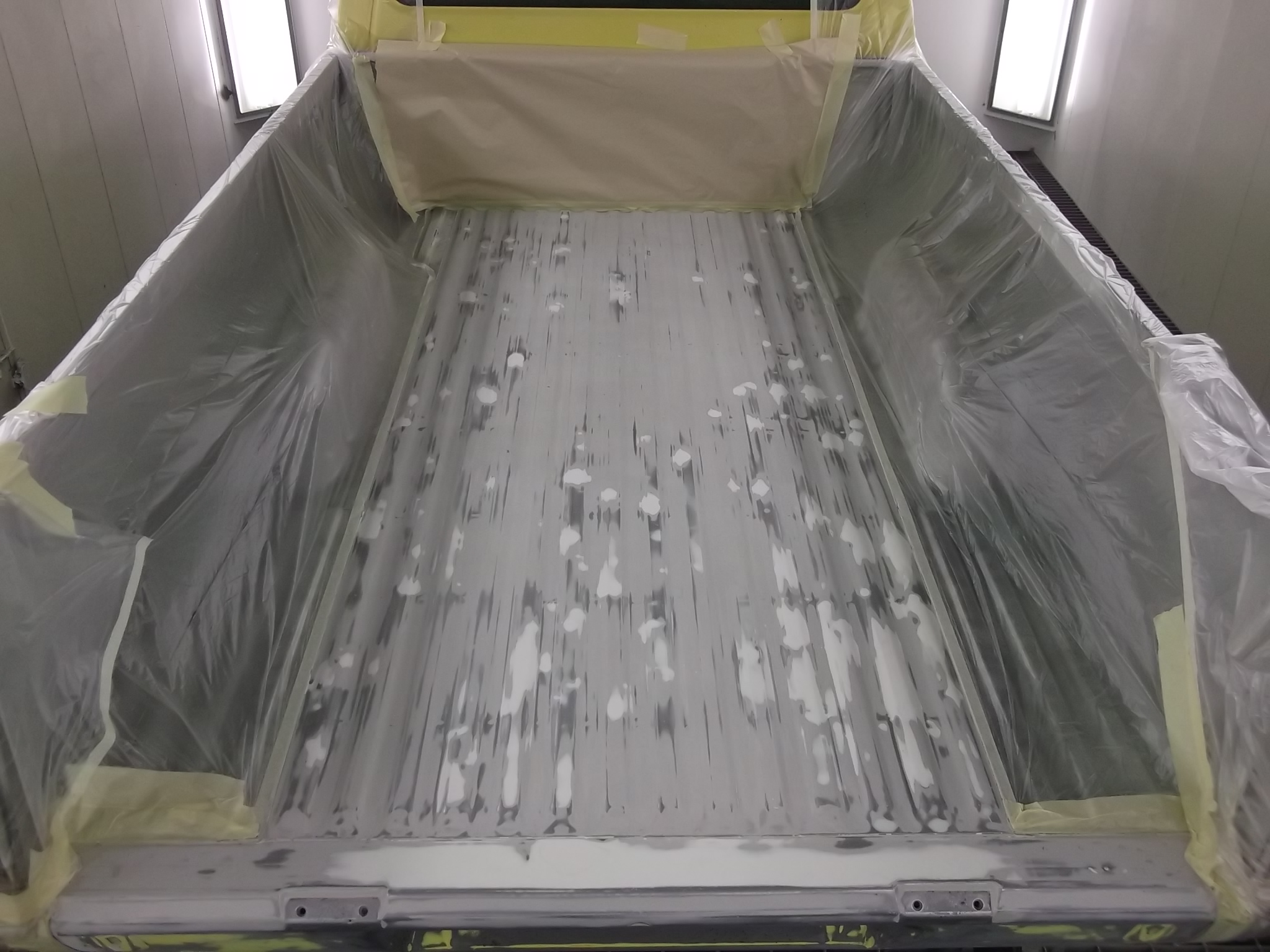

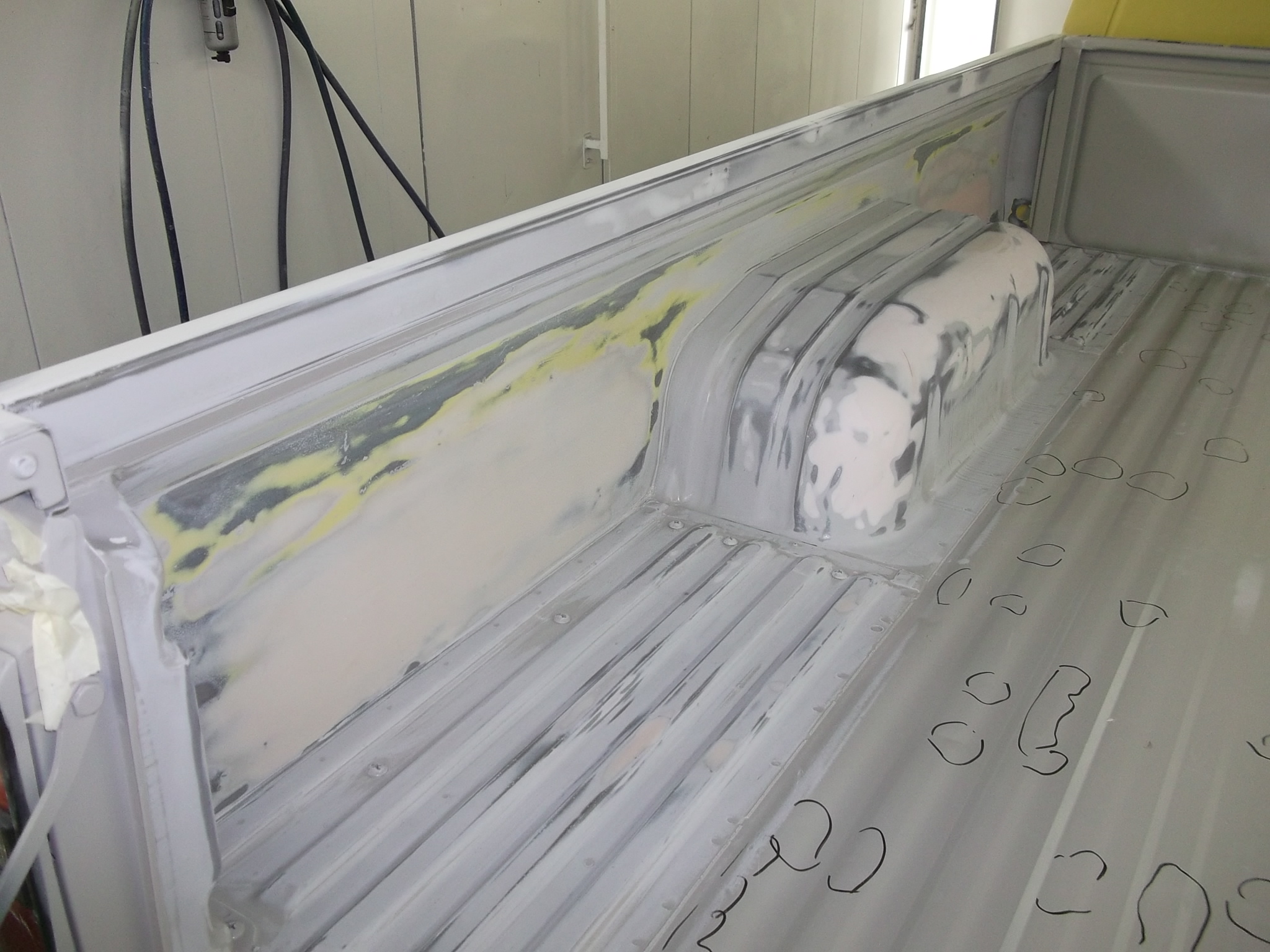

OK, tub was sent to be blasted. All paint/rust gone except for the sides. Single panel on these truck bed sides so sandblasting is a no no. Back to work & epoxied and body work begins. For the bigger dents to the floor, header panel & wheel wells, gentle bumping out then out with the bondo. The top rails looked like swiss cheese with all the extra holes. Welded up the holes & smoothed sides. The entire tub was primed proper then lifted from the body.
I would love to post the current pics of this truck but it would betray the sheer amount of time and effort it has taken me to get it to this stage. I will say it is orange, die straight with recaro's, parabolic suspension, koni adjustable shocks, and aircon. It is nearly finished!
We love pics, as many as possible, and yes most of us know the time it takes to do something like that, I spent a bit more than 1000 hours in 8 months rebuilding mine last winter. Now it seemed like it went by so fast!
Style side tub is almost finished. Time to look at tailgate. For the most part the tailgate was in remarkably good nick. Apart from some rust in the L/H bottom corner, there was a couple of awkward dents around the TOYOTA stamping. I feel for anyone trying to block / sand repairs or primer around embossed lettering. It is notoriously difficult to get 100%. Then I turned my attention to the inside backing plate. I un-riveted it and set about straightening it. Because years of loading heavy items on the opened tailgate had bowed the panel, I had to use a set to straighten each individual corrugation. An absolute PITA. It was A LOT OF WORK but you cannot buy these & I'm really glad how it turned out. I then welded a couple of steel tubes to the inside of the gate and ran a bead of Sikaflex down before re-riveting & seamsealing the panel back on. No rattles and the whole tailgate is rock solid. Once it was painted (2K solid) I scotchbrited the outside & detail masked the TOYOTA lettering. Then shot a coat of white basecoat, unmasked and cleared over the whole thing. Finally, I emptied the best part of a can of cavity wax into the gate so it should last another 30 years!

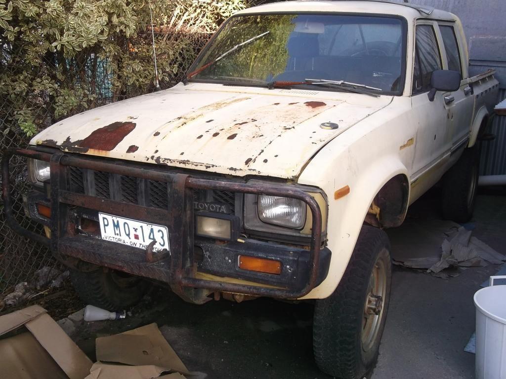

Managed to pick up an old farm hack off Ebay for $ 500. This truck was a square headlight 1982 dualcab. Originally a diesel, some one had junked the engine and fitted a Mitsubishi 2.6 Astron motor. This was a real find
. I scored a G52 five speed, crossmember, tailshaft, factory aircon (complete with hornets nest!) and lots of little stuff like factory door mirrors, salvageable SR5 steering wheel etc.
Picked up a bellhousing from later 22R and with a bit of grinding out the dowel holes, married the new 5 speed up with the 18R. Rebuilt steering knuckles, brakes & bearings & steering box & everything is coming along swimmingly.
