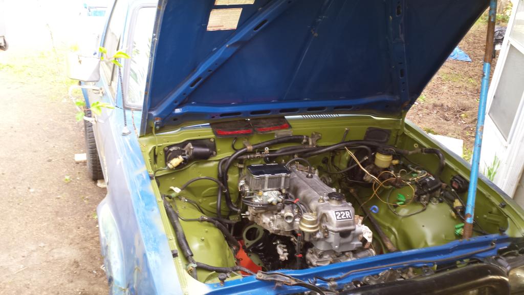

Here is when I pulled the engine for the second time in less than a month.

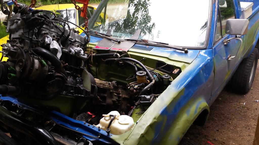

Completely de-smogged during the process too.

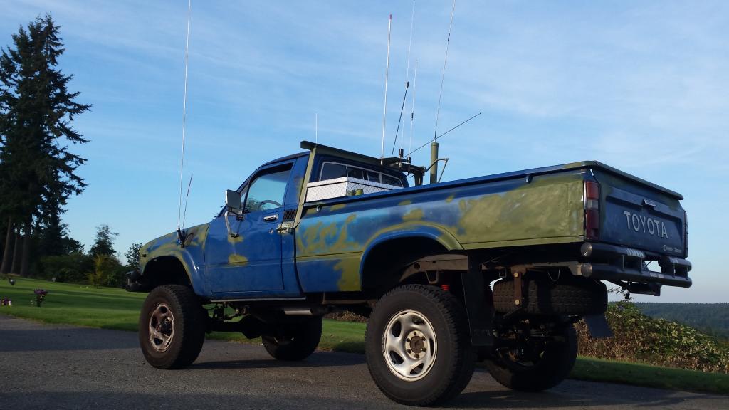

From the rear quarter

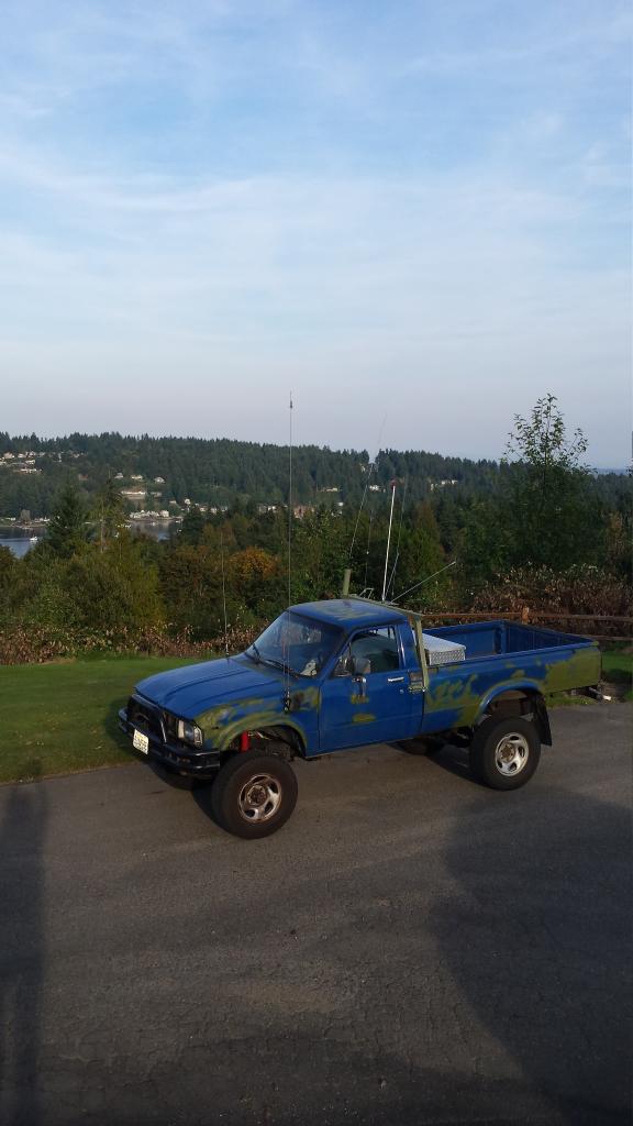

Good view of the whole truck

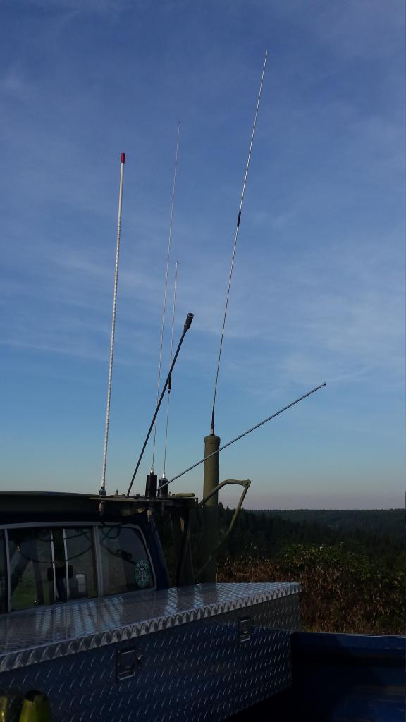

The antenna array:
From Left to Right: (off picture) is a 102" whip for the CB, and the CD/radio player's 58" FM antenna. On picture is a 10 Meter, a 6 meter, the UHF/VHF antenna, and the large one to the right is a 80-12 meter screwdriver antenna. The slanted "V" is connected to ground and a radial for the body.

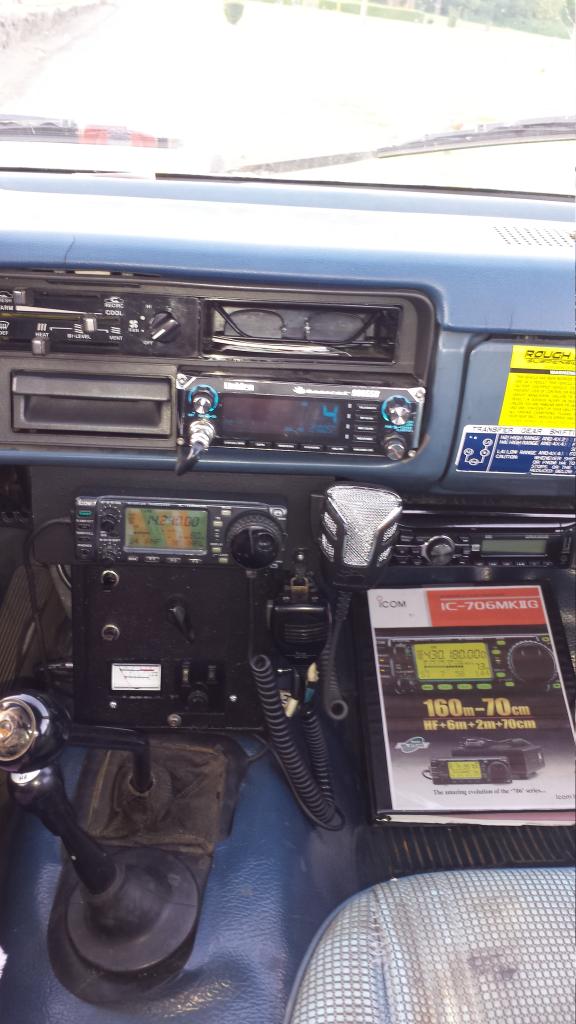

The radio set and switch board to control the antennas ~
From left to right: Icom 706MkIIG HAM Radio (160-10 meters +6 Meters and UFH/VHF), Uniden 980SSB Single Sideband capable CB Radio, and a CD player for some tunes. The icom was a successful fixer-upper that now has a few mods to make it MARS/CAP capable, plus the cooling fan mod to keep it's temps down. - It's a great communication package. I made the switch board and mounting assembly from scratch.

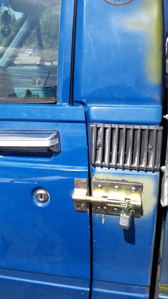

Not going to get in there easily, Yes the regular locks too, and it now has a pager/alarm to boot.

Uggghhh padlock really? Looks like I could remove a few Phillips screws and get in pretty easily.
X2 - Yep, keeps the honest thief out, but how many honest thieves do you know
Nope, you cant... Not without stabilizing the locknuts from behind, they will loosen a touch and spin. At somepoint they will get a tack weld as well. You'd need a sawzall or a very large crow-bar. By then, I'm probably bearing down on the poor sap with a vengful hand (and "other" equipment).
- Also, point of the rig is not to be a "pretty" truck, it's to be a catastrophy ready mobile command post, go anywhere and communicate, provide light protection (that part is not implimented yet).

Haha looking good but like others the padlock reminds me of the roadkill rotsun, a ''that will do'' thing, but it's much easier to enter by the rear window I think. Appart from that it's looking really good it must drive great after all that work.
I fully get the function over fashion attitude. Good thinking with the lock nuts!
