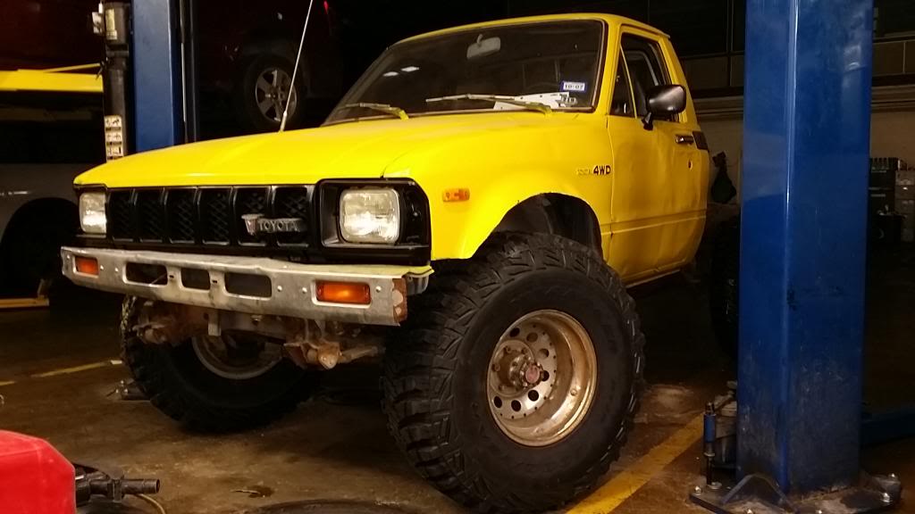

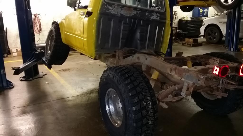

I did some more work to the truck today, I hammered the crap out of the fire wall and trimmed the fenders. Also removed the sway bar and flexed it as best I could before the left rear tire came off the ground. Let me know what ya'll think... Name:  20140308_180950_zpsac3711a6.jpg

What's the idea behind removing the sway bar?
Old Mar 8, 2014 | 06:04 PM
  #92
83TXYOTA's Avatar
Joined: Feb 2014
Posts: 65
From: San Angelo, Texas
Well, it's not going to be a daily driven rig and it limits the suspension in the front from being able to flex at all. I'm trying to keep the stock springs up front for a while and I'm going to run 63s outback to keep as low as possible with extremely good flex. Just trying to expirement and see how good of a suspension I can make work with this truck and the stock springs. I think if i can get really good flex outback, that it will make up for the little amount upfront. Also the shocks is what stopped the truck from going further upfront in the pictures.

Looks good! If you are still having clearance issues with the rear fenderwell/firewall, you can try redrilling your front spring perches an inch behind the factory hole, that should move the front axel forward and give you a some more clearance. I wish I would have done that when i swapped the 2" lift springs under my 83' last summer, but i didnt even think about it till after, lol.

I guess I could try and re drill that spring perch, 1 inch should help out alot since the tire barely touches the fire wall at full turn and compression. I used the big hammer method and hit the firewal
And as far as those wheels I'm not sure what kind they are but I'm not a big fan of them. I would like a 15x8 instead but need to save for the ones I want. As far as the cage it's gonna be a nice one. It's been an idea I've had for a while now and since my kids are going to be in the back it's going to be a nice strong one. Hopefully getting the floor done this week so I can bolt my fuel cell down. I'm going to test it out this weekend with a couple buddies and there rigs. We had a good time yesterday out on the trails we have here. If you type in "rock crawling Twin buttes" u can see some footage and trails we have here

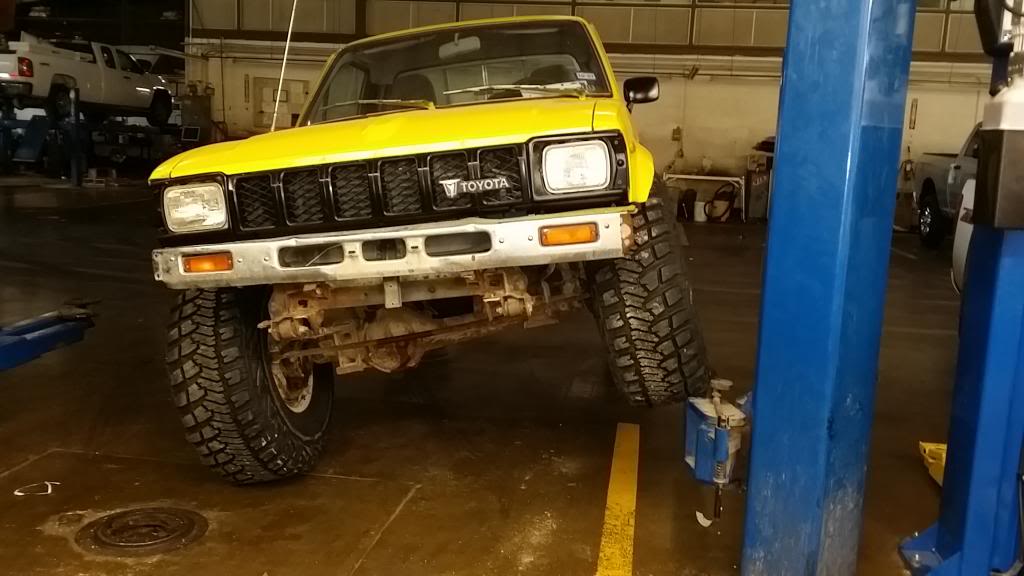

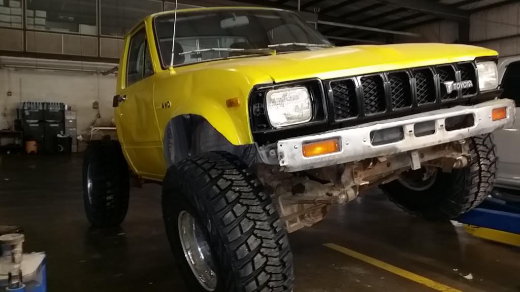

Went and tested the flex with the stock springs and I guess it wasn't to bad, could be a lot better but tires were in the firewall and shocks were limiting also. Here are some pics, also picked up a set of TJ coils for the future rear 4 link setup and set up a date for my roll cage to get built by my buddy Matt at West Texas Offroad.
I'm going to re drill the spring perch back 1 inch and tub the firewall some so I can go alot higher without tearing up my tires. I'll post pics tomorrow after doing that. I know it's not much I was just trying to get an idea of were I needed to cut and tub.
