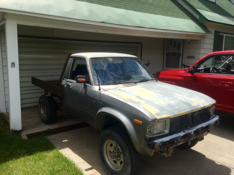

Found this monster. Time to bring it back to life. Straight off, I've got the option to stick with the four speed or convert to a five. Obviously more work involved with the five; worth it?? Just wanted to get some opinions.

Nice little 1st gen. Being an 83 it should already have a 5speed. If it is a 4speed, then the swap all depends on the kind of driving you do. I've owned both, and the 4speed wouldn't bother me if I didn't spend much time on the HWY. The 5speed would obviously give you a slight bump in MPG, and a more comfortable HWY cruising RPM.

The 5speed that it has doesn't line up with the crossmember that's supposed to support it. It's a couple inches too long. The drive shaft that it came with (riding in the passenger seat, not installed) is too long and I just assumed it was for the four speed, which the guy had sitting in the weeds next to the truck and threw in to sweeten the deal.

It sounds like the cross member fit issues your having is due to the "type" of 5 speed you have. I'm not sure how familiar you are with Toyota's, but Toyota made several different versions of they're 5speeds for the 4x4. The proper model of 5speed for your 83' is known as an L52. The L50 5 speed out of the earlier 81-82 would also fit perfectly. Any other 5 speed, no matter the year or model type will require some degree of cross member modification as well as driveline lengthening/shortening. The 4speed you have should also be a direct fit. The L-series transmissions that will fit can be most easily recognized by they're cast -iron cases. All other transmission will have all aluminum cases, and these will not be a direct fit. Hope this helps in your decision.

Definitely helps. Thanks. Sounds like the four may be the way to go in order to get on the road sooner. Probably not going to do too many highway miles anyway.

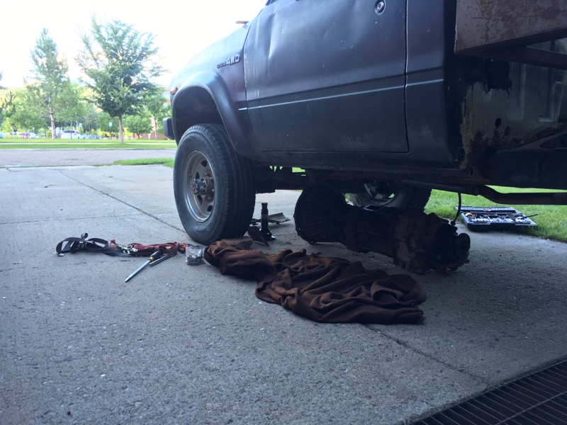

How to drop a transmission and transfer case driveway style...
