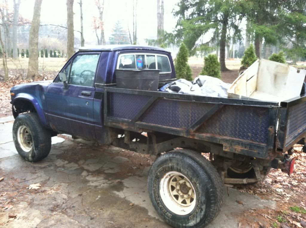

This is the first hilux I owned. At the time I had no clue what an sr5 was. Let alone that it was an sr5. Poor mans locker in the front ( previous owner filled the spider gears with kirksite). Convertible ( removable top ) and a set of cut down doors.

This is what happened to it...

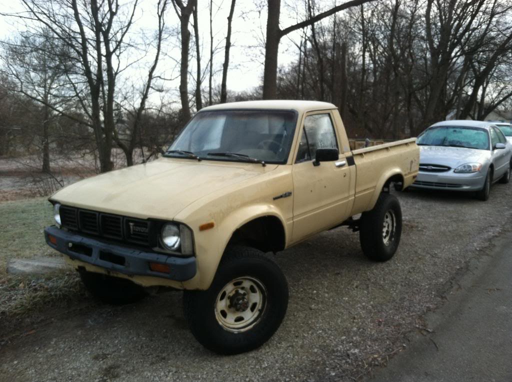

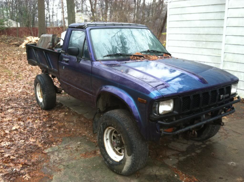

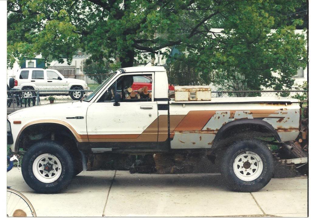

This 81 I picked up a year ago. Somebody swapped in a 21r-u. It now has my 22r from my 83 with the 22r-u head.

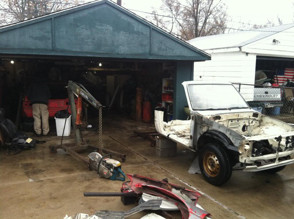

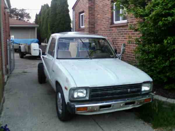

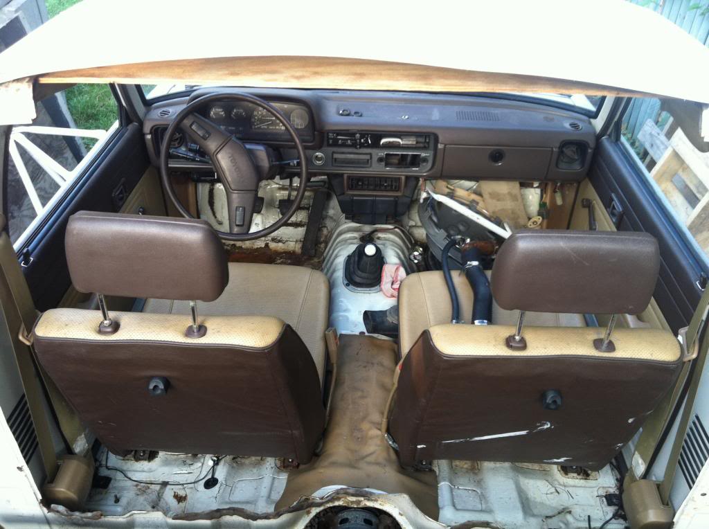

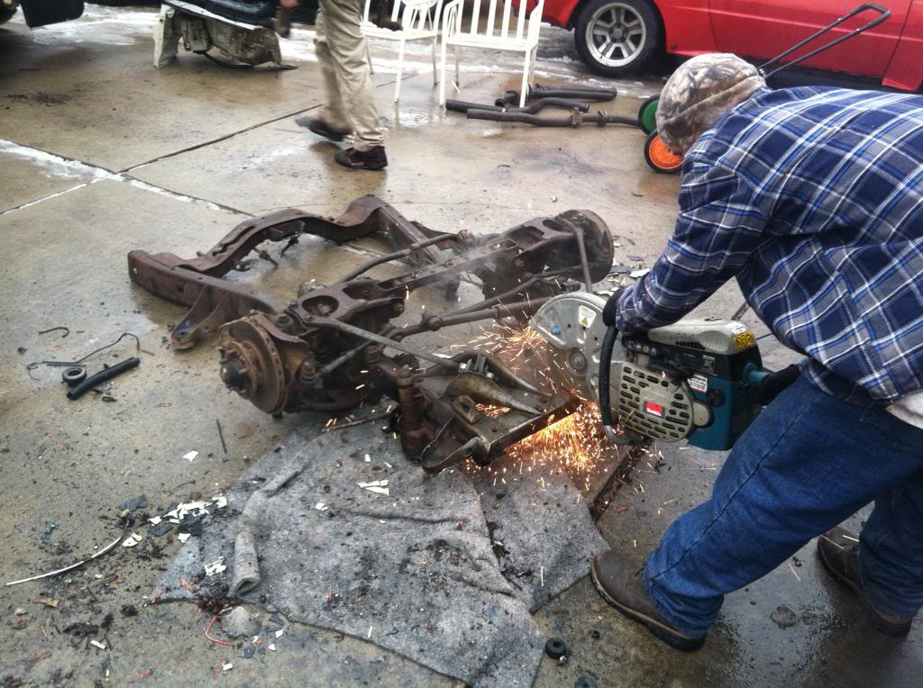

This is the 82 motorhome I picked up last summer. 17,000 miles 22r. Near mint interior. Stripped it of anything and nearly everything worth keeping. Told a friend cut it up and you can have the scrap! It was hard to let it go. I wanted to save it for a fun 2wd project.

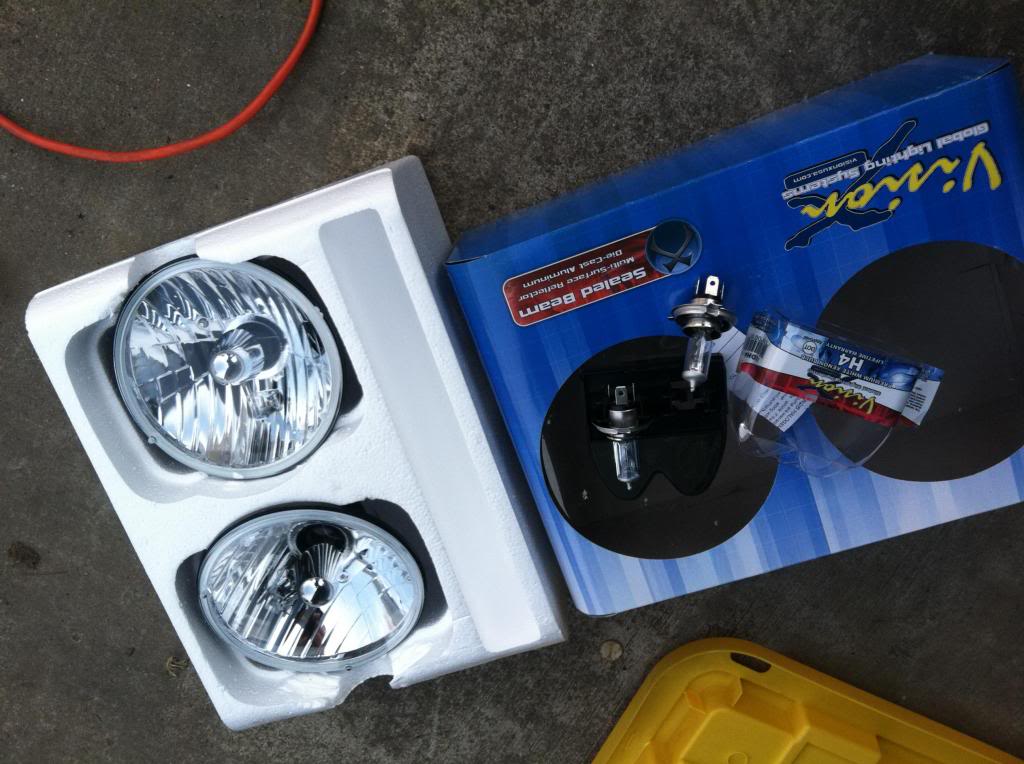

Light brite
Got these in a while ago.

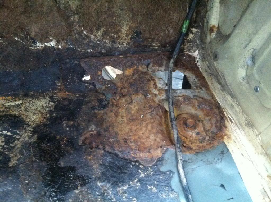

Ripped out the carpet the other day. Only to find I should have also saved the front floorboard/cab mount from the motorhome...

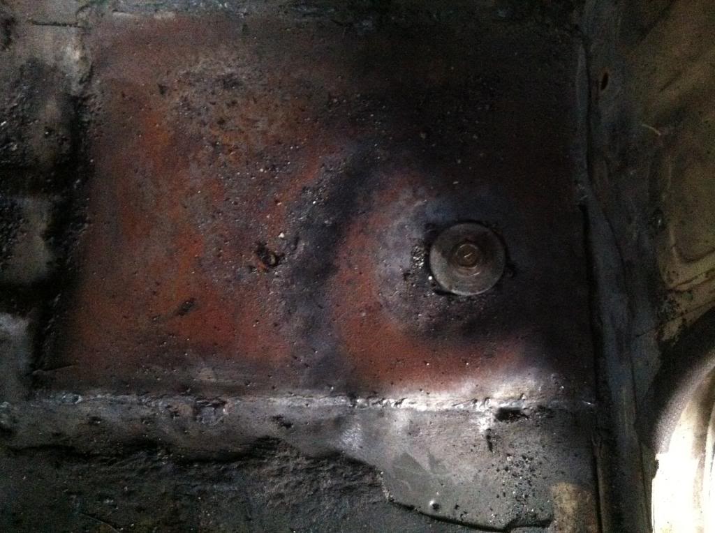

Took care of some patching last week.

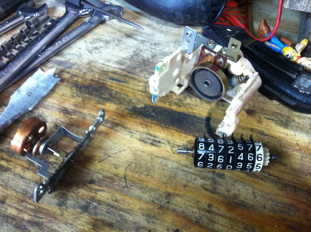

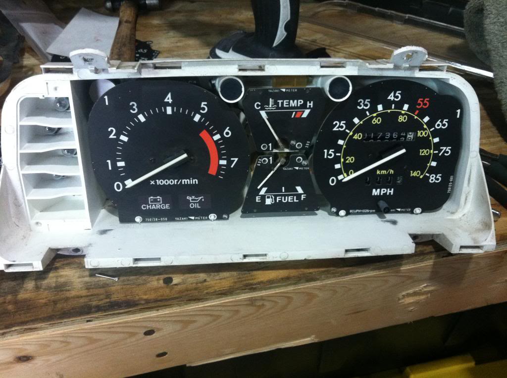

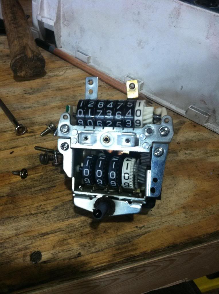

Rebuilt the odometer out of the 82 swapped the trip meter too ( low mile less wear and tear ) so I can install the 83 sr5 cluster in working order when I do my interior swap! The 17,364 miles matches the 22r that will be installed soon

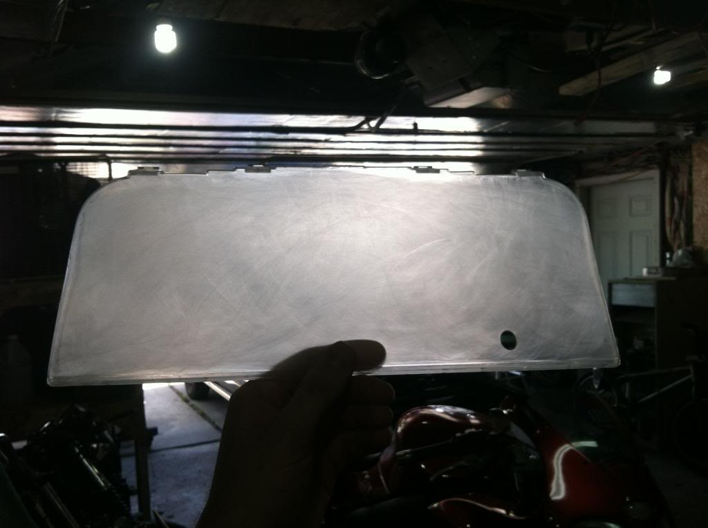

I wet sanded the cover with 320 to eliminate the deep scratches then 800 grit and clear coated with a glossy finish came out great when I was done.

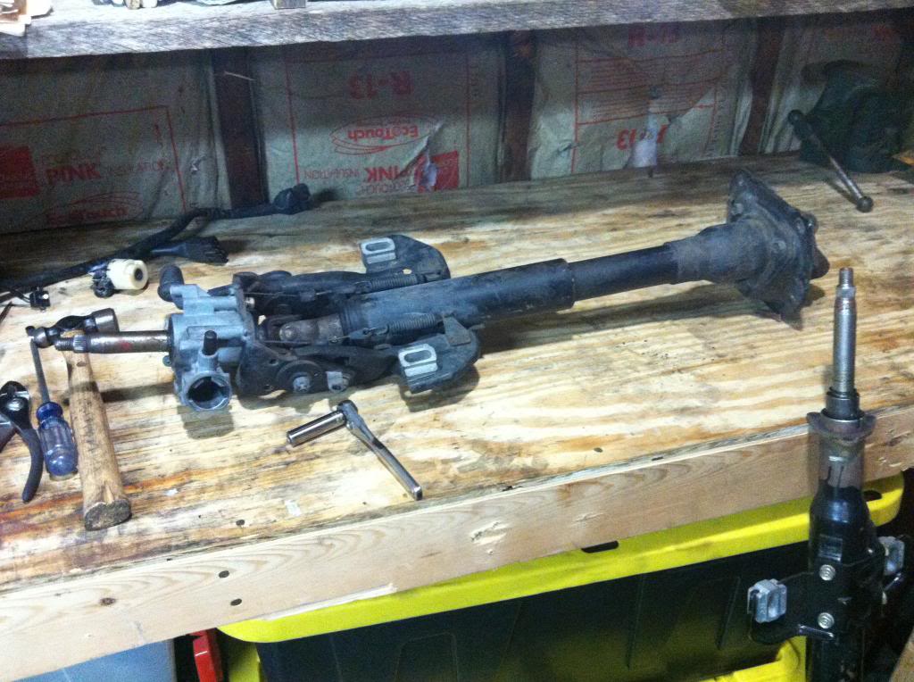

Trying to decide If this tilt column is worth rigging up. Came with no ignition or plastics. Cant swap my good ignition housings or even the cylinders. I would have to mount the ignition somewhere under the dash and hack up some plastics to fit. The ignition angles up from the bottom side of the column vs. straight out from the top side on a non-tilt.

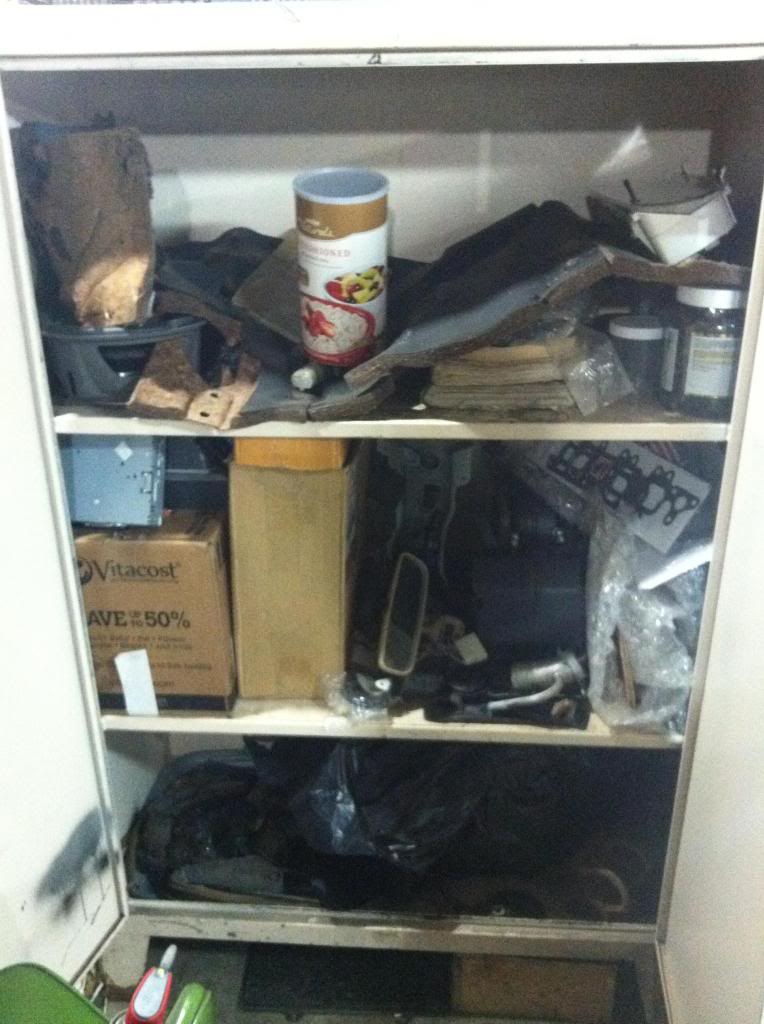

My cabinet of goodies. New used old and mint condition!
