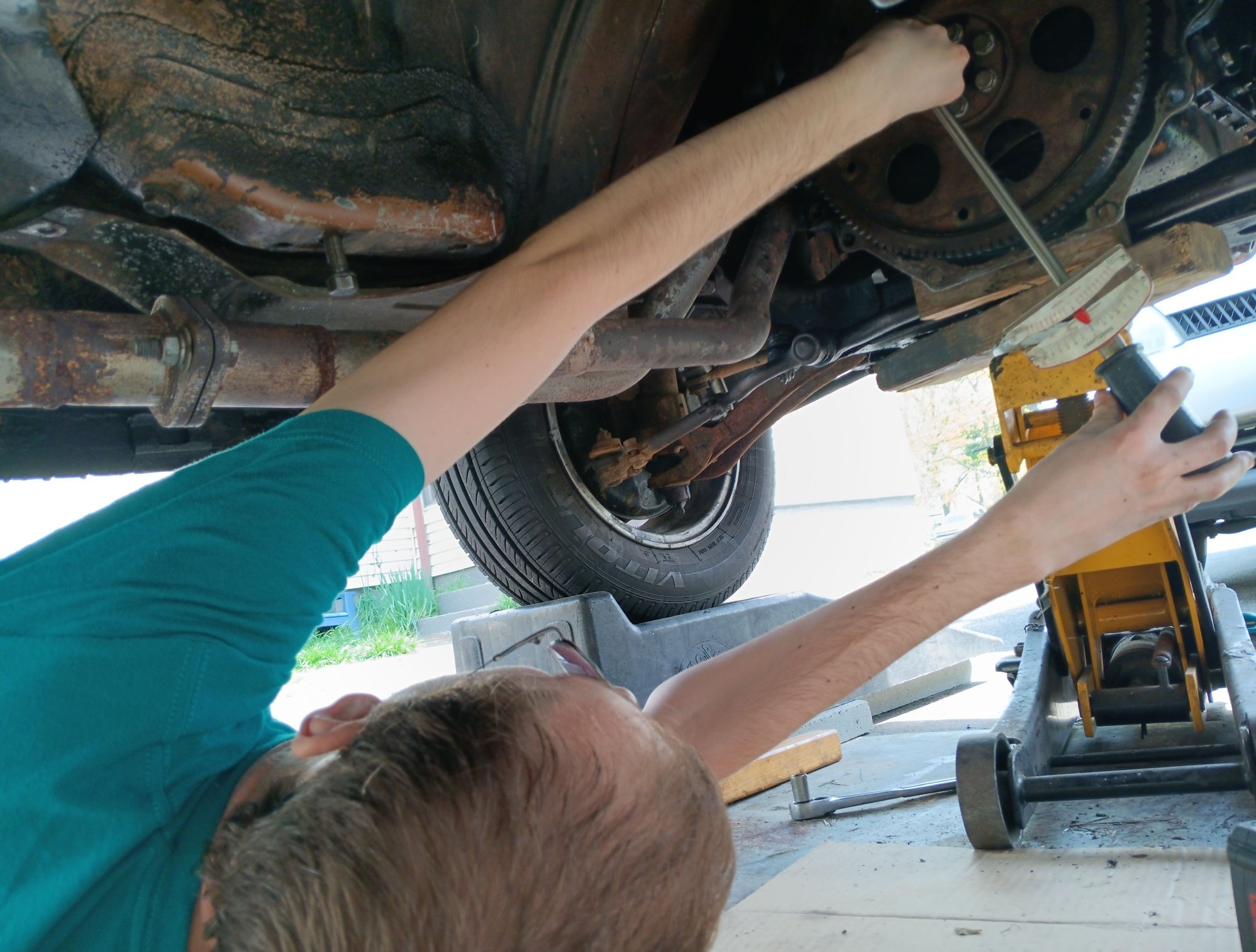

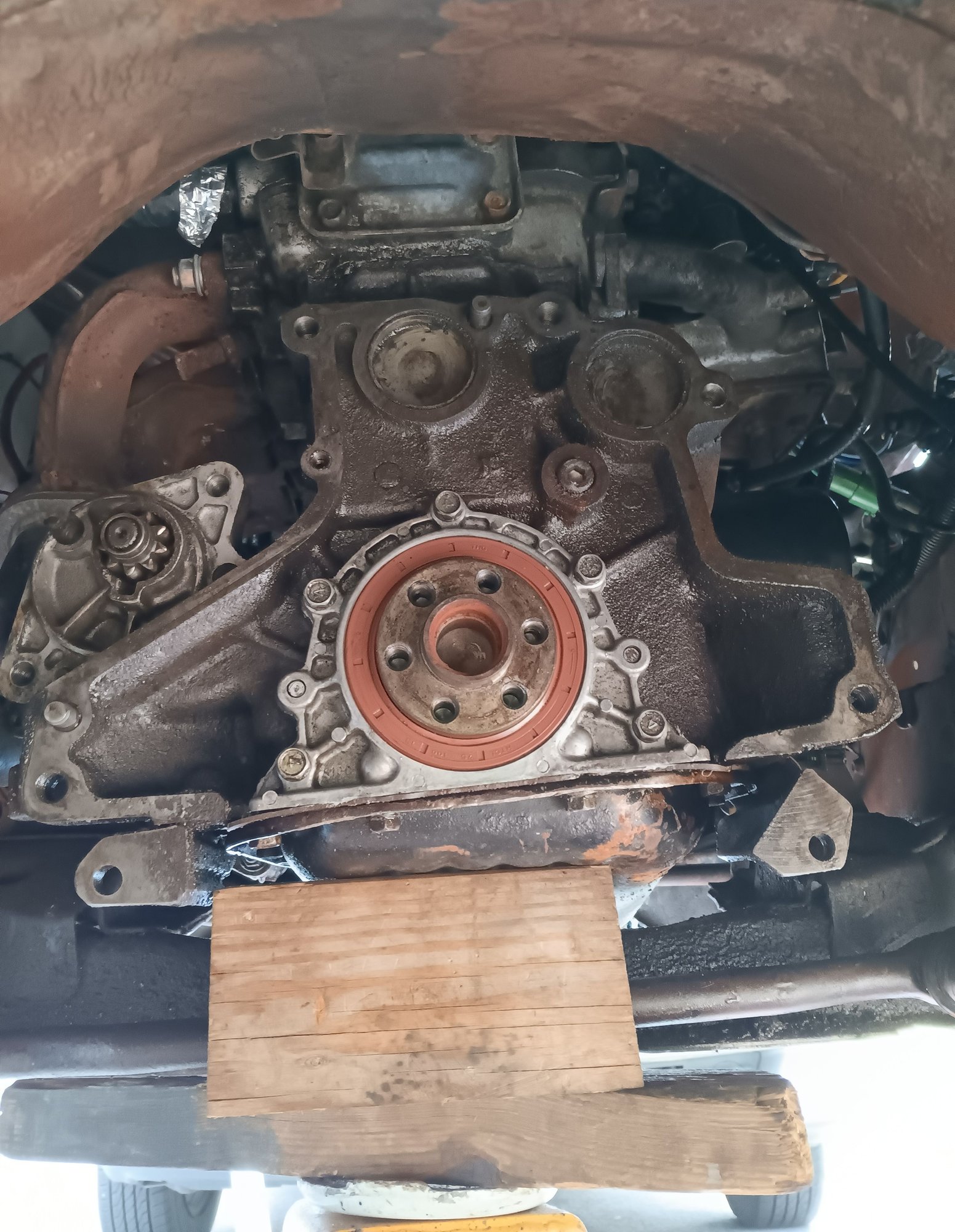

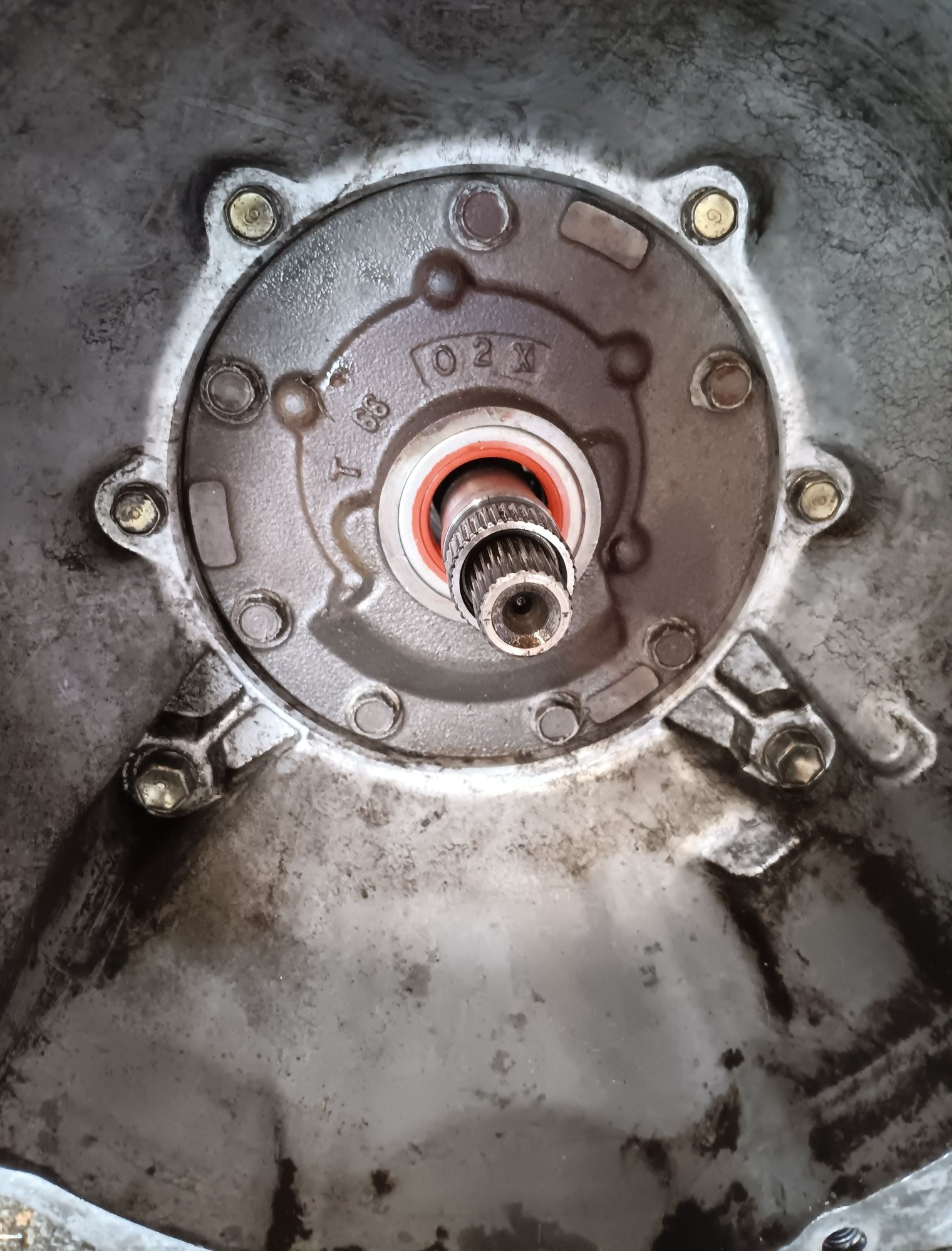

Today's progress.
new rear main seal, gasket and transmission output shaft seal. While we are there......
The rear main seal fell apart after taking it out. I guess it was time.

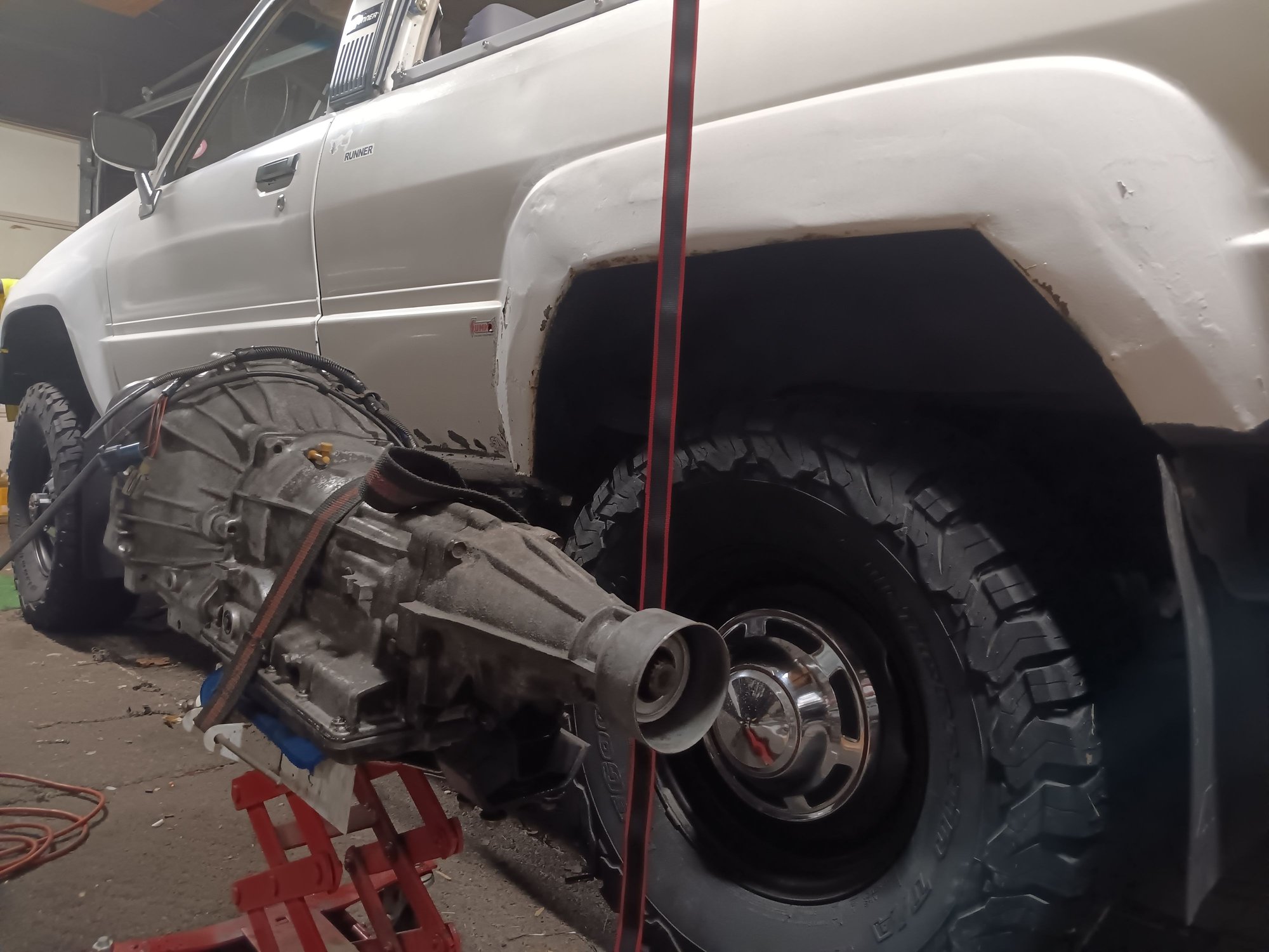

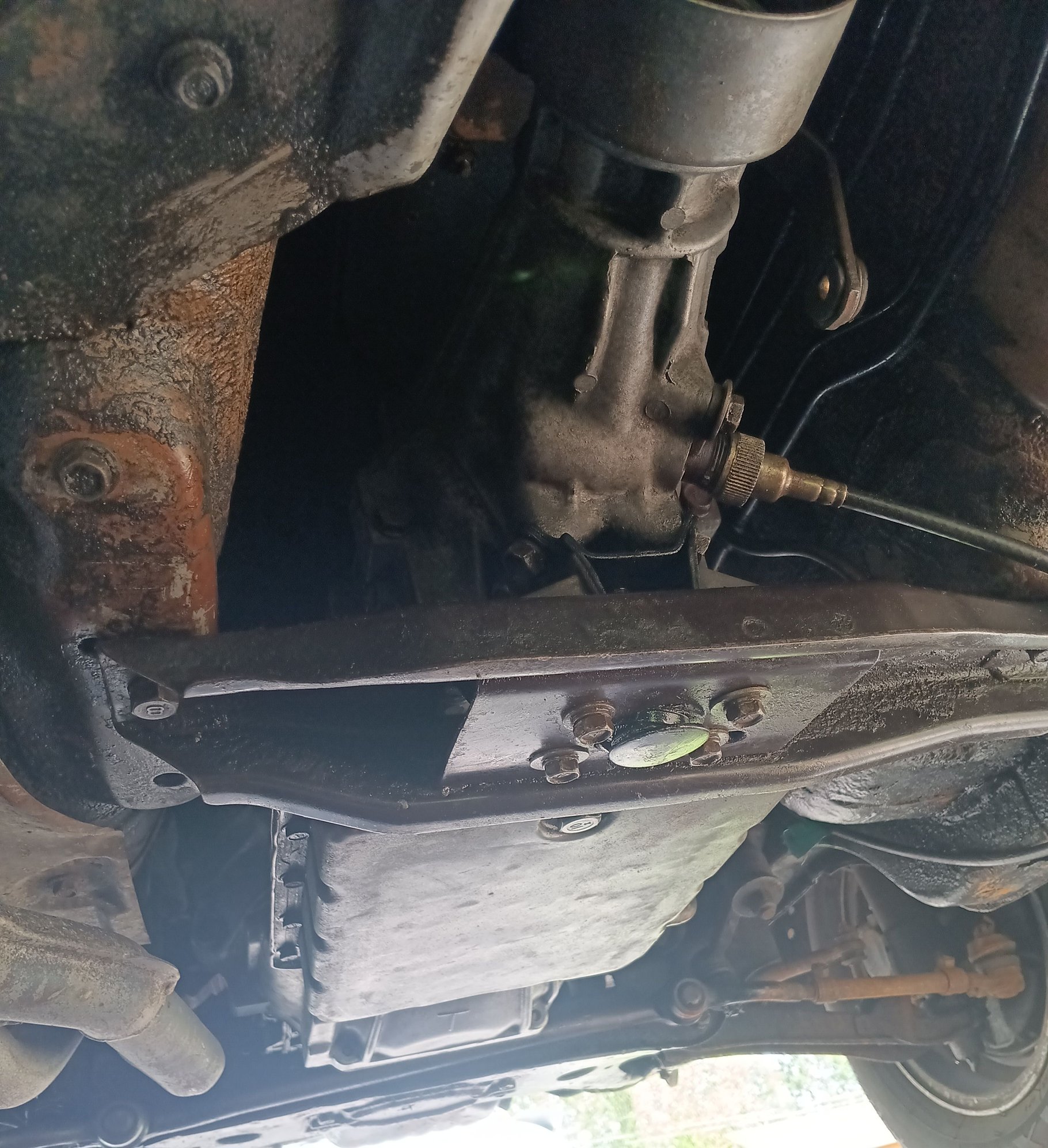

The Rolla s old and new ( used) transmission combined. I replaced the drive shaft bushing about a year ago so I swapped tail housings and put in a new seal there too. The bell housing looked a little different on the transmission I got from the junkyard and it had a different bolt pattern on the torque converter so that's swapped also. Plus the oil pan from the previous transmission is on the new one. According to both I D tags they are both 03- 55 toyota transmissions. Hopefully it all works out. Oh and its keeping good company with Black Beard.

initial testing seems good. It shifts now.

We had a few issues though. I broke the nut off that holds the lever for shift linkage to the transmission so I welded it. I'm gonna weld new threads later so we can unbolt it because the reverse light switch is no good on this one and that will need come off.
This transmission had a smaller speedometer drive gear so I thought it would spin the cable faster than the last one. 60 is actually 53.
Other than that though it is really nice to just jump in and go faster than 30 before having to warm it up for a few minutes!
Edit 5 /20/25
we fixed speedometer. somehow swapping to the drive gear from the other transmission even though it's bigger fit and meshed right in. I think the length of the gear puts it on a different spot on the governer gear setting the gear lash.

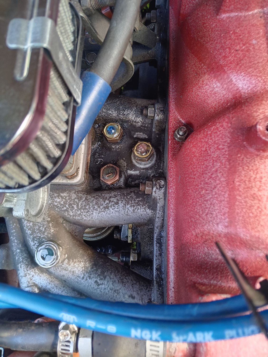

We added some bling to the engine 🤣 since swapping the carburetor I have been going through vacuum caps like crazy for the old vacuum switches. Things made today are such junk. Rather than replace them with something else.I made them into new vacuum port block pieces by cutting them and adding a little bit of epoxy and some fake diamonds. I didn't realize till I took out two that they weren't actually open to the intake.They're vacuum switches that worked on the temperature. And of course, like true, past owner stuff.One of them had threads that were all boogered up.So I had to clean the threads on both the intake and the vacuum switch.
