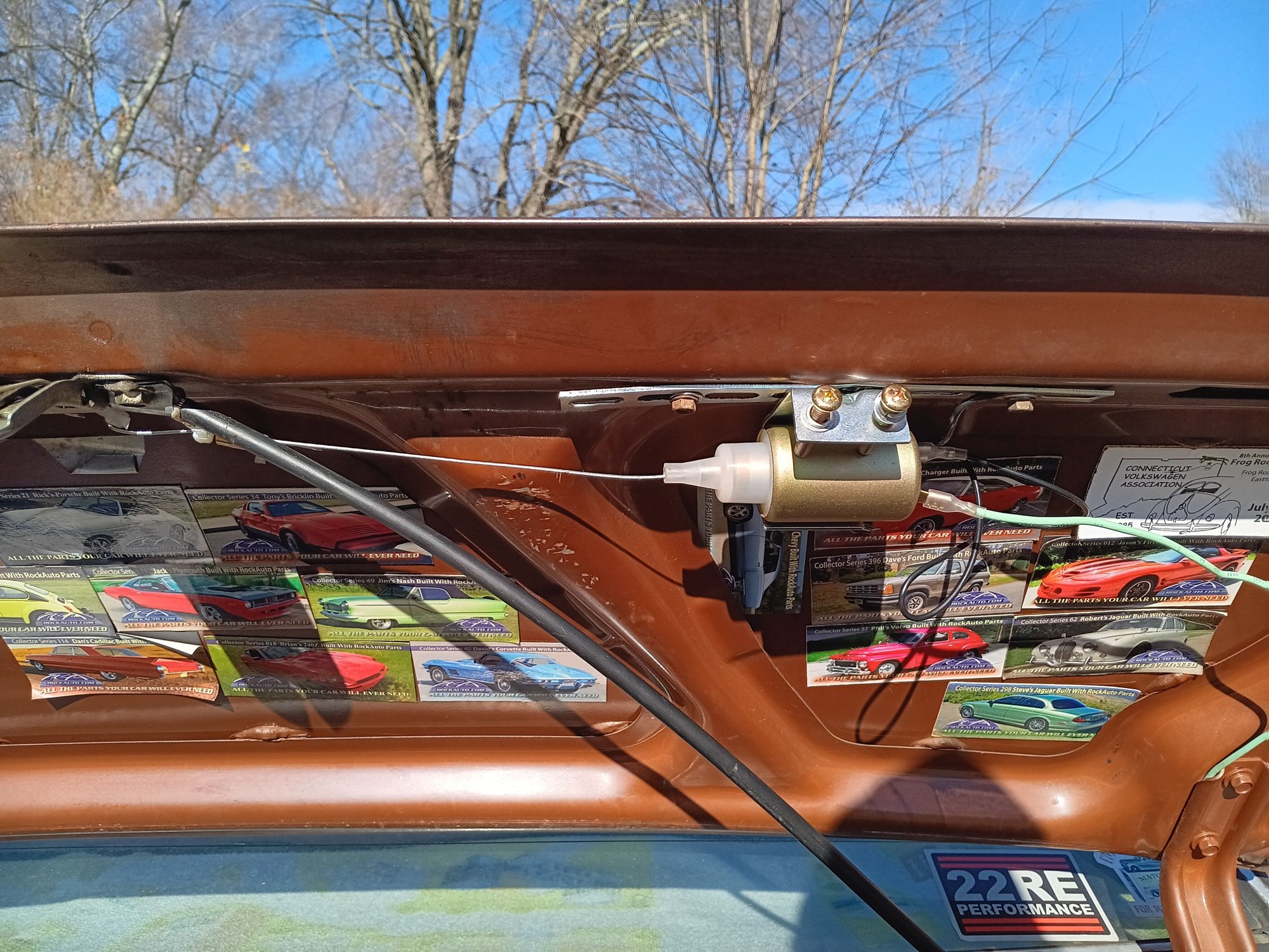

Custom trunk release 🤣 The key stopped working on the cylinder and the replacement lock cylinder was junk right from the start and didn't fit so I added this to the cable release that I made for it. It's cheap China junk ( that's why the cable i add is still in) but a cool addition . Oh and no directions. Good times.

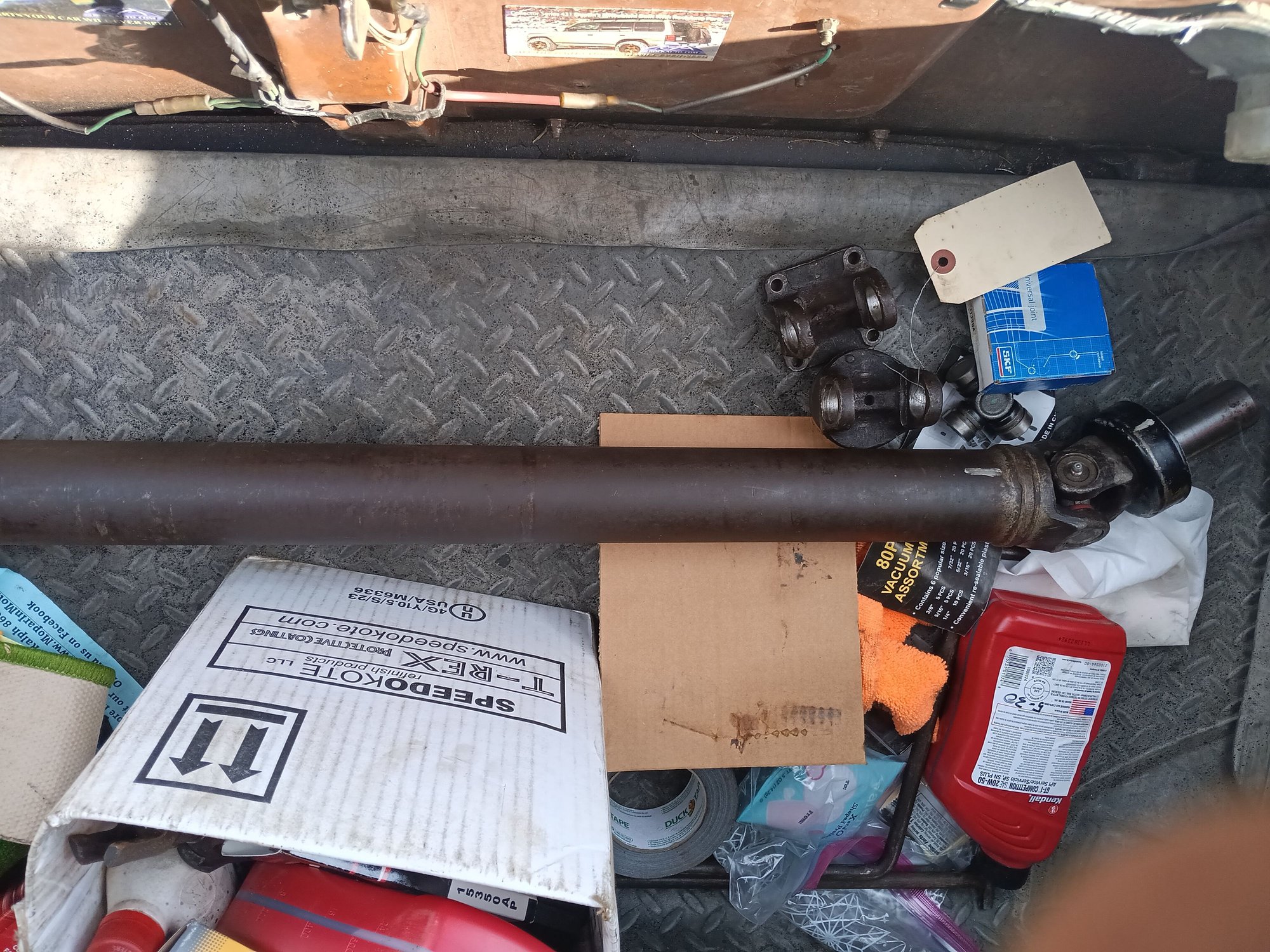

So this is the current situation for the Brown Hornet
The good: I may have finally found the driveline vibration. Hopefully fingers crossed. I took the wheels off broke the bead on each and vacuumed the Dyna beads out that I put in. (They worked great on the Echo even up to 80) Took the wheels to get balanced. I always figured one or more wheels may have been bent. The shop said only one so that's good just put it in the back see how it goes. I had a bad feeling when I noticed even that wheel didn't need a lot of weight to b[size=12pt]alance though. I put The wheels back on and it still has the shakes. So [/size][size=12pt]I decided see what it looks like up on jack stands when the drive shaft is spinning. It looked like the drive shaft was bent but turns out that the u joint I just put on is sliding around. [/size]
[size=12pt]The bad: I took the drive shaft to the drive line shop that I had rebuild the rear diff. They found a new end for the yoke to fix the sliding around part but the new u joint they got also moves around in it. Don't know what's going on there. So maybe for some reason it needs an OEM u joint. Looking online, it looks like there's 2 different sizes or model numbers .So I went by the model number for the car ( TE 31) .I'm gonna give a new one a try see if that fits. [/size]
[size=12pt]The ugly: the only other option I can see if that doesn't work is looking for used drive shaft.[/size]
spotted at the drive line shop.

we found a drive shaft for it in NH . I'm waiting on 1 more OEM u joint that I found on e bay to arrive and am going to bring it all to the driveline shop to see if we need to combine both the original and the drive shaft we just picked up then balance.

So just to see how the replacement drive shaft is I decided to try it as is. Just the drive shaft alone fixed the vibrationwhen driving. Even though the original rear u joint is a little stiff and will be replaced soon. But I noticed right away it was better.

We took the Brown Hornet to the drive line shop to pick up the old drive shaft. I told him don't waste any time on the old drive shaft. Its spare parts now.
