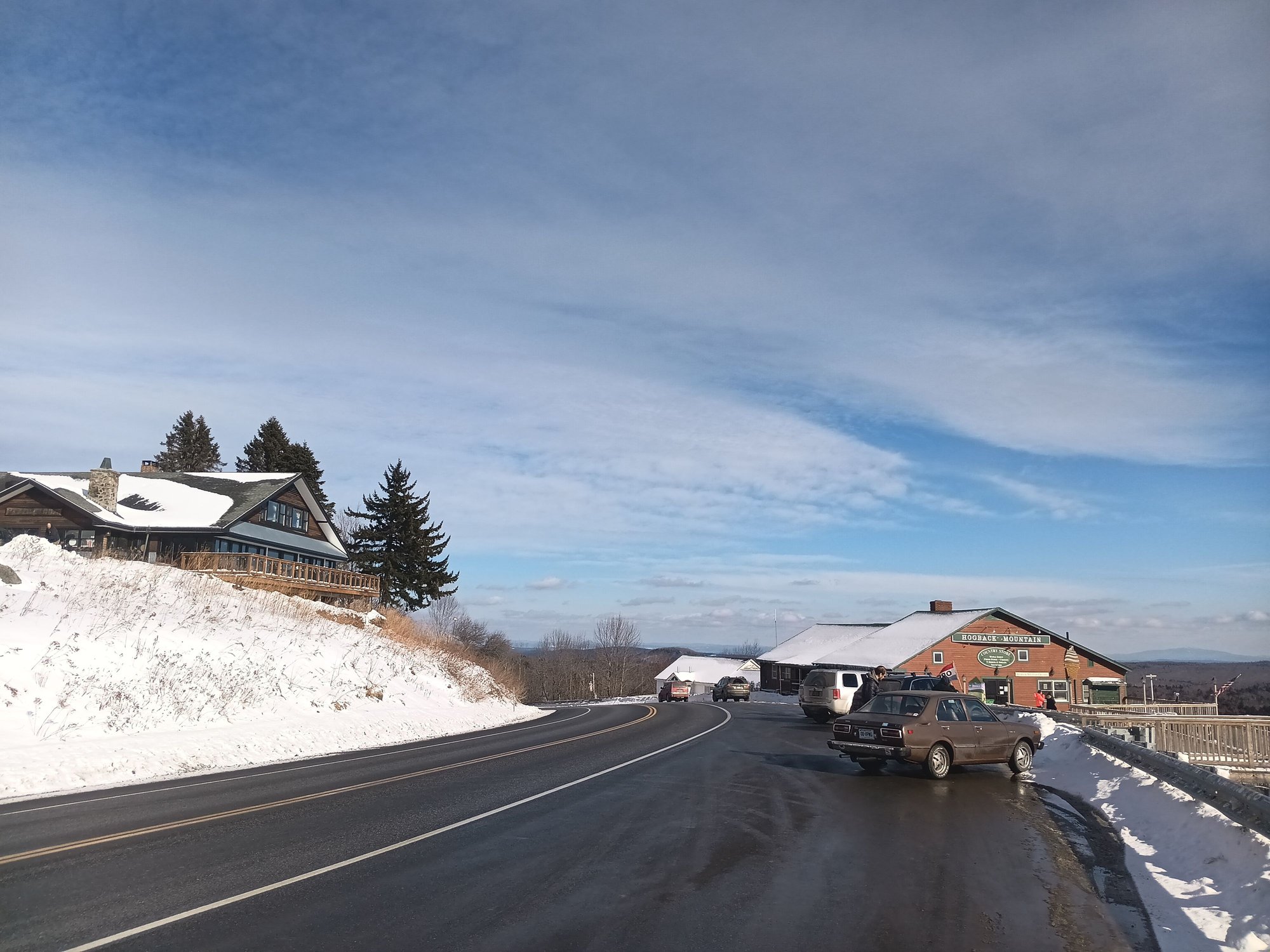

A cool photo from the dash cam while parked at Hogback Mountain.

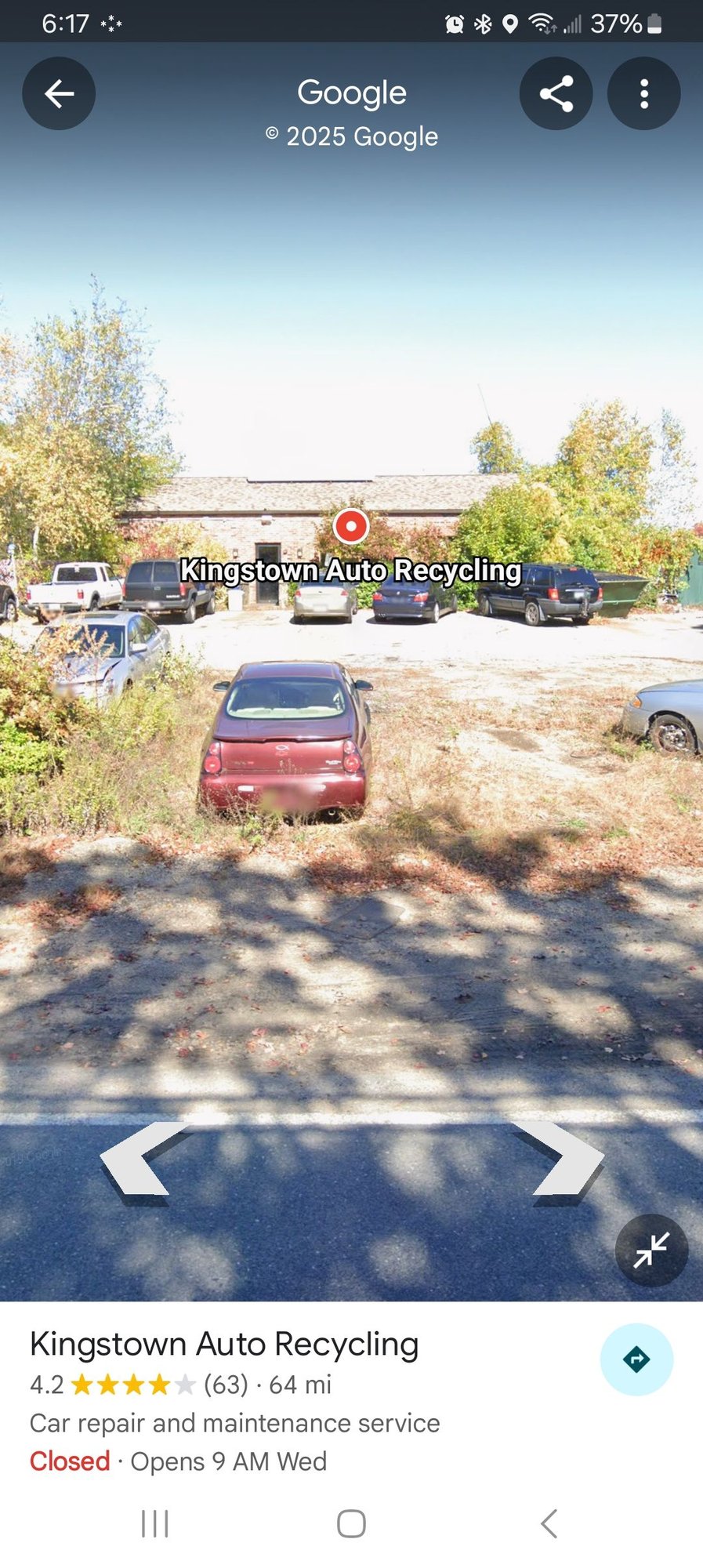

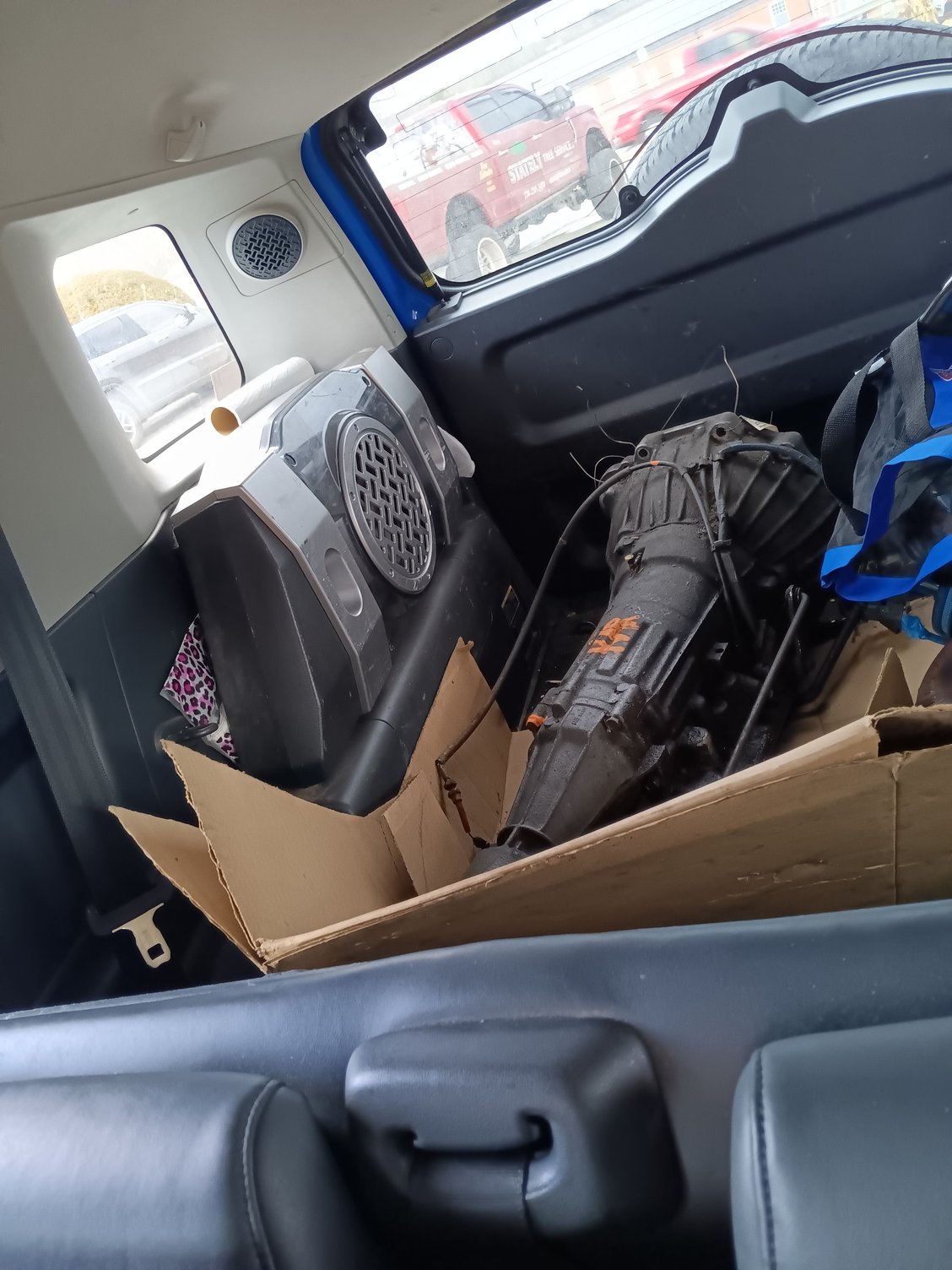

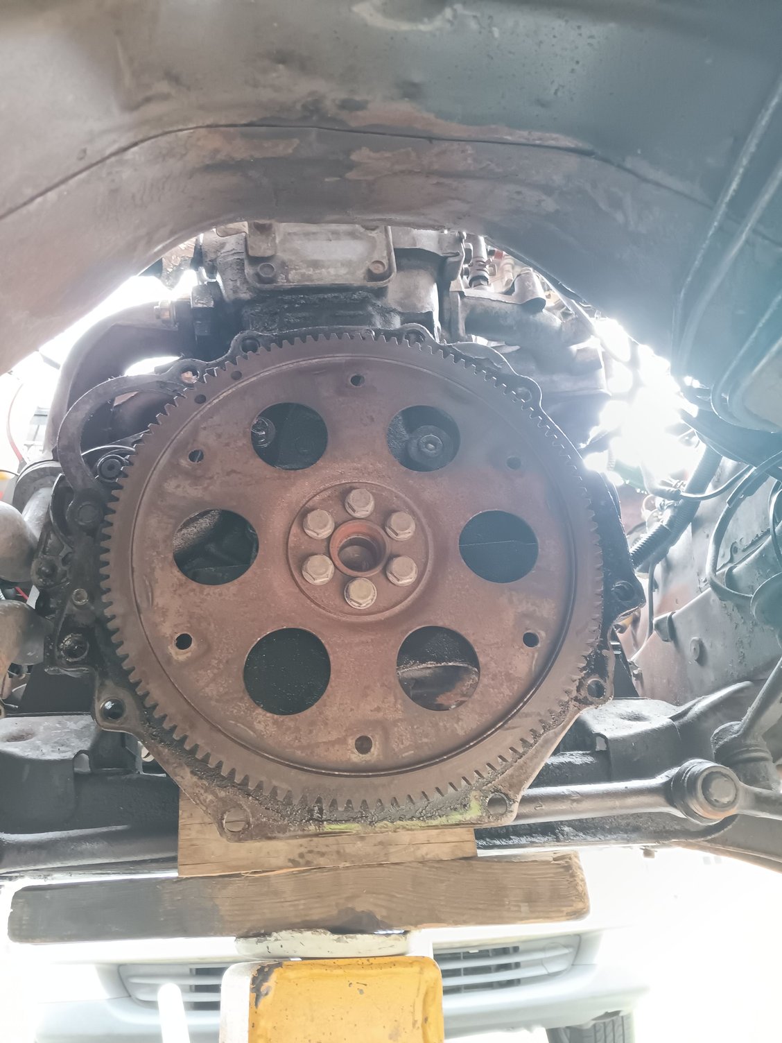

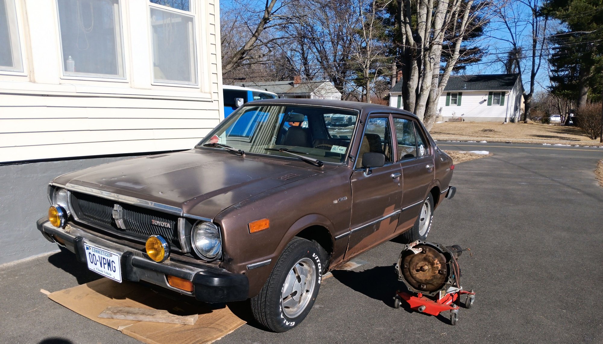

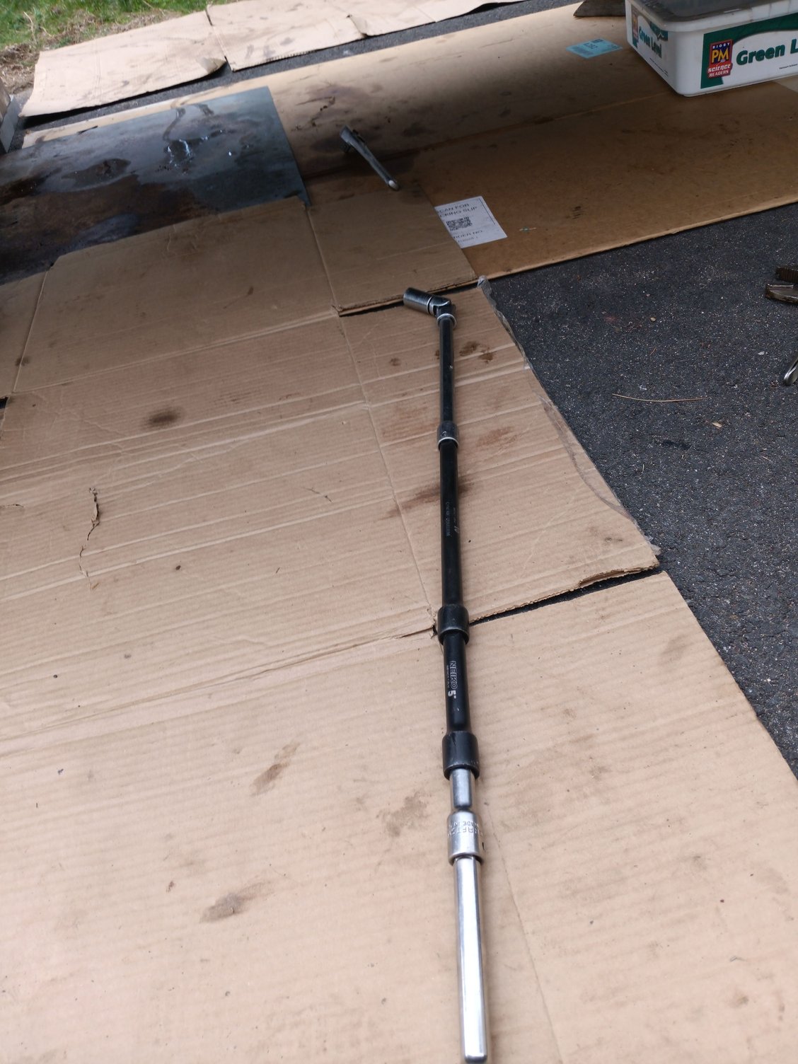

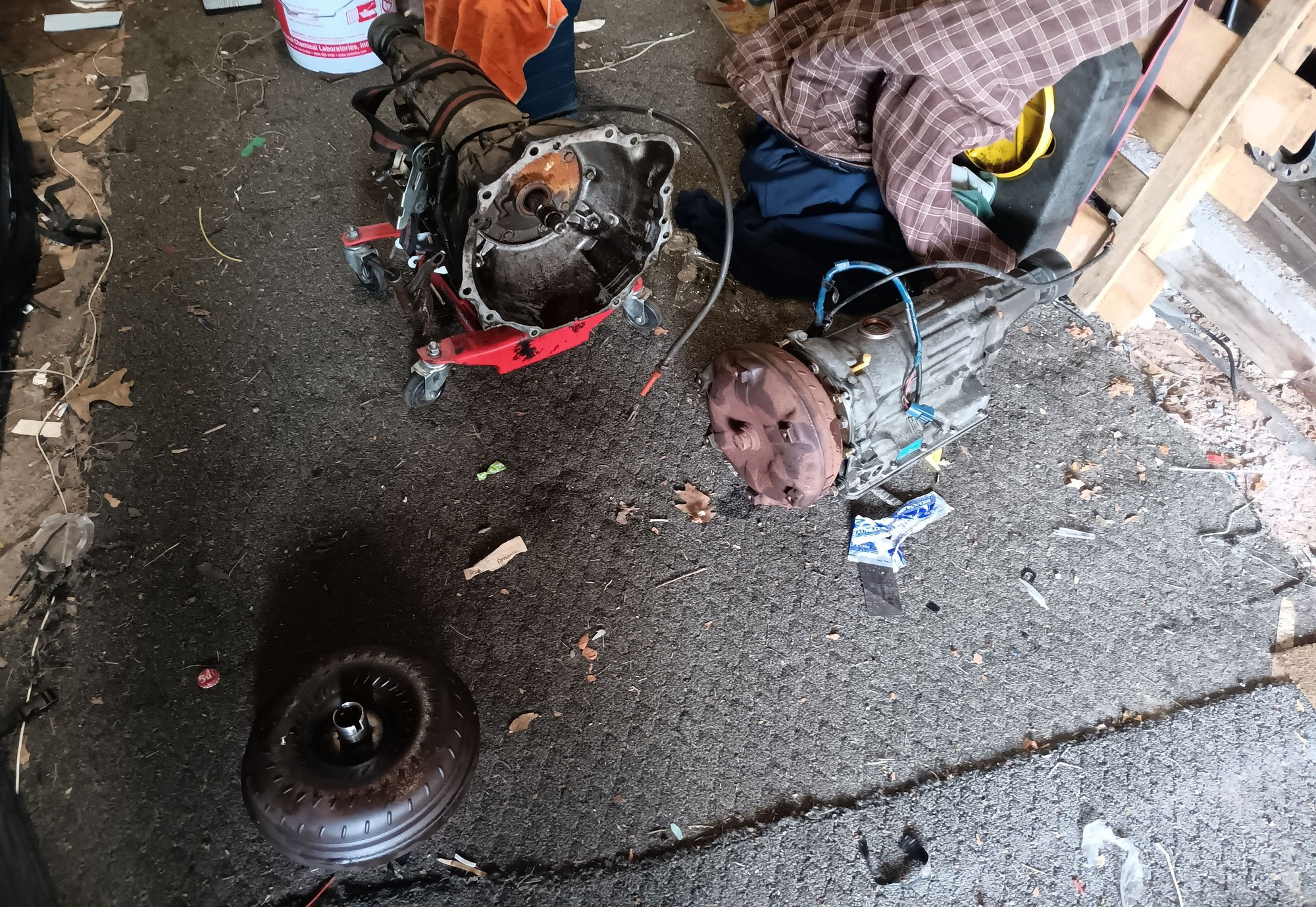

I took a little trip out to North Kingstown RI to visit another recycling center 😉 I did an internet search and found that they had an automatic transmission for a good price and thought of giving it a try. The current set up you have to warm up the car real good before it shifts out of first and it usually takes about a mile of driving at 30 to get it to go. Other than that it's fine once the initial shift happens. I am half tempted to try switching the valve body from the recent purchased transmission but I would like to replace the rear main seal also. I figured if it doesn't work out we'll at least have the other transmission out for a possible rebuild. Now that I finally have the proper speed O drive I found one that would have worked on a e bay just before getting this transmission.

For some reason I wasn't able to upload these photos from my little outing in search of parts for the Brown Hornet.

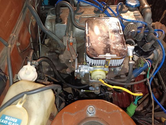

Well a year later and I finally straightened the throttle and kick down cables so they line up with the carburetor. Just drilled a new mounting hole for the bracket and welded an extension on. I was also able to finally free up the mounting nut for the kick down cable.

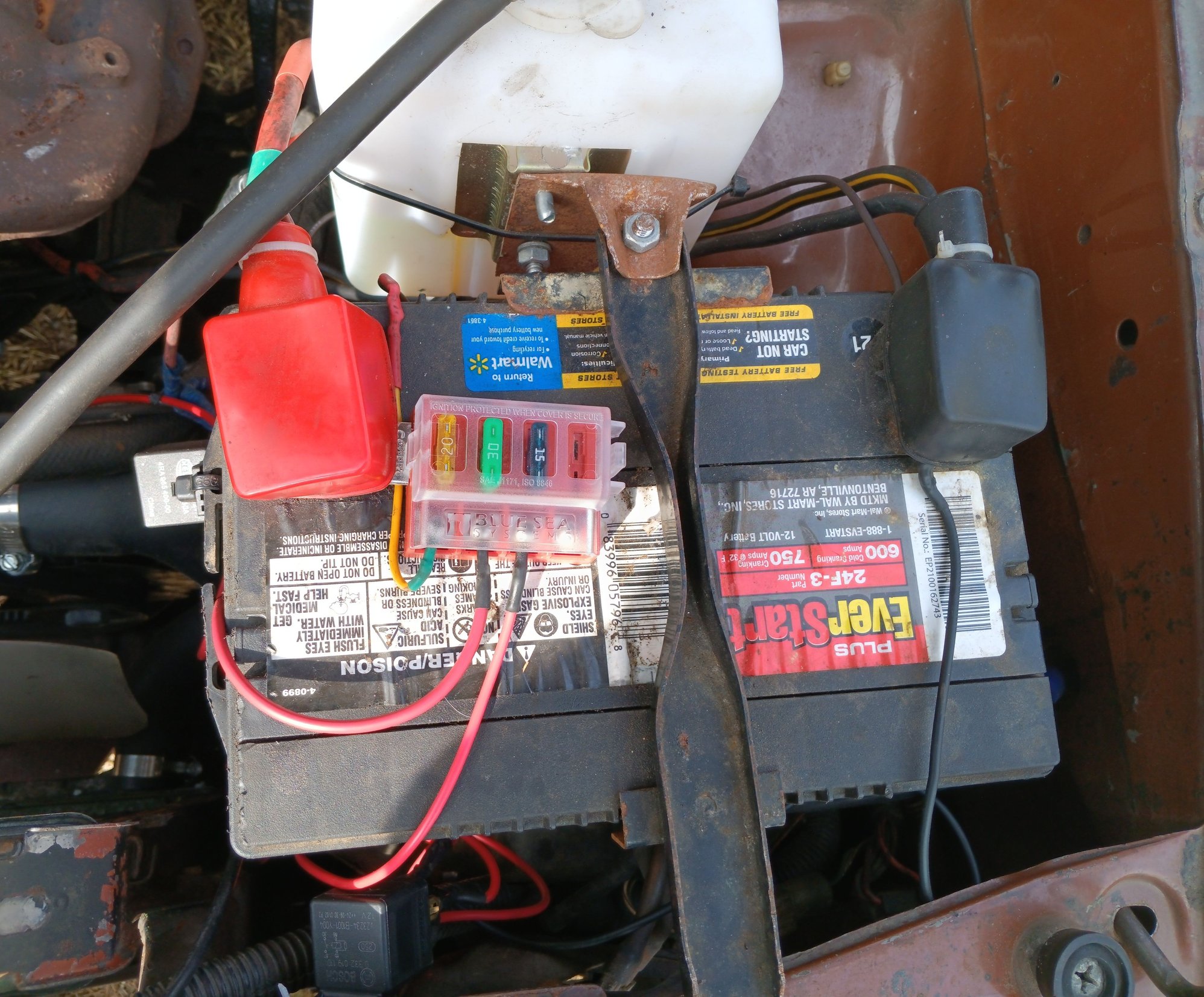

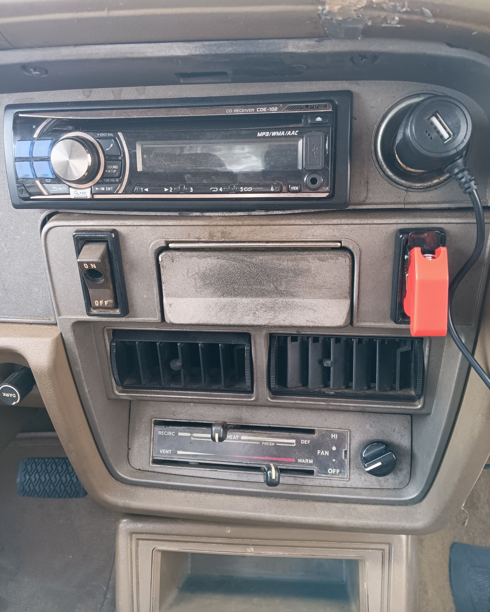

now I need to get going on doing this for the 4runner and finally adding that starter relay for it as well. I added a relay for the fog lights and this cool switch to the Rolla. I also added a fuse block tonthe positive side of the battery. It cleaned up some of the random fuses. I probably do the same forbthe 4runner.

I love old yellow halogen fog lights, I have a set of PIAA 520’s that I love. Your post reminds me I need to start looking at a fuse block of some sort, I have a bunch of fuses as well I need to clean up. Anyhoo the brown hornets always lookin good!!!

I just hope this used transmission is good. This is going to be a lot of work....

Wait, what’s wrong with the transmission?
