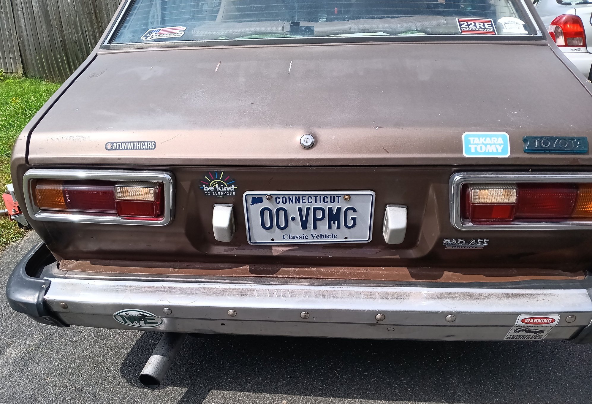

oh yeah I added a cable release for the trunk. The lock is having issues and the Taiwanese replacement locks are absolute garbage. We're planning on installing an electric solenoid soon.

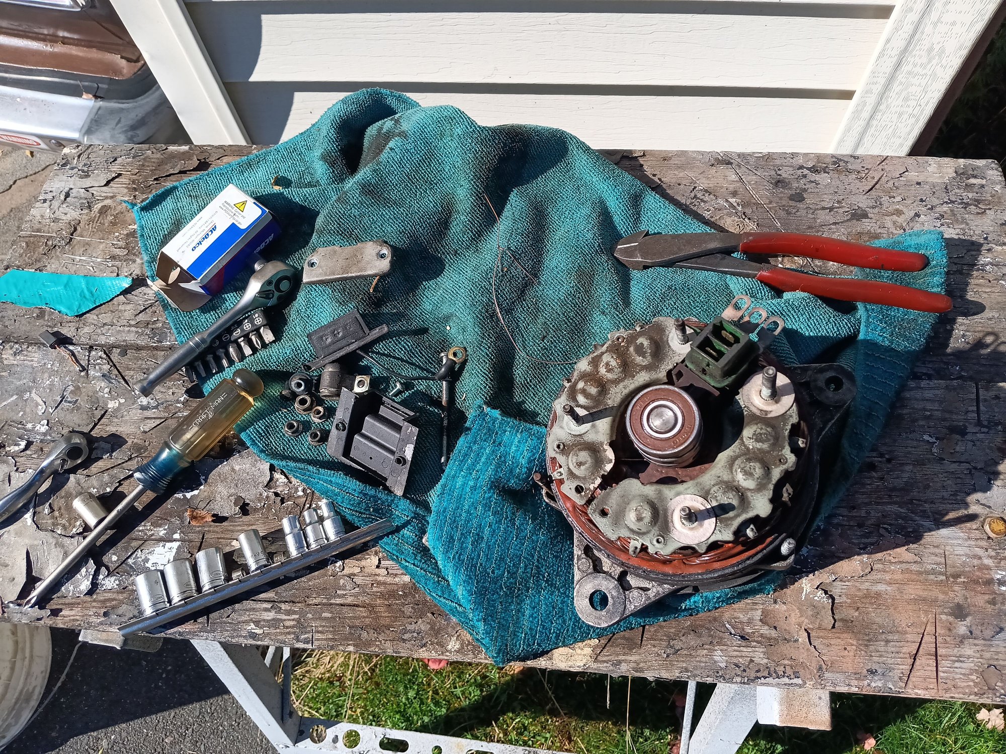

Been wanting to add new brushes to the alternator for awhile now. These were a little more work than I expected. First I had to desolder the old ones then feed the new leads through and solder the new brushes with springs behind them. Not as bad as it sounds though just old school stuff. Oh and what a bear getting this alternator out. Its physically big. Almost as much trouble as I had with the 4runner. Just had to remove the lower bracket to allow room for it to come out.
