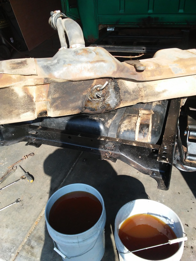

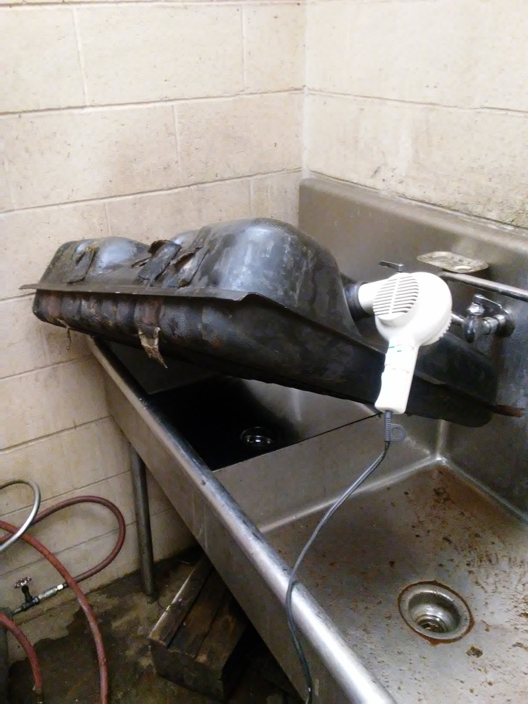

Not sure what is going on with Photobucket. I got several pictures I want to post but it is giving me problems. I will wait and see if it comes back up later on. I have gone 4-5 years without missing work and the other day was the first time I have missed in a long time as I got the flu bug. That was some bad stuff. I was inbed for 3 days. I never get sick. Yesterday was the first time out of the house so it was nice to get up and get something done. Wife and one of the kids had a dose of it too. Hope it is out of here.
A while back I pulled the rear tank and it was full of crud. I soaked it in white vinegar and got it cleaned up nice. I flushed it with water and in the sink you can see some of the crud that come out of it. It was just a fraction of what was in it. I then dried the tank with a hair dryer and then vacuumed the rest of the dust out of the tank. It is the first part to go back on the truck. Yesterday I pulled the Auxillary tank and drained 12 gallons of gas out of it. The gas looked nasty but when I looked into the tank, it was clean. I am just going to clean it out with soap and water and then clean and paint the frame in that area.

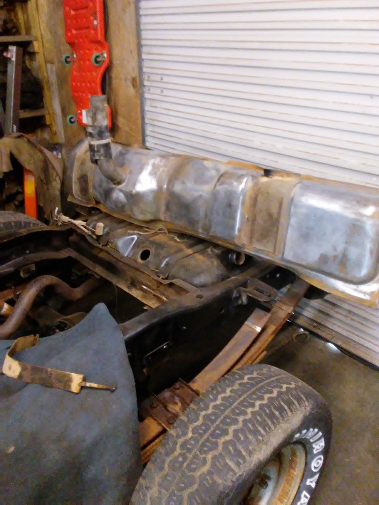

For as bad as the gas was in this tank. The tank is clean. I caught a break on that.

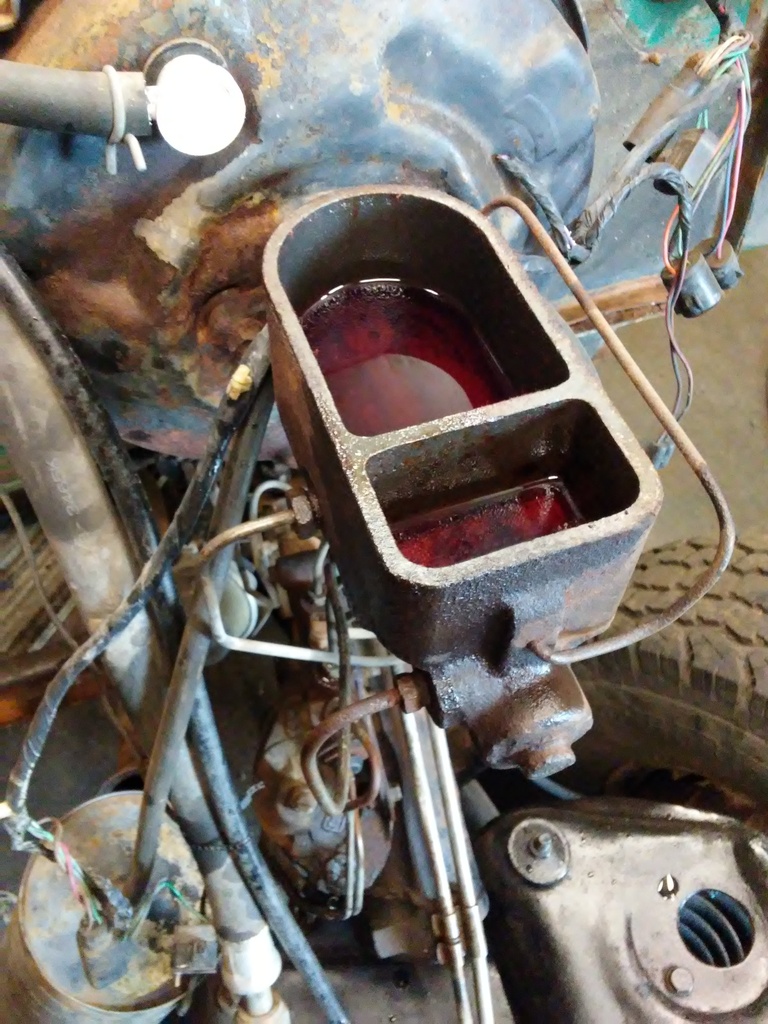

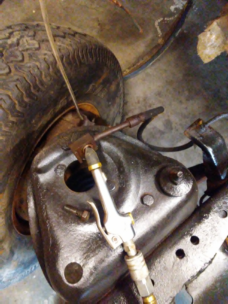

I started flushing the brake lines from the Maser Cylinder to the front pads. Drivers side is cleared but passenger side is clogged. The rear brakes I am letting soak to break the nut off of the line that connects to the Slave Cylinder.
I will replace all of the brake system and it will probably be one of the last systems I replace. I dont want the brake fluid just sitting in the system for over a year. I filled the Master Cylinder with Marvel Mystery Oil and start soaking the lines to clear any rust out of the lines.

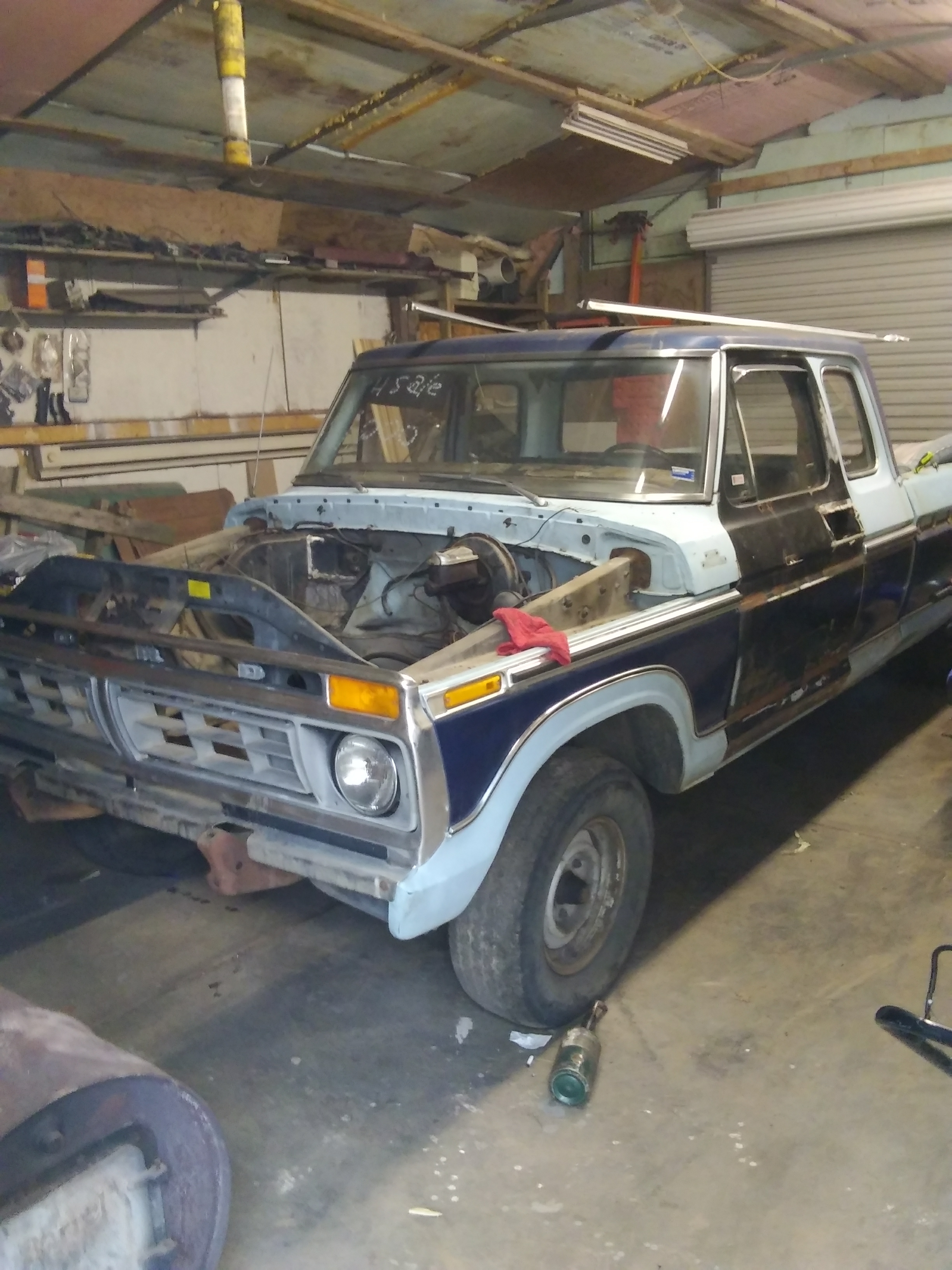

Rear tank installed and Auxillary tank nearly ready to be installed. Done a lot of cleaning on it. I clean all of the liquid systems as they get dirty. I am also working on the Fuel Lines.

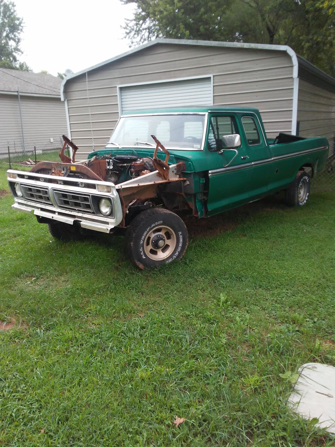

Justin wrecked the Ford. While using the 2 wheel to pull the Ford out, he did not turn the wheel far enough and it bumped the shop door. The Ford does not have any bakes on it at this time and when it started rolling he could not stop. Not really his fault. I am just using this to tease him. He did great helping to get the truck out of the shop.
Cab damage. Minor and will be an easy fix. It knocked the trim loose and a minor ding.

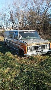

I bought this custom van for the drive train. Not sure if it has the 302 or 351 motor in it. It is a shame that I will be scrapping this van. It has a lot of work put into it. It was used for stereo competition but the owners removed all of the stereo for another show vehicle. It has a "C" notched frame, air ride tanks, custom paint, Cadillac tail lights built into the rear end and numerous other things. The owner traded for it for a 51 Ford Coupe and then it got some damage and sat. Some thieves stole the high dollar wheels off of it and did some further damage. It has some rust in the lower body as well. I am taking the drive train out of it and salvage what I can with it. Paid $300 for the van.

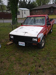

I got the two wheel drive legal and running. I am going to keep it for a back up truck. If I can find a Extra cab two wheel cab and frame I will use it for a parts truck to fix that instead. It really needs a new cab to make this truck right. I will use this for a parts runner.

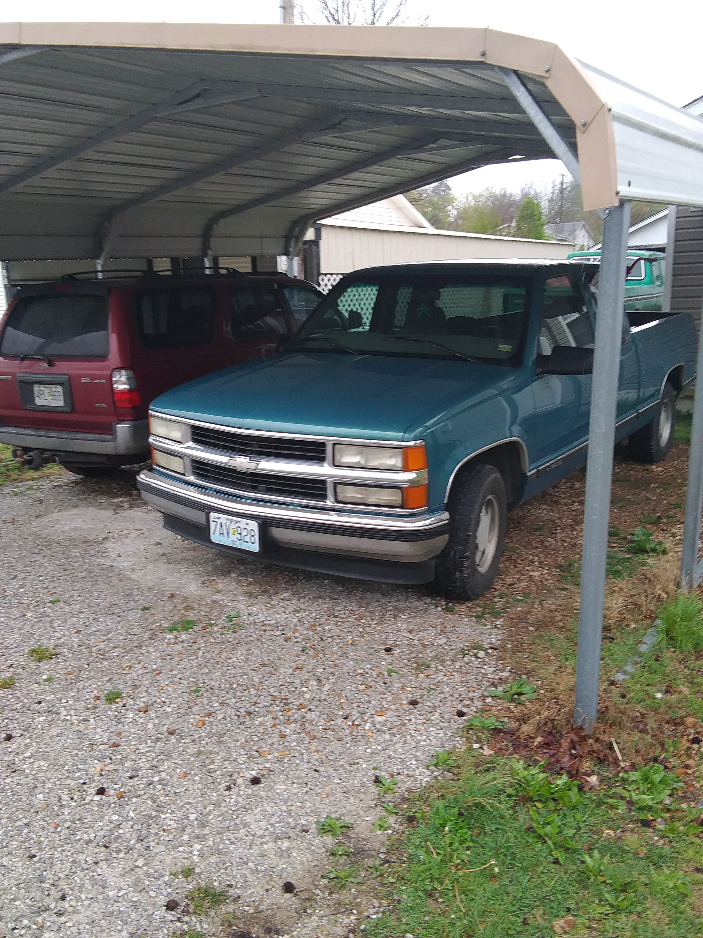

Misty wanted a full size truck. It is a '97 Silverado. It was a one owner truck. It was taken care of but mechanically it was neglected. I have it running great now but it still is not up to par. I got a complete tune up done on it. Plugs, wire, cap, rotor,air filter, and fuel filter. I still need to go thru the sensors and get them into shape. Whether it is a Toyota or Chevy, I learned long ago before even trying to trouble shoot a problem to start out with a good tune up and all hoses and wires in correct order. I worked on a couple of Toyota trucks lately and each one of them has been badly neglected.

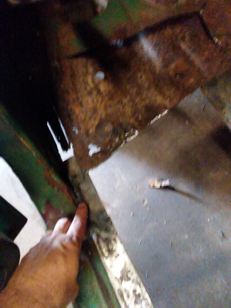

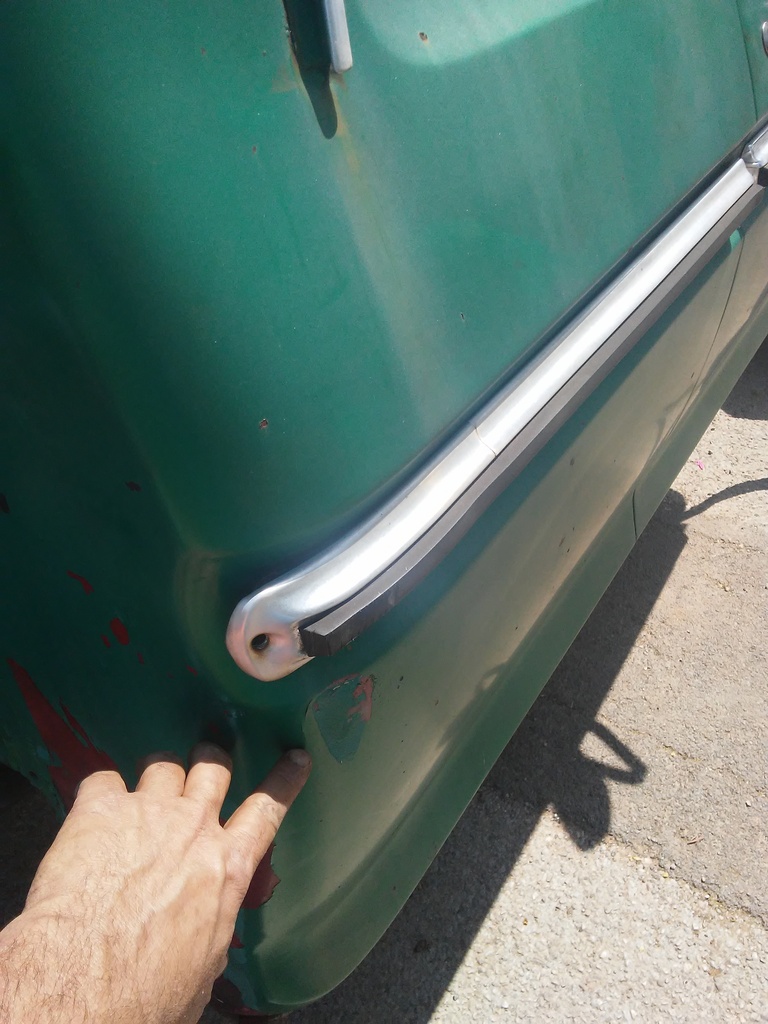

My green truck had been in an accident and the rear quarter of the cab had been replaced and not correctly. I found this truck. The owner originally wanted $1000 for it. I told him I was looking for a cab and he said if he could have the motor, tranny, seats, and hood he would sell this truck. I got it for $200. The cab is in far better shape then my green one. Typical rust in the cab corners and floor but still far better shape then mine. Also the trim alone which I am wanting to install on mine that the green truck does not have will save me a fortune in work an parts. I am going to combine the best of both trucks to make what I want. I want my truck to be Jade Green so I will be having to do a complete paint job on everything including the interior. Grrrr... I really wasnt wanting to do that. Oh well, It will be what I want when done and I will have this truck new from top to bottom.
