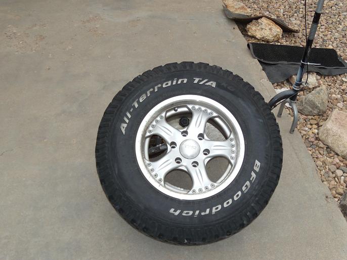

I just got a set of these on craigslist. I am getting ready to bolt them up...
Attached Thumbnails TRD IS wheels over manual hubs-0602-trd-rims-day-shot-center-cap-002.jpg

Originally Posted by Ron Helmuth
just to clarify- when you say manual hubs you are meaning aftermarket manual hubs not Toyota 5 speed manual transmission hubs right?
What in the hell are you saying? What is a Toyota 5speed manual transmission hub? I've never heard of one.

scuba-I am a manual transmission not an automatic. Never had a clue the front hubs were larger than the rears but see post #5. See original post for basis of my question.
Auto / Manual has nothing to do with anything in this case. You either have em or not. They are manual hubs. Not manual transmission hubs, there's no such thing. Now I see where he's going with the "they'll fit on the rear just fine, but the front is another issue". Which sounds correct. However, the add front "covers" are the same size as the manual hubs...
