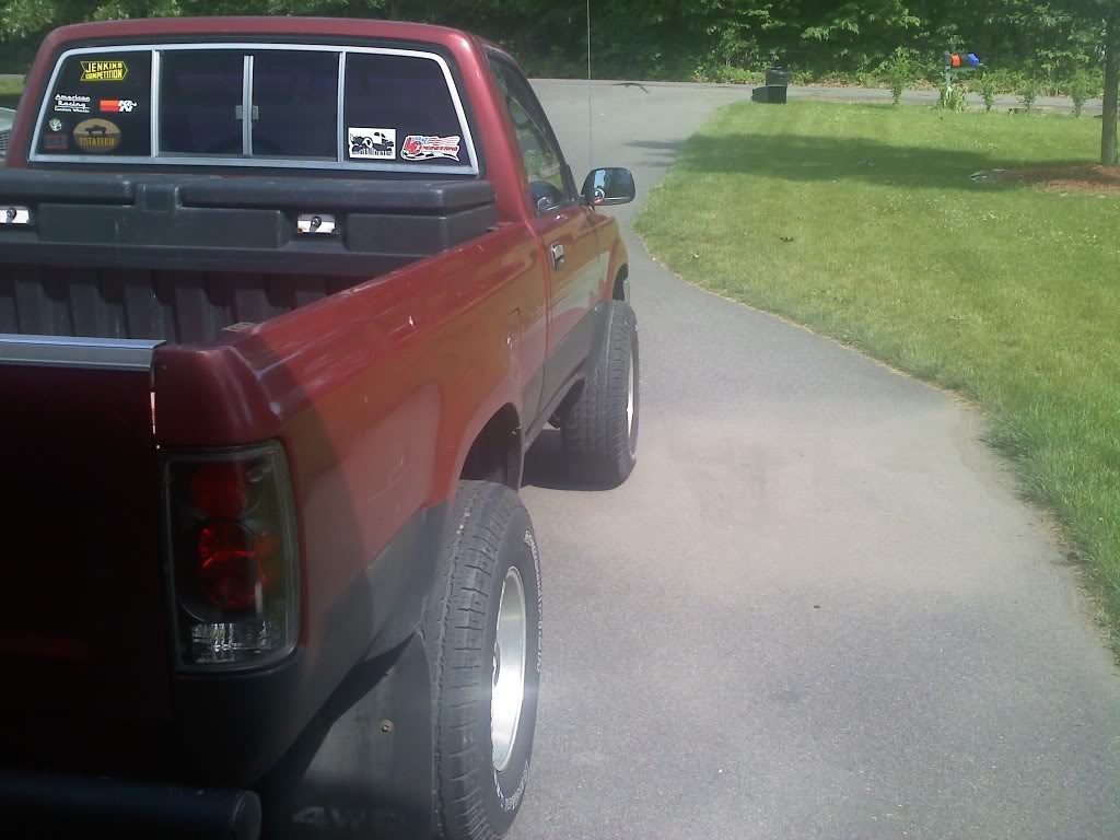

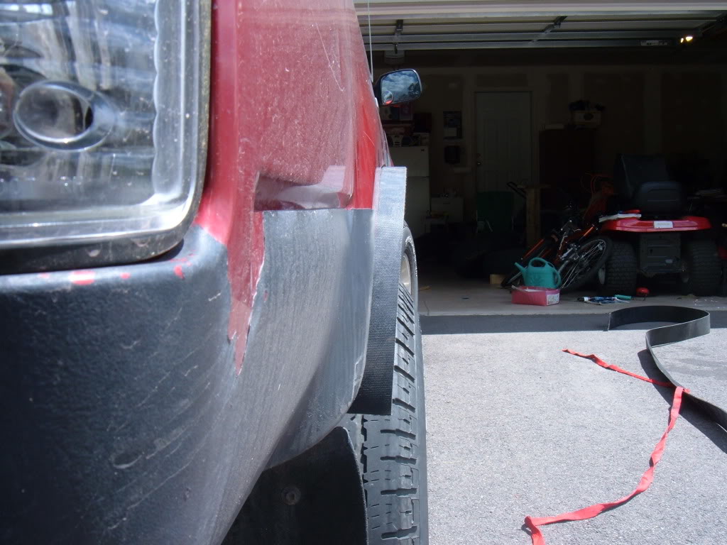

not the best pic....but....the wheels are the difference here.
stock 1992 p/u......no lift, no nothing.
the 31 / 10.5 / 15's are mounted on American Racing Type 8's......not sure if they are made anymore, but in comparing these same size tires on SR5 rims, these wheels force the tires well outside of the body rather than tucked under as the SR5 rims do.
beware though.......if your state restricts the amount your tires can extend from your body you may have to buy, or make (as i did) some fender flares to provide coverage.
