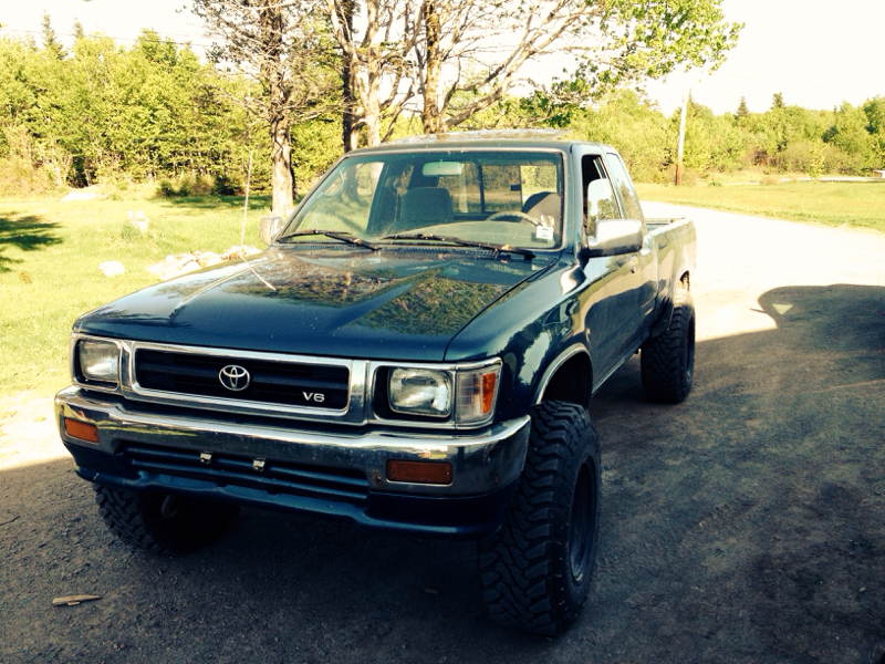

Hey, I have a 93 sr5. I've been looking a while
Now for putting a lift of some sort into it. Not interested in going straight axel, but also not 100 percent on what the best combo would be for front and back kits. Everything is bone stock now suspension wise, I'm looking to go 2-4 inches in lift and even 4 is a lot, I like the wide semi-low stance.
Any tips or pointers would be appreciated

Look up old man emu kits. There are lots of videos on YouTube . Paired with some bj spacers from 4crawler it looks and works good. I bought mine from rocky-road.com.

Your truck looks pretty good in that pic - what's your setup?
I went with OME on my truck - everything but the tbars pretty much, bj spacers, BFH clearancing, running 33x12.5 Toyos.
I dunno what stock height would be, but mines at 22.5" from center of axles to bottom of fender lip f/r - it's pretty low compared to the bracket lifted trucks I see driving around.
