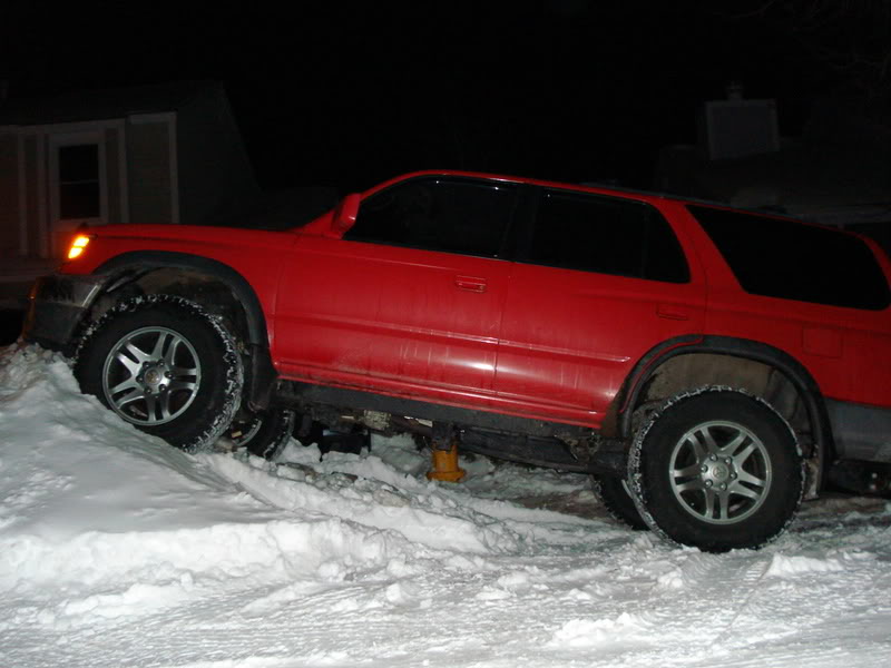

I also have Sequoia wheels with 265/70/17 Nitto TG's. When full lock, they 'touched' the front bumper valence but that eventually dissipated.
I could of trimmed a tiny bit of plastic but didn't feel it was necessary.
