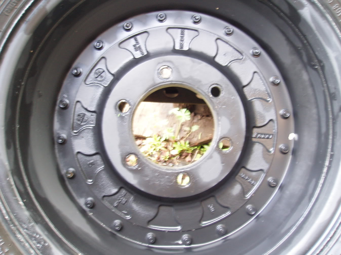

Yes, I do. I own some. But, you got one thing right, they can be spendy. They're called 2-piece, or 3-piece, aluminum racing wheels. Many different kinds are sold, by many different companies. Some have cast aluminum centers, some have forged aluminum centers. All are very strong, and VERY lightweight compared to one-piece aluminum wheels.
I used to have some one-piece cast aluminum alloy 15x10 AR-39s, and they were pretty damn heavy. Solid as hell though, super tough wheels.
I recently bought some different used 15x10 aluminum wheels to replace them after they got jacked. I found out after buying these that they were 2-piece racing wheels with cast aluminum centers. That's not all good though, even though they're SUPER LIGHT, and I scored them SUPER CHEAP. Let me explain. Though they are very strong structurally, they are very prone to damage because the bolted-on piece(actually pieces, a front and rear piece welded together after being bolted on to make one-piece)that makes up the rim of the wheel is made of a relatively light gauge spun aluminum. Which is thin to save weight(~1/8"), and being spun metal is very malleable/ductile. So it's VERY easily bent when struck by a foreign object. On the flipside, it's VERY easily bent back though too. Basically, they're meant for the track not the trail. They would DEFINITELY not be optimal for hardcore rock crawling, or any hardcore wheeling, except stricly in the sand/snow/mud.
When I bought these ENKEI 15x10s they looked llike crap. All scratched and bent up around the edges from being wheeled. A pair of pliers and a couple cans of spray paint later...good as new(ish).

Back. Sprayed with flat black.
