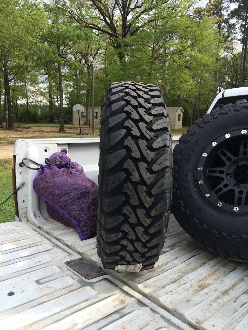

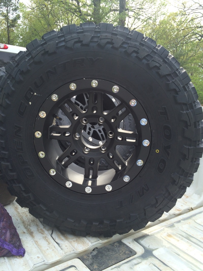

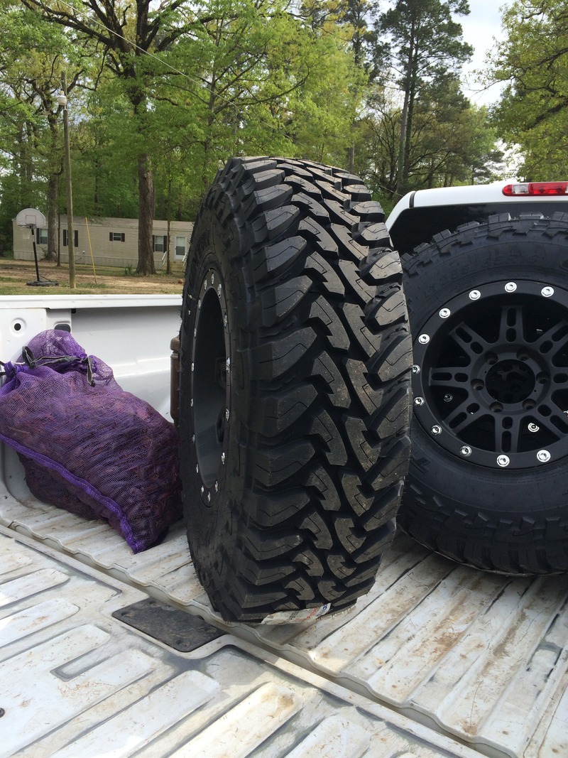

255/85R16 on 16x8 ProComp 7031
And just rolled up next to a 33x12.5 on a crew cab 3/4 ton dmax

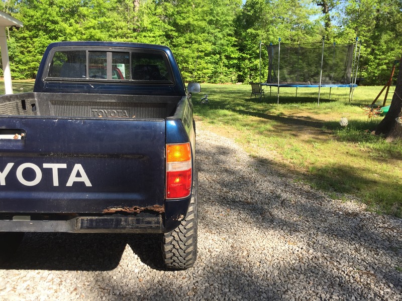

Still have to install the ball joint spacers and do an alignment.
Old Apr 12, 2015 | 03:40 PM
Regency's Avatar
Joined: Mar 2015
Posts: 167
From: Alexandria, LA
Spacers installed. Did not relax the torsion bars but cranked the passenger side to level up the truck. Needed 3/4" to level side to side up front. The rear is starting to settle in some so with adding a spare tire and some type of rear bumper i will need to add a shackle to level it back up.
