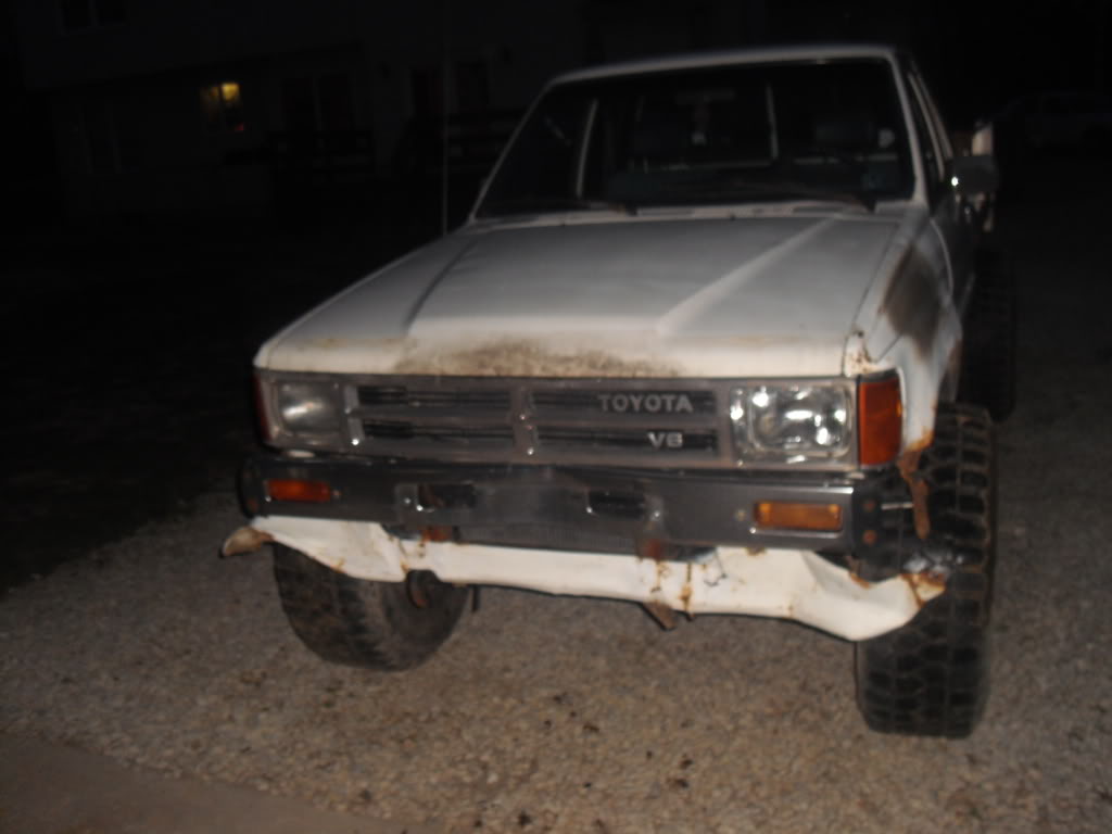

i have 35x12.5's on 15x8 rim. same width just alittle bit taller. work great, good for airing down.
heres a sideshot from when i first got the truck, again theyre 35x12.50's, but they are the same width as the 33's your looking at. they do stick out quite a bit. Youre gonna need fender flares, thats for sure.

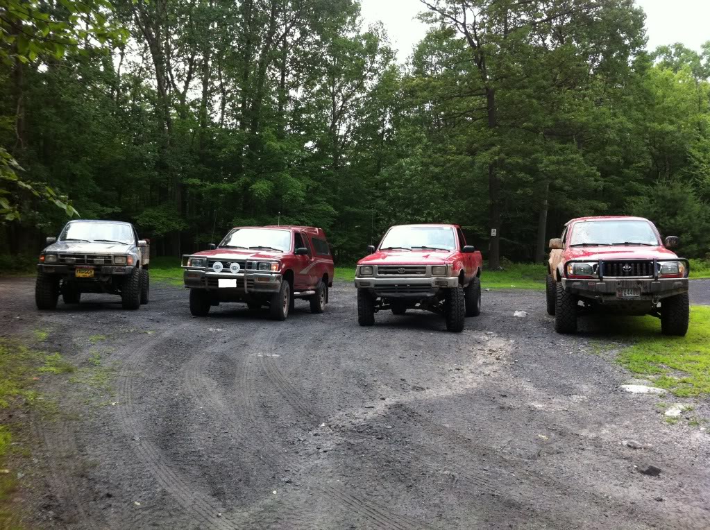

hmmm with the right backspacing 33 x 12.50 will fit without going too far outside of the fenderwells.
I'm the one on the left. The taco on the right also has 33 x 12.50's. THe one with the cap has original 235's and the other one has 33 x 10.50's.
awsome line up of trucks xtreme
Thanks, but they aren't all mine. And i didn't take the photo.
Stolen from the trail report thread. https://www.yotatech.com/forums/f100...-creek-237311/
