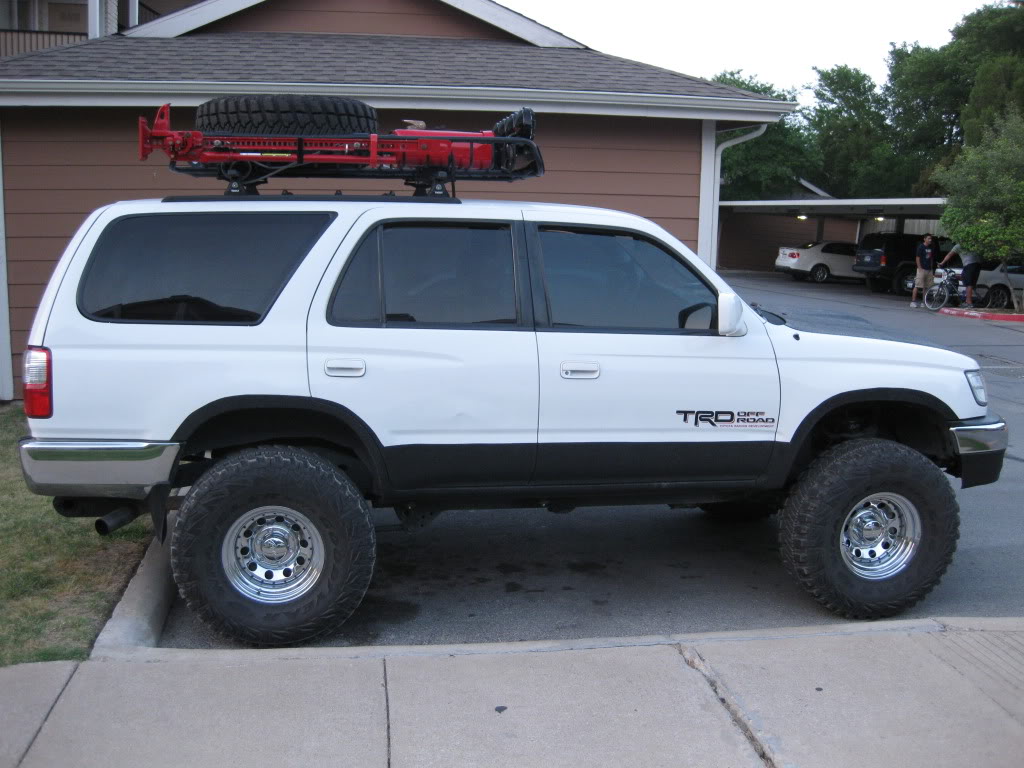

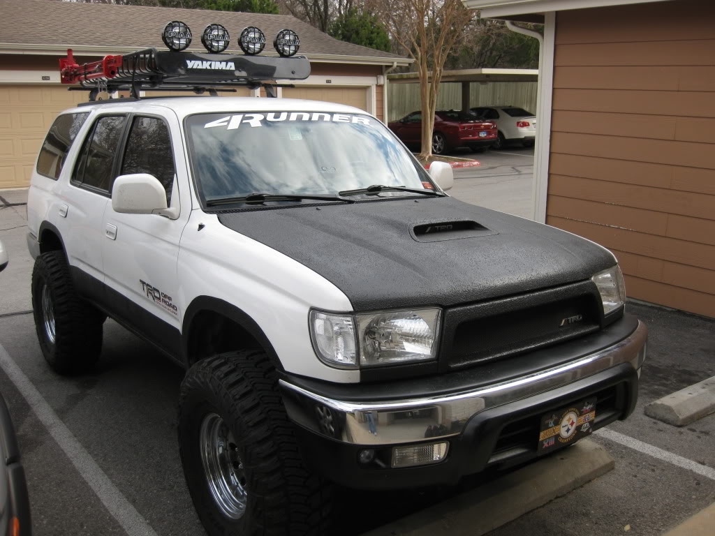

I am running that exact setup. 33X12.5 MTR's on 15X8 steelies. I have aired them down a couple times without any issues whatsoever.

Yes, that is a nice setup, a real "sleeper". Looks almost stock, but just air down the tires, pull the mud flaps and it is ready for most any hard core trail.

Sick looking 4runner. Looks real good!

I LOVE the MTR's! I have used them in snow a couple of times, but since I go to school in Texas, we don't see much of it here... The times that I have used them in the snow was in New Mexico and it wasn't very deep, maybe 6-12". I aired the tires down a little and they performed just fine. I have also used them to climb snow/slush/ice covered mountain passes to go snowboarding and I haven't had any issues with losing traction. They have pretty much gotten me through just about everything that I have thrown at them and I would highly recommend them.

thanks for the response im excited to get some fresh rubber on my truck,by the way that is the best looking 4runner ive ever seen imo,usually not a big fan and i like the hood too

Thanks man! It is a work in progress but it is nice to know that people recognize and appreciate all the hard work.

How much rubbing is there one those 33x12.5's on your 4runner, 4ever4running?

When I first went with the 33X12.5's they rubbed pretty bad with just the 3" suspension lift so I had to do some cutting and hammering to make them fit. Even after doing some cutting and hammering they still didn't fit at full flex so I installed a 1.5" body lift. Now with the total of 4.5" of lift they fit without any problems whatsoever.
