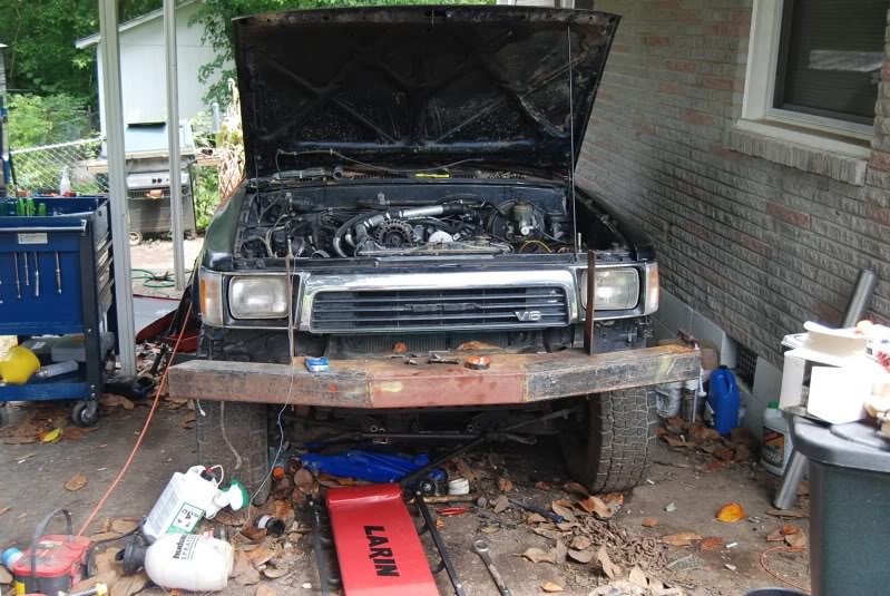

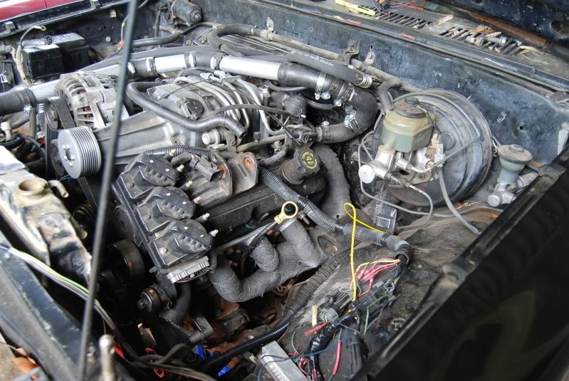

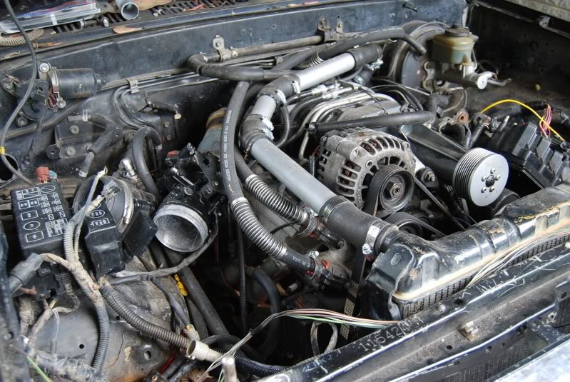

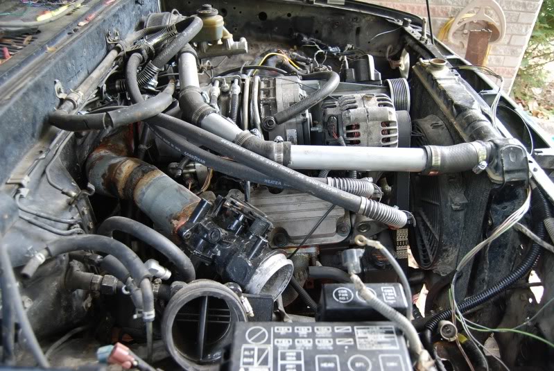

Here's the specs.....
Engine, 97 Pontiac Grand Prix GTP 3800 Series II Supercharged, stock internals, ported blower, 1" ZZP intercooler coming soon, 72 mm ported stock throttle body, deleted factory MAF sensor port, LS1 MAF, 3.4" blower pulley, custom 1 5/8" headers dumping to a single 3" pipe with high flow cat.
ECM, Same
Wiring Harness, modified 93 4 runner Harness (Mine had an accident when a previous owner tried to "fix" the air conditioning by putting a 30 amp fuse in a 15 amp hole.) New harness is from an SR5, so now it is wired for cruise and power windows, mirrors, and door locks.
Bellhousing, 99 Dodge Dakota 2.5 5 spd, 2wd (Has the correct bell pattern and used the same trans as yota.) with a new starter notch cut out on the drivers side.
Clutch, jeep plate, camaro flywheel and pressure plate.
Trans, Stock yota with a jeep ax15 input shaft, dakota front bearing retainer and flywheel.
The rest of the running gear is stock. (For now.)
Working on the oil pan today (Enlarged and modified to clear the differential.) then finishing up the wiring.

Attachment 185747
Attachment 185748
Attachment 185749
Attachment 185750
