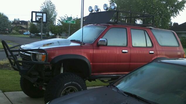

roof rack I built still not quiet finished
let me know what you guys think.
Im going to add an airtank and a lock box maybe some other stuff

Looks good! Maybe a little top heavy once its loaded up but it shouldnt be too bad. That bumper sticks out a lot farther than I thought it would looking at the pic from the front. But still looks good.
Thanks im actually gonna pull roof rack back off and shorten it so its not so tall. I like the bumper like that so I can sit or stand in it lol when im messing around under the hood. I also came up with another roof rack use park in the back of the drive in and throw a chair up there call it box seats lol

Ha ha nice! And that bumper would make a good seat for working on the motor!
