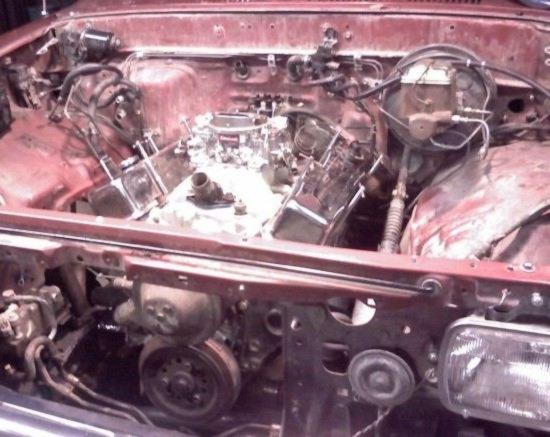

My V8 swap 92 runner
sbc 350 th400 np208
Attached Thumbnails My V8 swap 92 runner-engine1.jpg   My V8 swap 92 runner-engine2.jpg

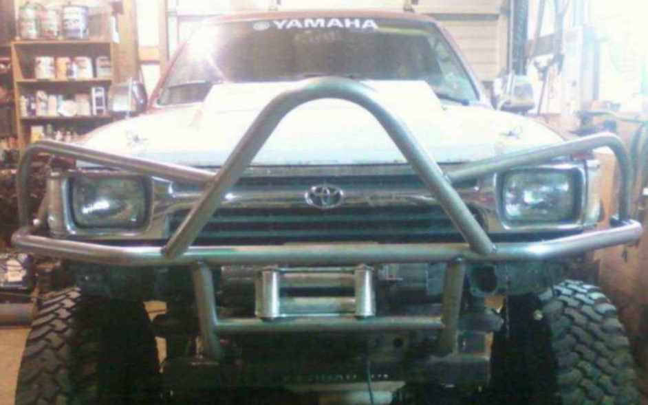

more pics

what fan set up are you going to use to cool it with
Old Nov 13, 2010 | 08:06 AM
Akilleez1's Avatar
Joined: Jun 2008
Posts: 27
Fans
I actually am using two pushing electric fans that were pulled from a geo metro or suzuki swift got them at the local wrecking yard They fit pefect right between the grille and core support so grille is still stock
