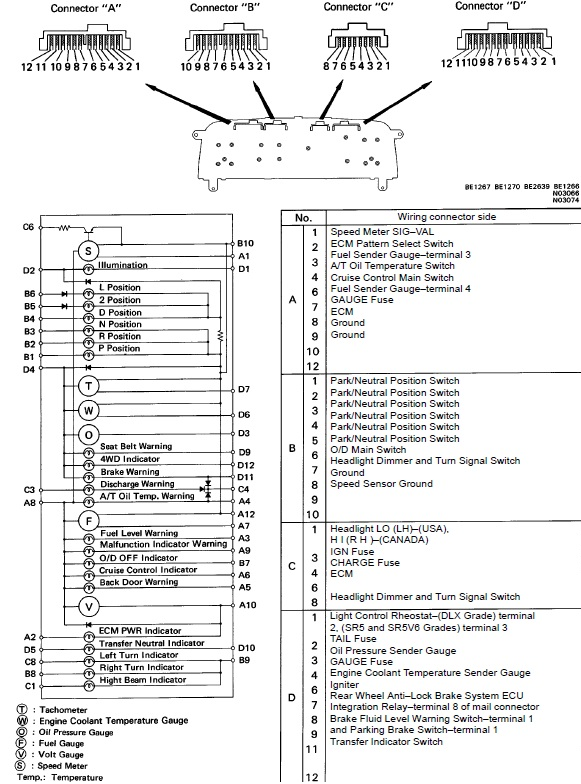

If you dont already have this info it may come in handy if you decide to keep all your factory gauges working with the 5.0..
Attached Thumbnails my 302 5.0 swap / ?-cluster1.png
omg you are the best in the how yota world ! loli was hella looking for it ...
