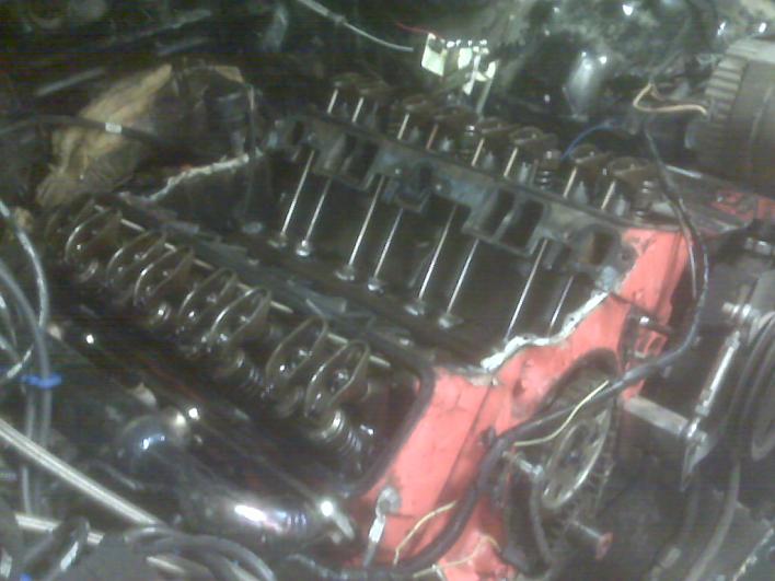

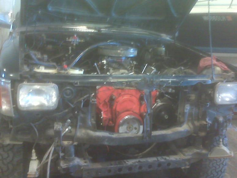

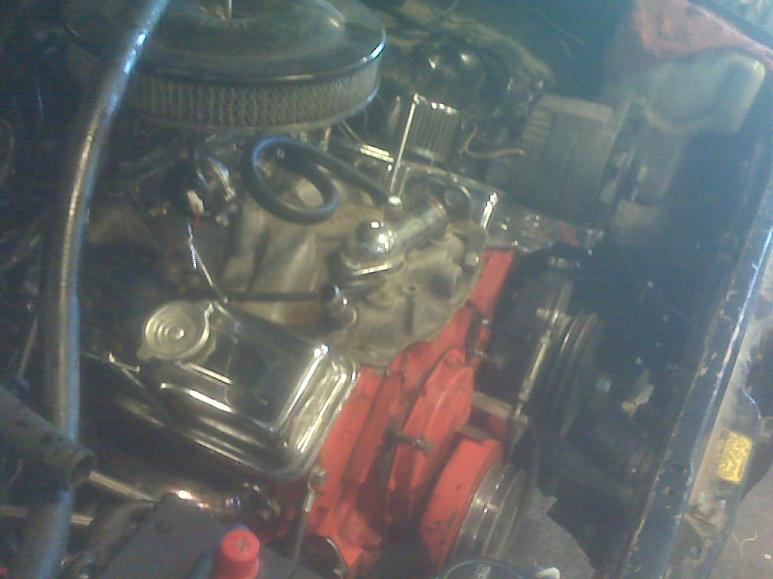

i get round the same 12-15, really haven't paid much attention to gas mileage, i chucked my 3vze when i blew head gasket, here are some pictures of my current cam install

Attached Thumbnails Chevota cam install!!!!-img00388.jpg   Chevota cam install!!!!-img00389.jpg   Chevota cam install!!!!-img00390.jpg

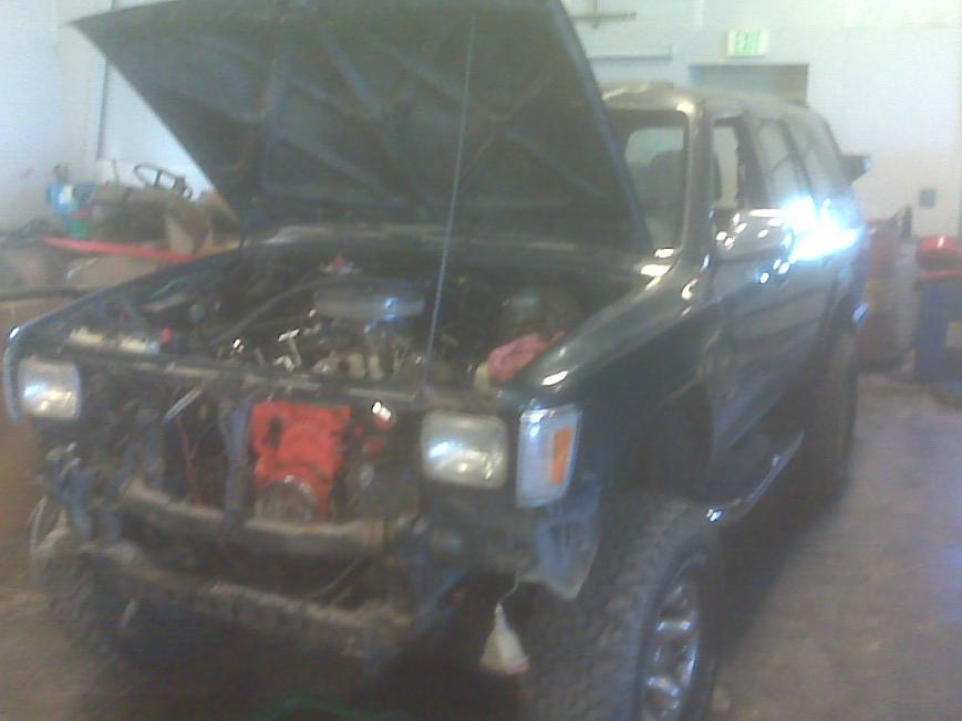

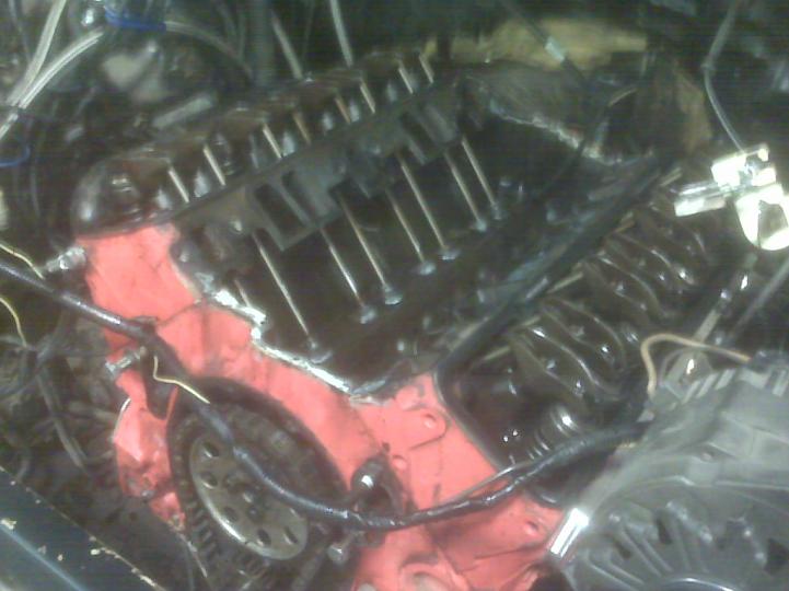

so i finally removed my camshaft over the weekend and sure enough #1 cylinder exhaust lobe gone!!!!
Attached Thumbnails Chevota cam install!!!!-img00391.jpg   Chevota cam install!!!!-sbc-350-no-timing-cvr-intake.jpg

in those pics the cam is still in it lol i want to see it are you gonna upgrade to a different cam summits sells all theirs for the same price am looking for a cam to put in my 350 so if you find something let me know

i already install my cam, kinda skipped takin more pic's, i installed a Elgine cam model #e-1019-p, i believe lift is 464, drove it saturday pulls really good at 2500 rpm's, i also replaced timing gears and chain to a double roller set up
