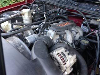

I bought a 95 jimmy.My donor. Follow my sas thread for updates. eventually ill start a swap thread.
