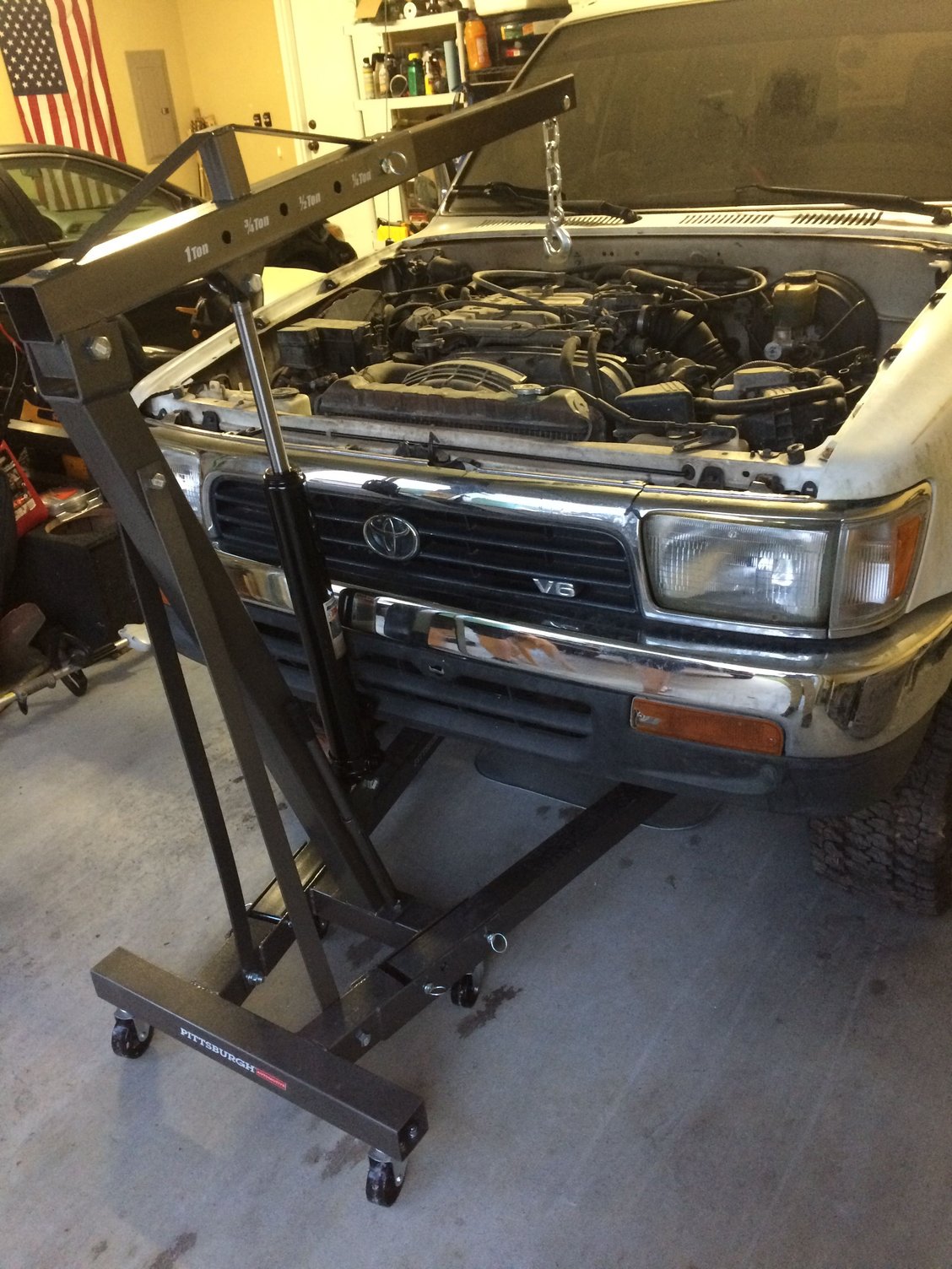

here she is.
got the hood off, ready to get to work.
almost ready to pull the old 3.0
hey everyone, new to this motor swapping business so I need some help.
My truck has the factory automatic transmission and transfer case and I was curious if it would match up and hold up to the sbc 350 or if I would need to upgrade the transmission and xfer case??? I can only find info on the 5 speed to sbc, but not the automatic.
