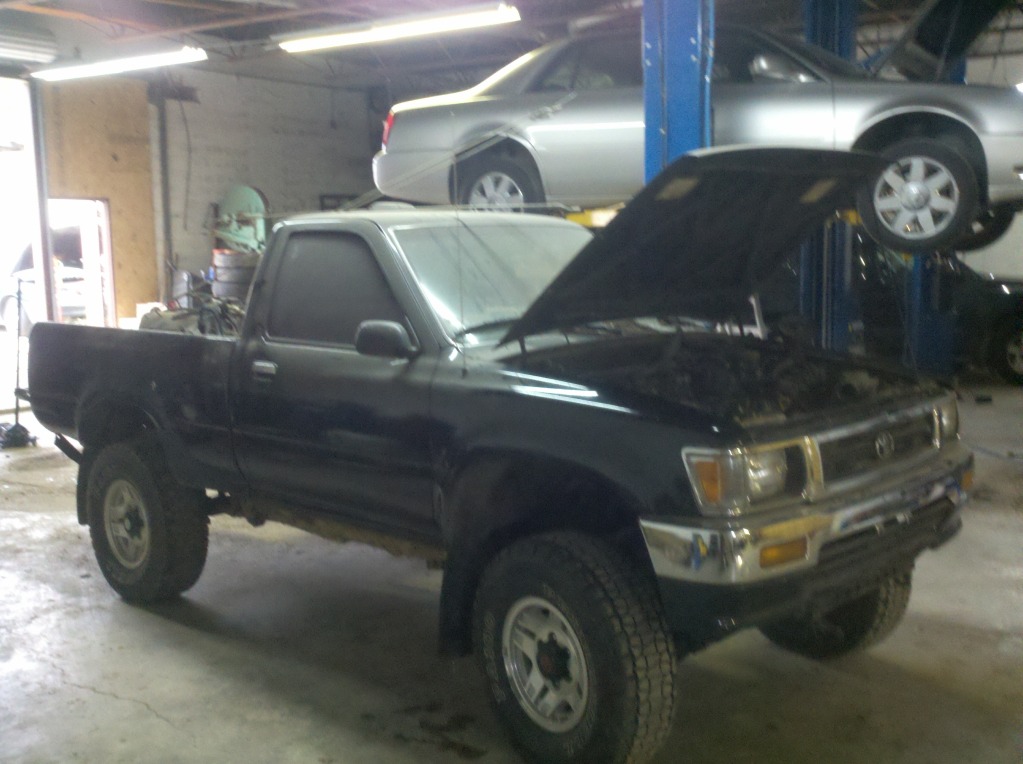

I wouldn't sh it you after all you are one of my fav turd N'all. You have to remember not everybody see's the world through your eyes and your point of view. sure if you wanted a powerhouse I would choose a V8 swap. but for an eco build there are hundreds of choices if you want to get away from the underpowered 22r. My ranger with a 3.0 had some giddie up and go I also had some 2.3 5spds too but I was more impressed with the 3.0 for economy and power as a middle of the road choice the 4.0 had more power but not as much on the fuel eco department. the 3.4 toy is a excellent choice too. I say do what you are interested in and don't let what seems to disgust a few critics have too much influence on your project. BTW my DD was a 4 cyl 5spd S10 until yesterday (I was driving up the interstate and it started blowing white smoke) I will have to hurry and finish up my currant project My eco V8 swap a 1995 hi-lux 4X4 350 chevy stock TBI injection chevy rear springs SAS with rears up front 4.10 gears 150f 5spd. My hopes are to get about twice the power of the 22RE and get what may be unrealistic fuel mileage of 18 to 20 MPG? maybe on the highway
