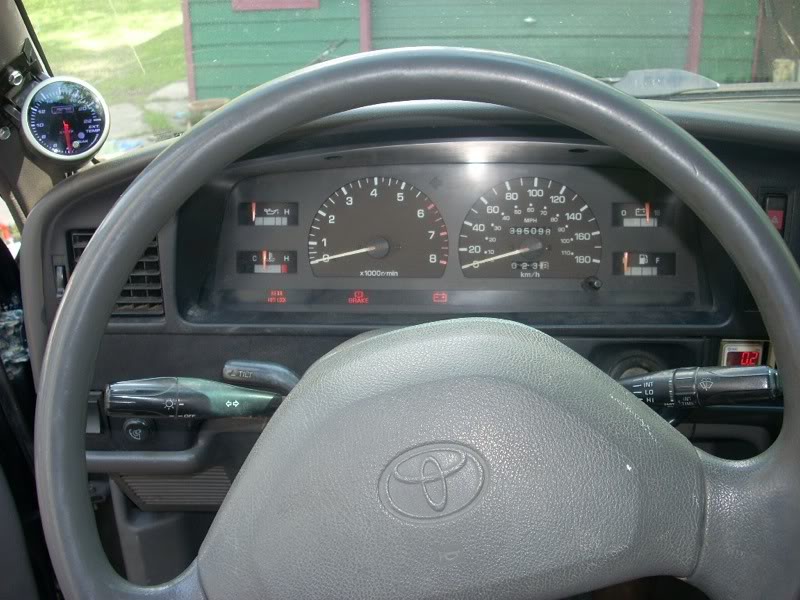

Here is the dash with my Pyro gauge on the left and the PSI on the right where the clock goes.Name:  DSCN0107.jpg

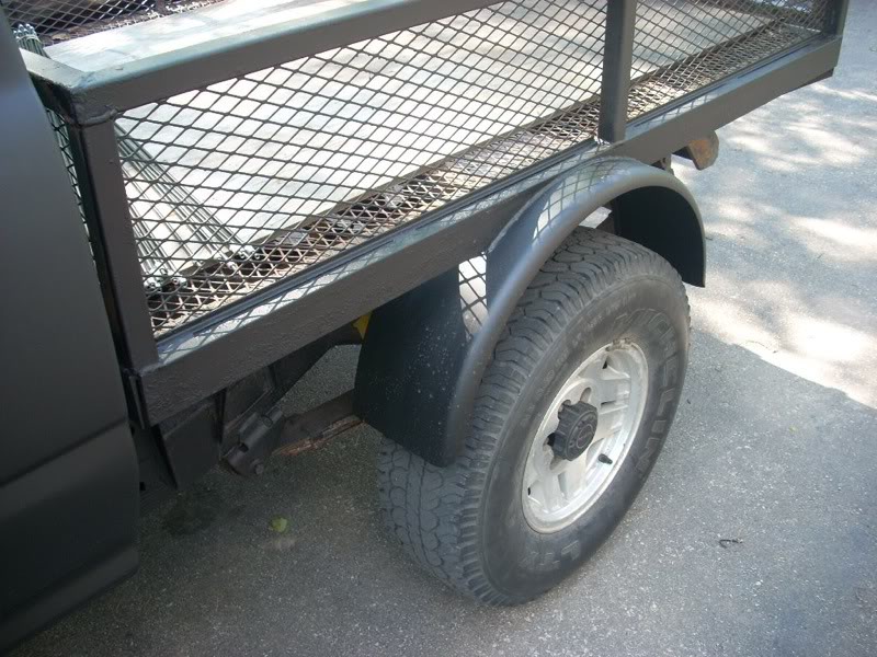

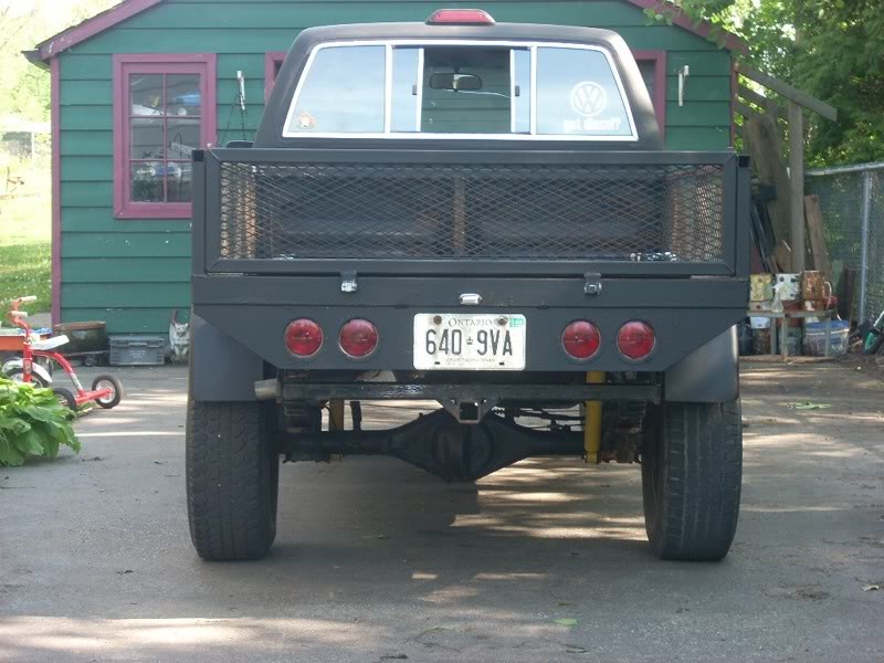

I added fenders for the MTO and painted the box.

I got my plates today, no problems. I had everything I needed, so they just did the paperwork. Those fenders come down a lot so I am going to leave the flaps off. I ran this box on my 88 with no fenders and never had a problem. I never see the MTO here and all the cops want are speeders.
