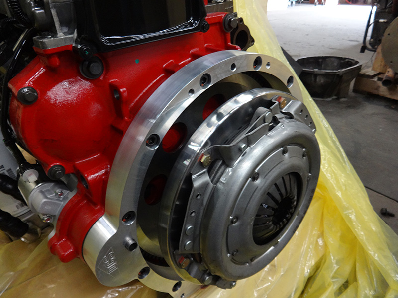

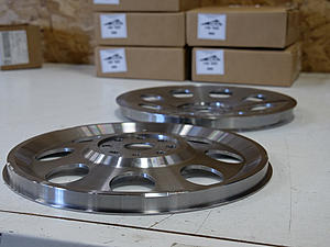

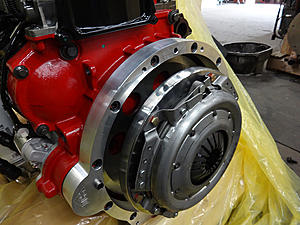

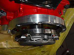

We've done adapters for the VW 1.9 TDI to the W56 (and shortly the 151) and the Cummins 2.8 to the Jeep NV3550. We have a 2.8 adapter started for the Toyota as well. We replaced the flywheel on the 2.8 with a starter drive (like a flexplate) and an adapter out to the flywheel.

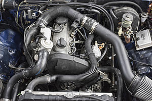

I have an 02 VW ALH tdi in my 88.
