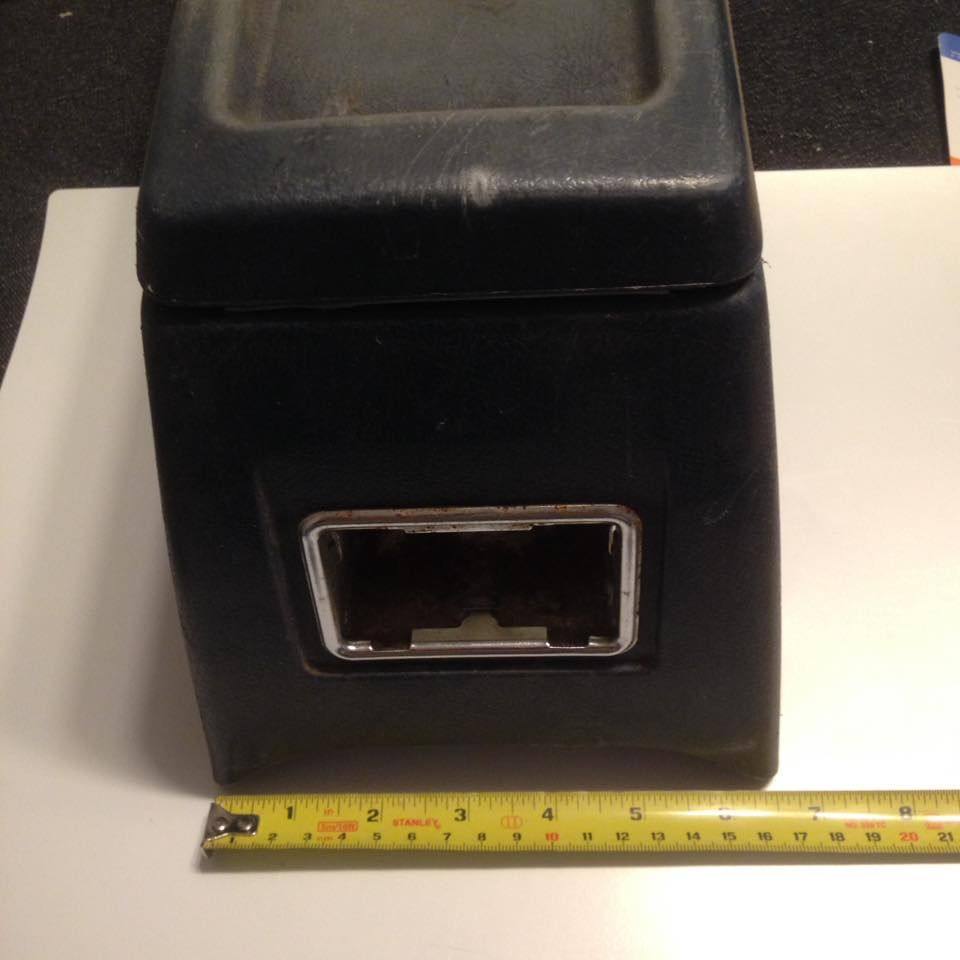

I plan on doing the bucket seat swap in my 92. Swapping the 60/40 bench with 4runner buckets. Instead of using the 4runner center console due to its lack of storage space, would this one fit? It says it measures 24" Long and 8.75" wide. https://www.amazon.com/Rampage-32001-Black-Padded-Console/dp/B000V9CGES?th=1&psc=1
I'm not worried about the length because I don't plan on using my back seats, but will it fit in-between the 4runner buckets? Could someone please post their center console dimensions who has one of the stock 4runner consoles?
Thanks
One more thing- when I go to pull the donor seats do I need to get the seat belt buckles too? Or can I use the ones for the 60/40 bench?

off the cuff - I had considered various Tuffy metal consoles way back in the early 1990s
And the number I recall was 6.5" wide....
The top / armrest part is even narrower - like 4"
I think you need the seat belts too - the buckle attaches to the center "hump" if I recall

on the 84-89 body style, the SR5 "double height" console (not pictured" uses the same base.
Note that the actual inner compartment is way smaller than the 6.5" mark.
There are cut outs to allow the front seat belt buckle / mount to pivot.
An "Ammo Can" might work better as a steel center console box
