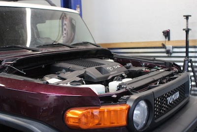

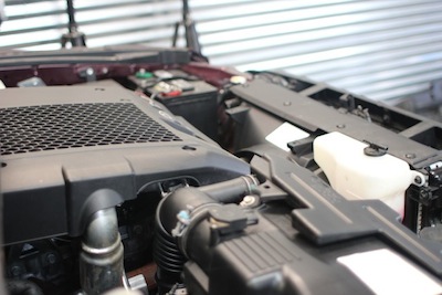

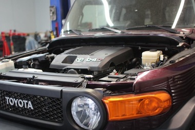

Old Sep 27, 2012 | 06:19 PM
  #238
Joined: Jun 2003
Posts: 100
From: Texas
Jarco has not imported these since 2008 due to EPA importation regulations so we have had to become our own importers. Here's an FJcruiser D-4D we're finishing up.
Attached Thumbnails 88 4Runner 1kd-ftv swap (NEW) w/pics-2.jpg   88 4Runner 1kd-ftv swap (NEW) w/pics-4.jpg   88 4Runner 1kd-ftv swap (NEW) w/pics-5.jpg

Old Sep 27, 2012 | 06:38 PM
  #240
RBX's Avatar
RBX
Joined: Jan 2010
Posts: 3,795
Likes: 33
From: Bloodymore
Todd, that will have the nz and oz guys drooling, iirc they get the fj cruiser with a gasser only.
I tried Jarco first to find out they don't import anymore, their name is plastered all over the net for halfcuts. Of course much older posts, but man they must have been selling a ton.
Can you weigh in on why the diesels are forbidden by the EPA, but why some companies can still import them? I've heard it was pressure from the big 3 automakers to keep better diesels out of NA.
Are you going to graphed a hilux or landcruiser scoop?
