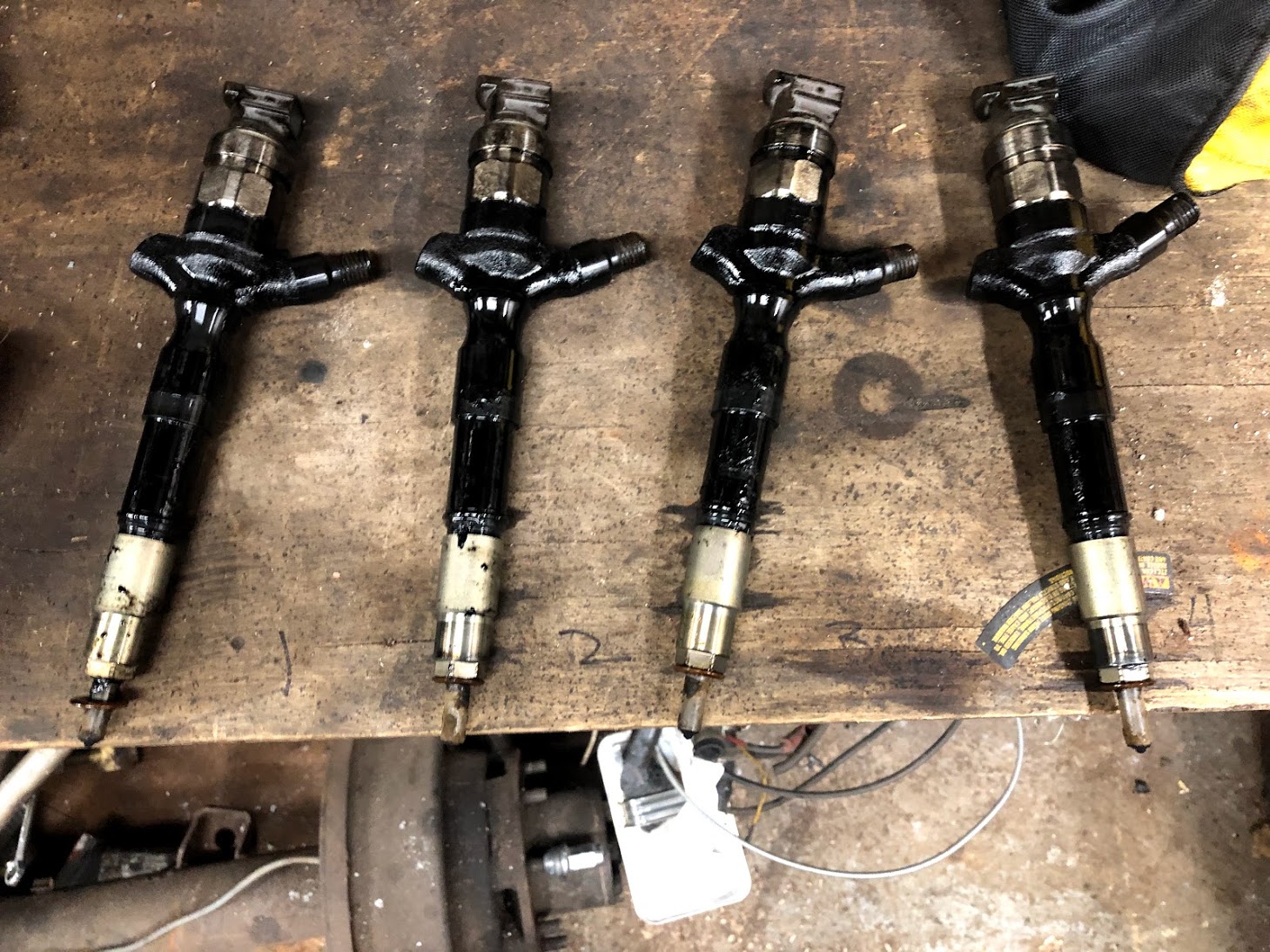

ECU was sent to Diesel Toys in TX for an ECU tune. Deleted the EGR and Immobilizer as well as added their mild tune to give more power and more MPG. After running the engine using TechStream I determined injector two would be failing soon, so sent the Injectors off to Baileys Diesel Group in Australia. After speaking with Simon, he told me that the main bearings are not a concern (as I was going to replace the mains) in these engines, but to switch out the hard fuel lines due to the mileage. So, new injectors (Stage 1 15% more flow), valve cover gaskets kit, fuel hard lines and suction control valve for the injection pump.

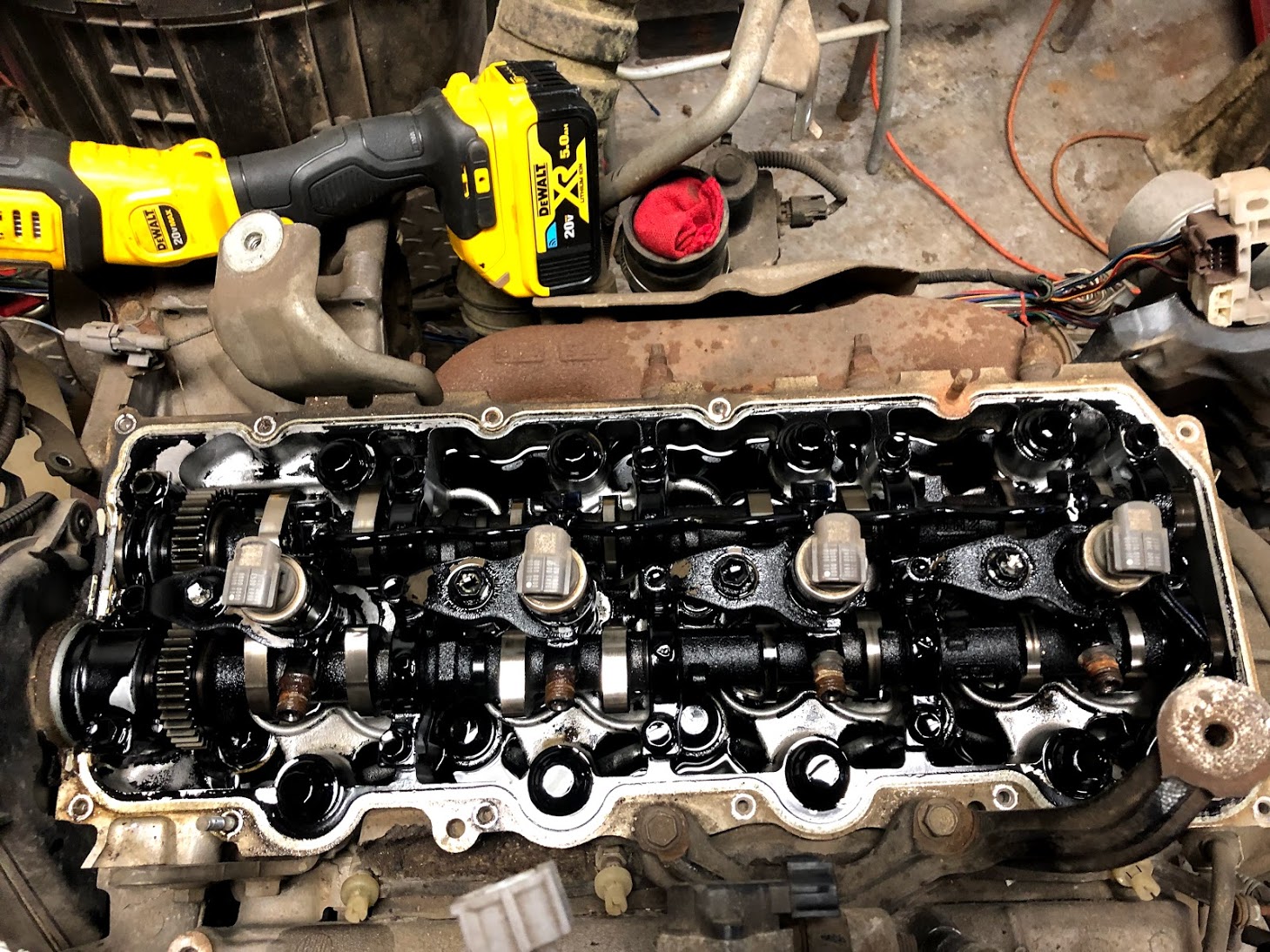

Valve cover off, the black gets on everything, its worse then anti-seize.

Injectors getting sent out to Baileys Diesel Group, going Stage 1 which has a 15% higher flow for a future mild tune.

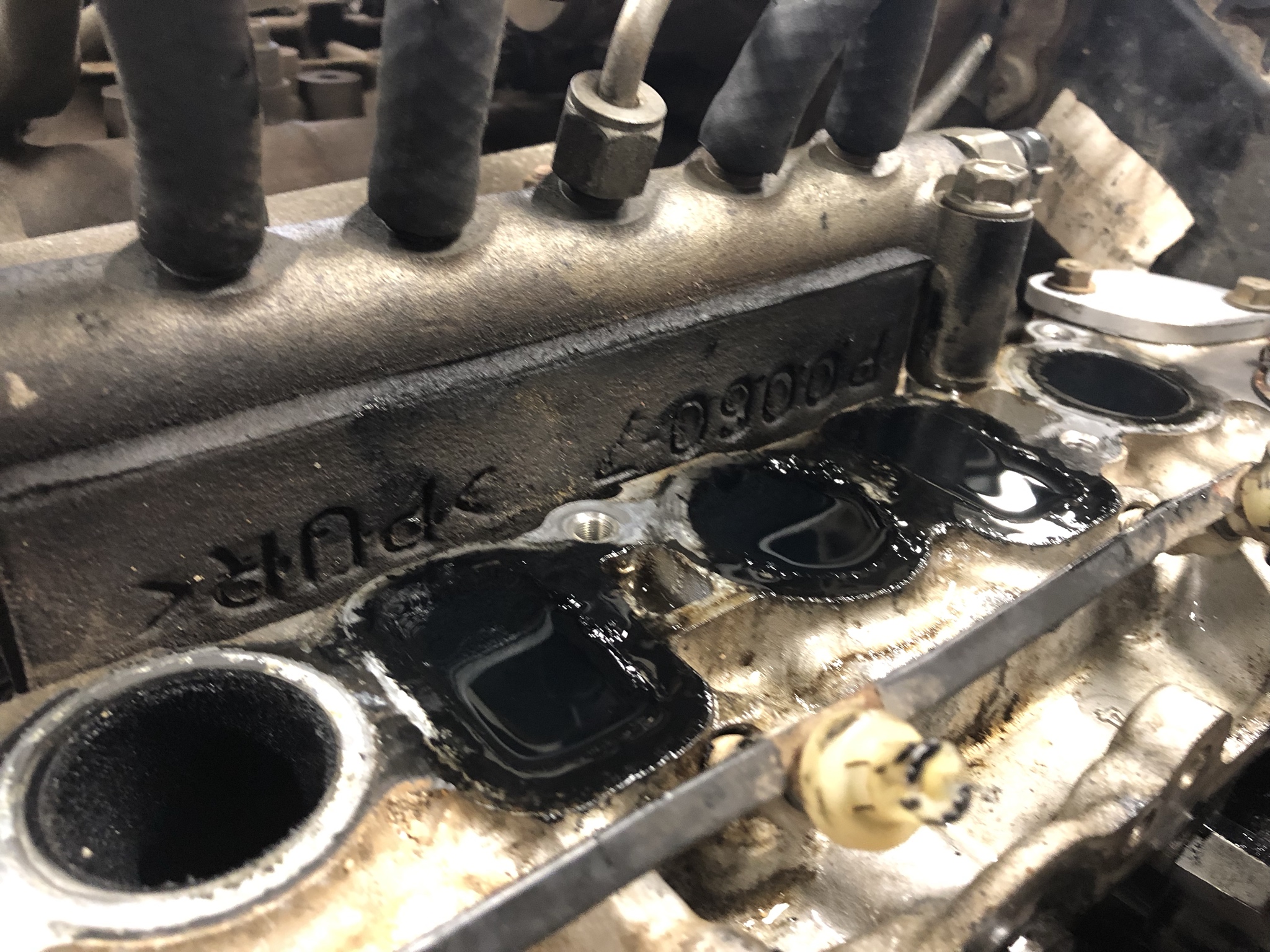

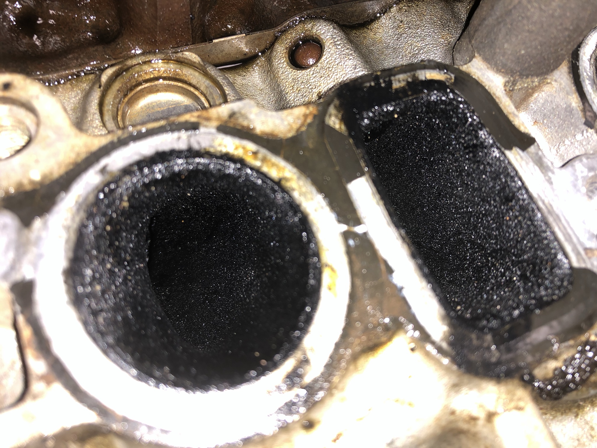

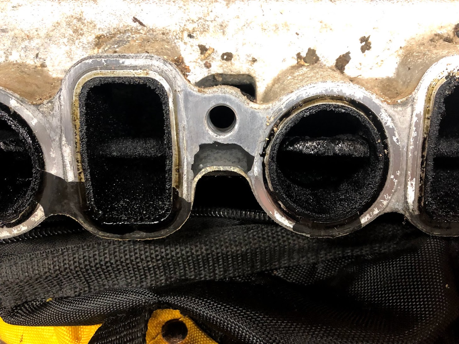

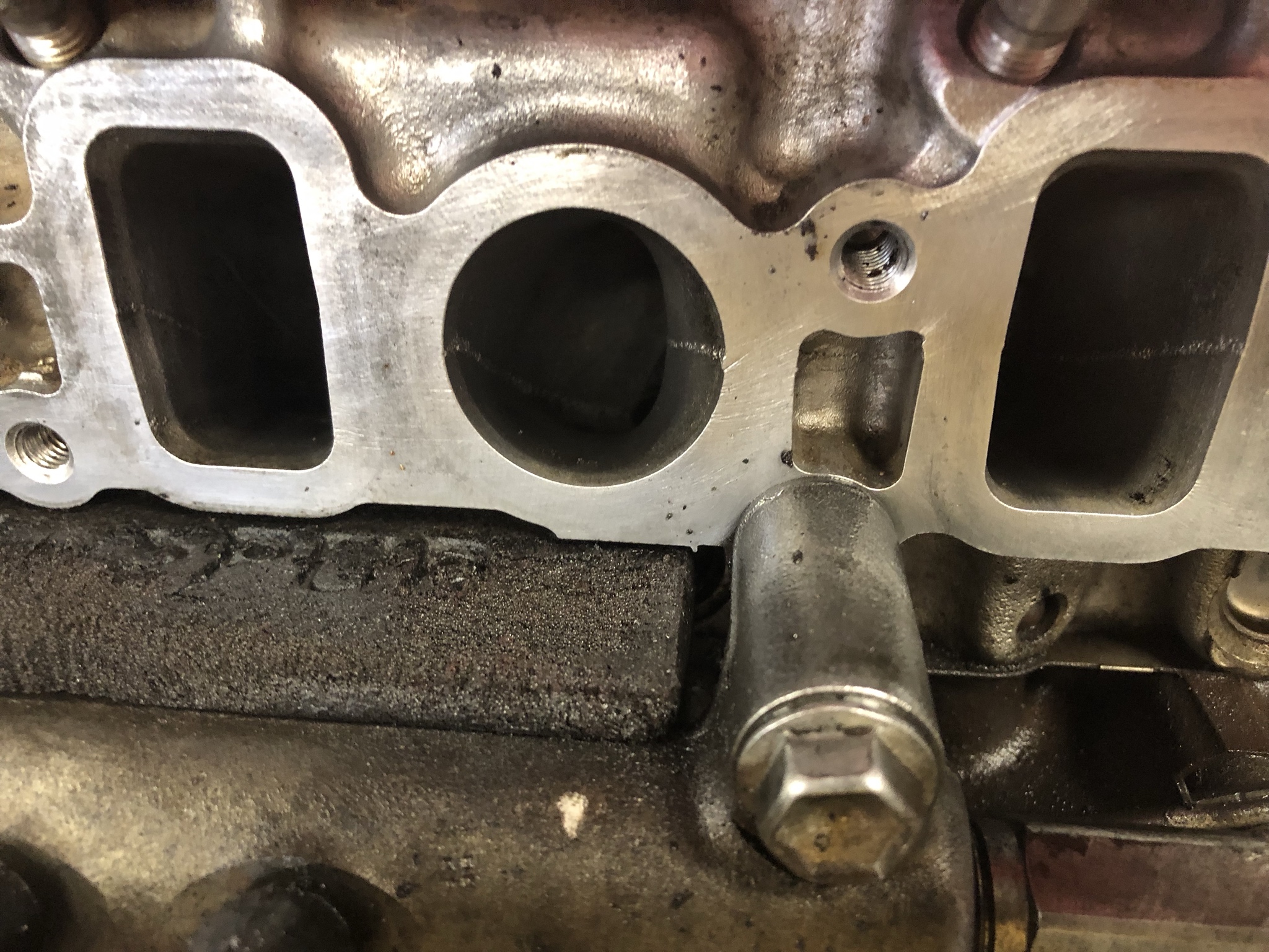

Intake manifold nastiness. There is a butterfly valve on the circular cylinders, with about an 1/8" of soot and oil tacked onto it.

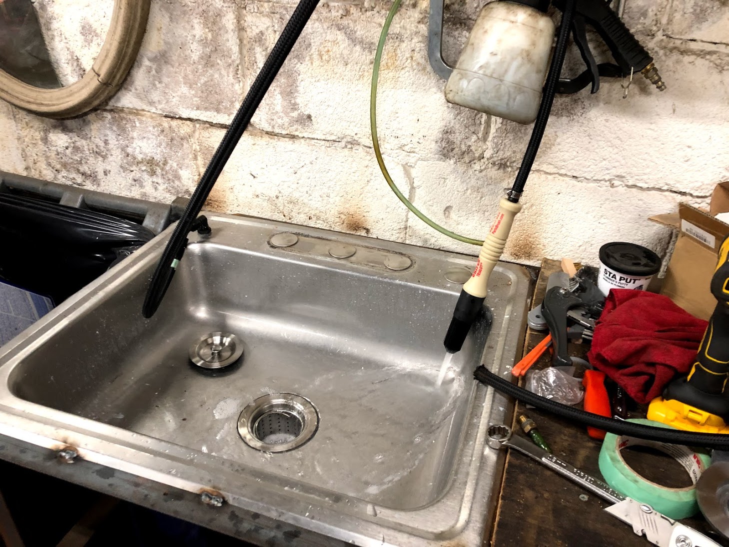

To deal with the black death...

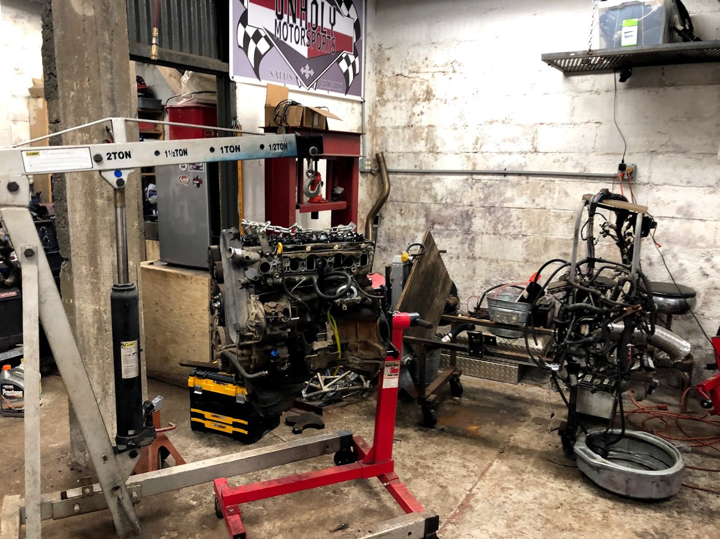

Made a parts washer out of some bits we had laying around UnHoly Motorsports.
88 4Runner 1kd-ftv swap (NEW) w/pics-eb0fgdr.jpg

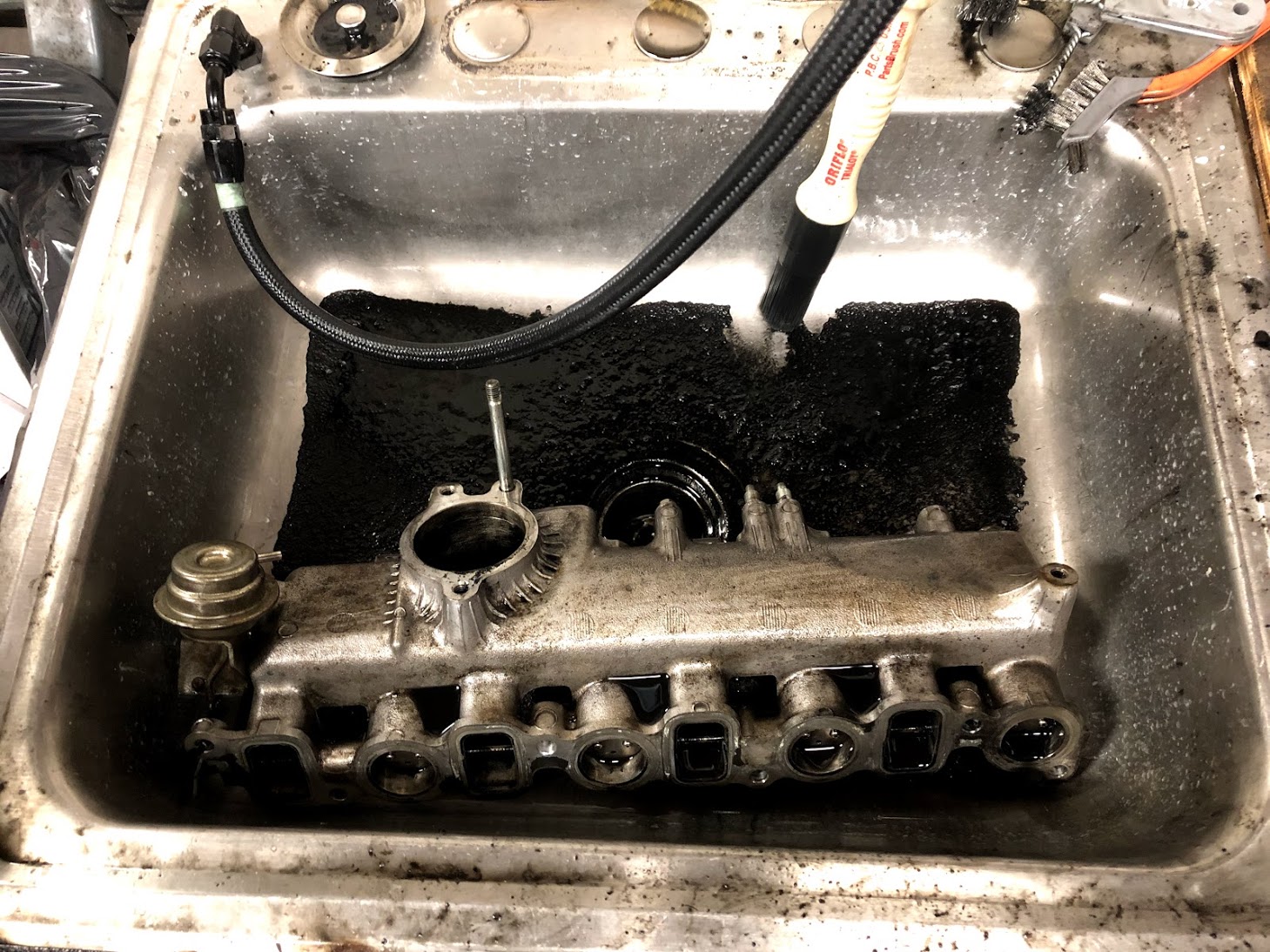

First pass with the parts cleaner, that is soot in the sink, about an 1/8" thick. This is all due to the EGR, cancer to diesel engines.
88 4Runner 1kd-ftv swap (NEW) w/pics-2pu2gno.jpg

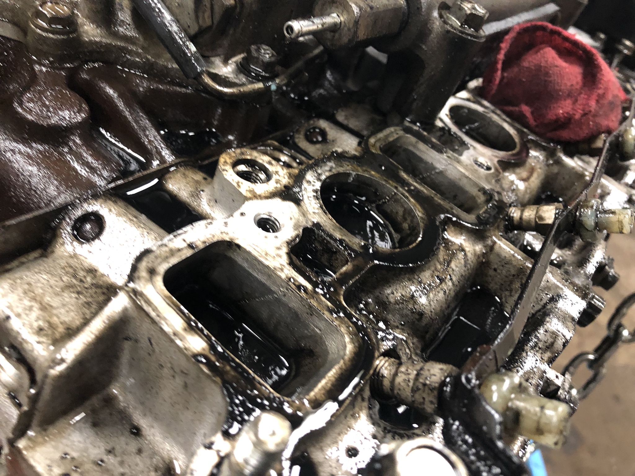

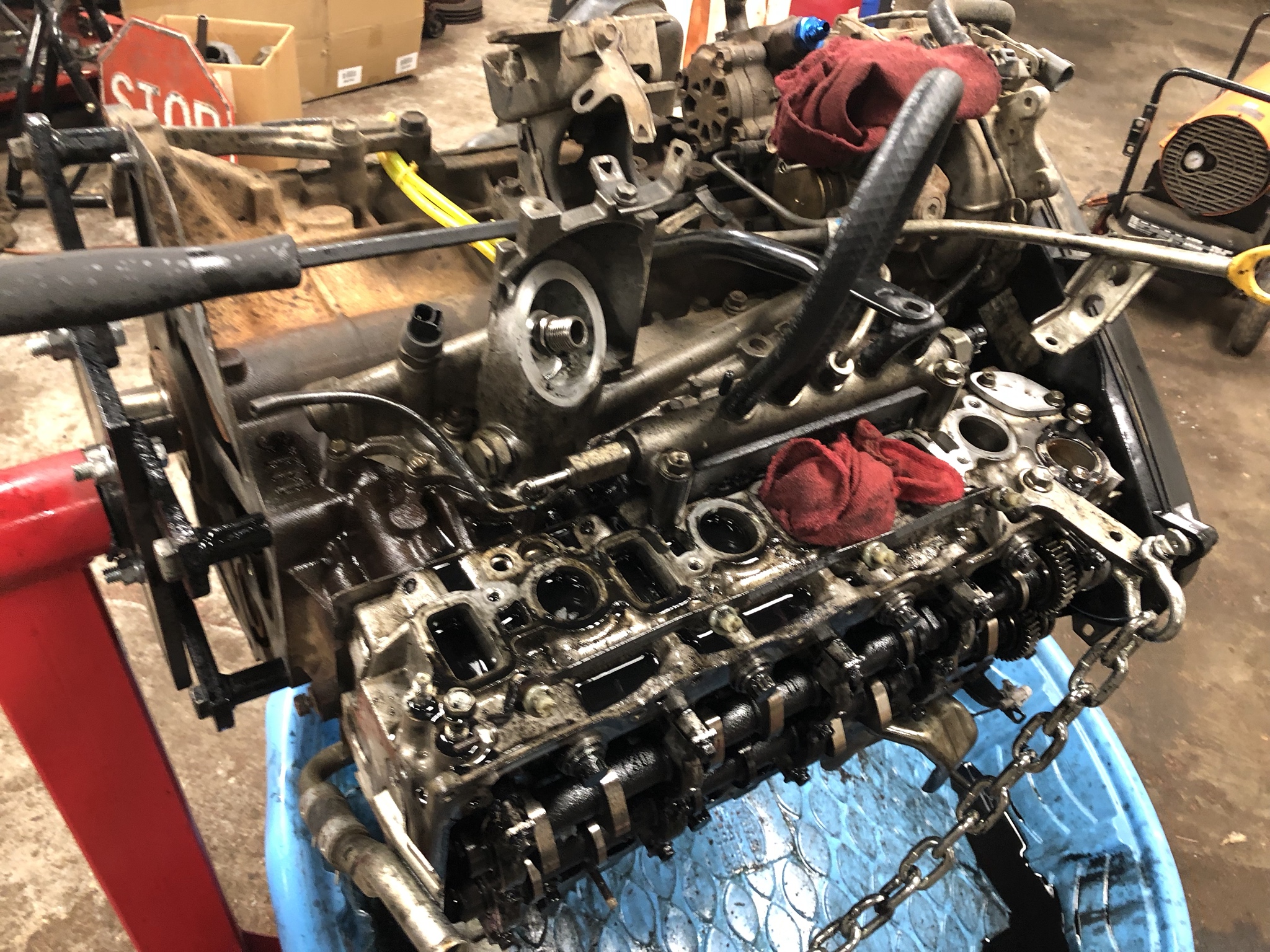

Engine back on engine stand for cleaning and maintenance. Will be rotating the engine to clean the intake ports on the head.

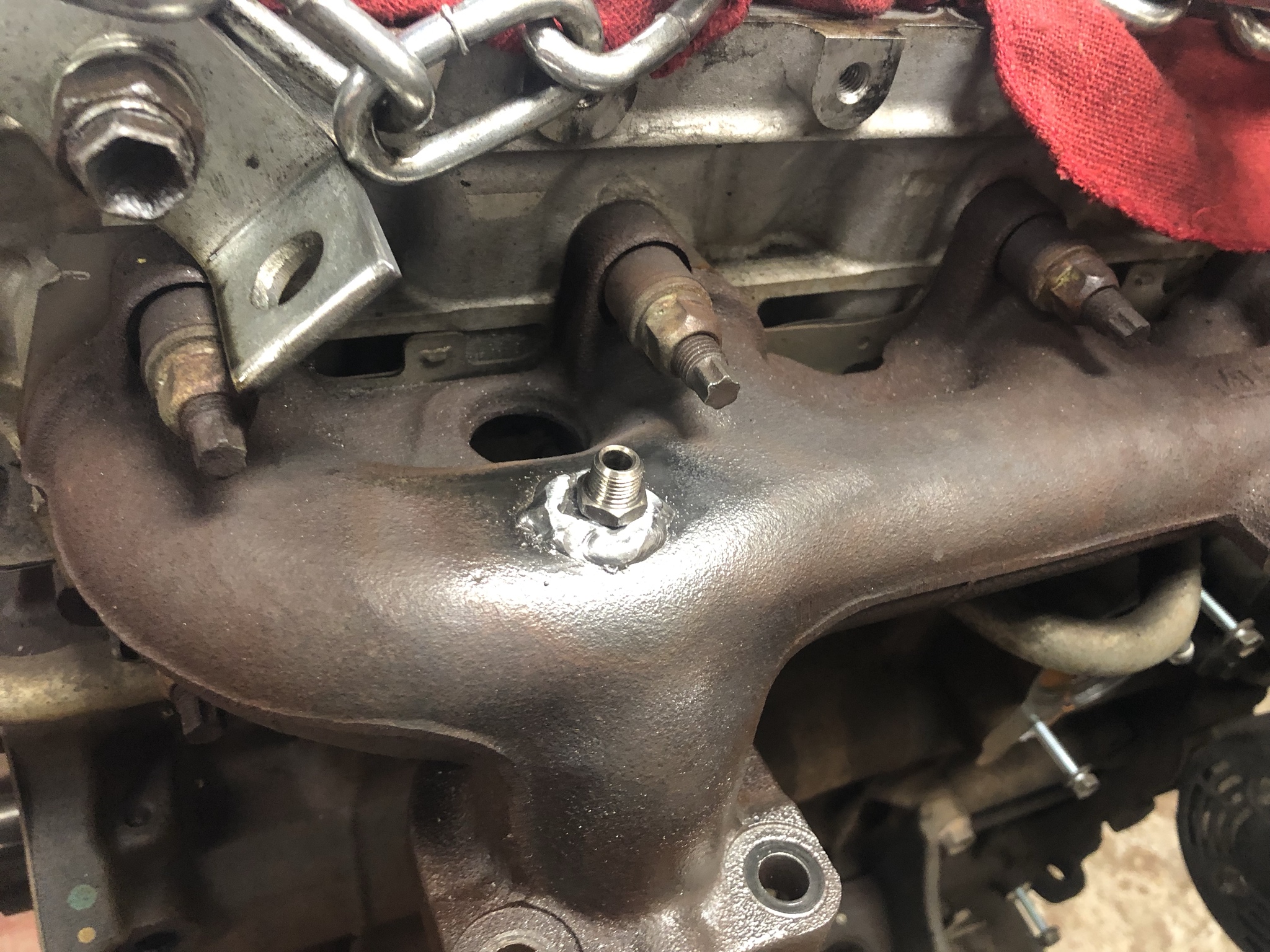

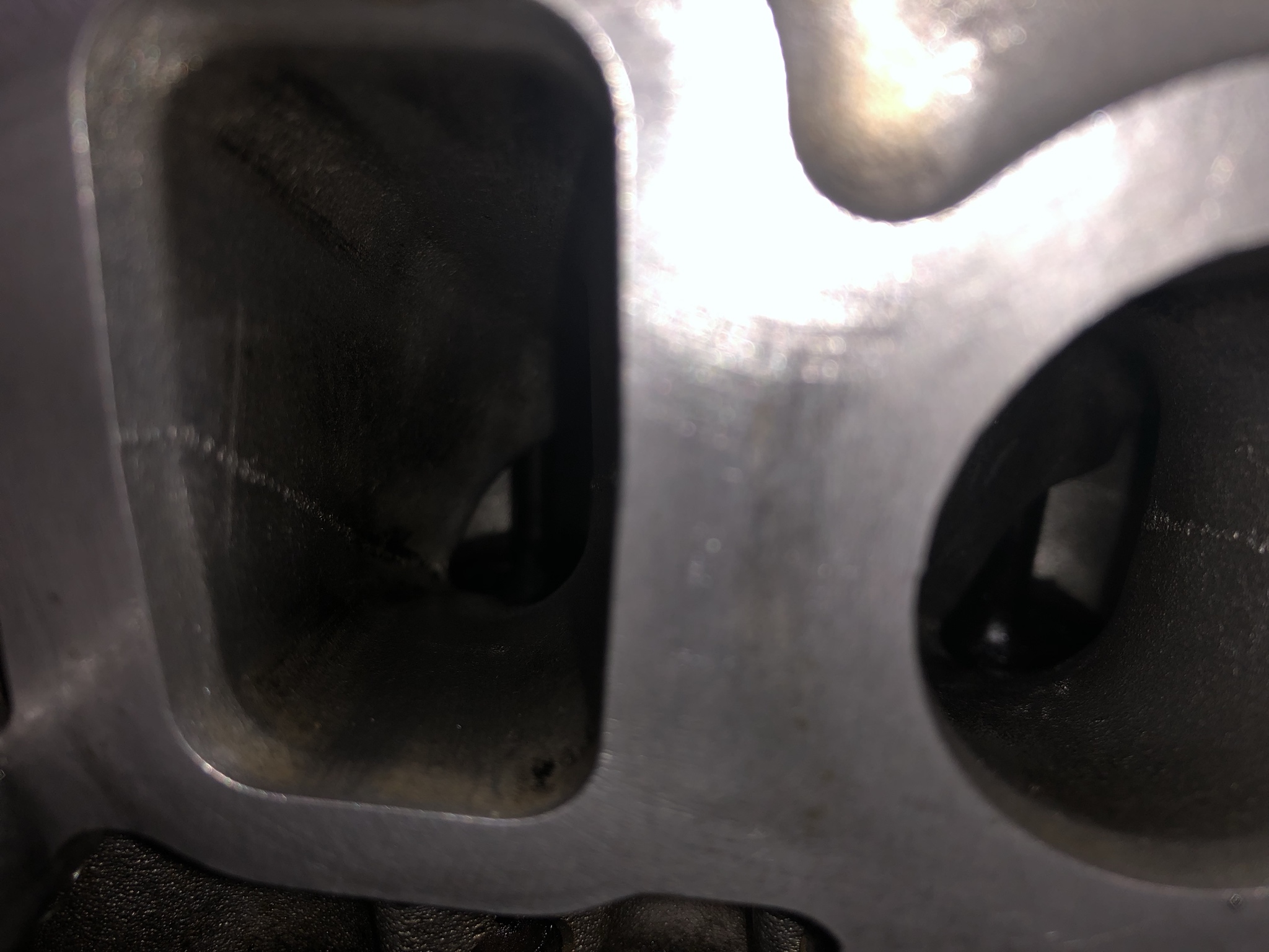

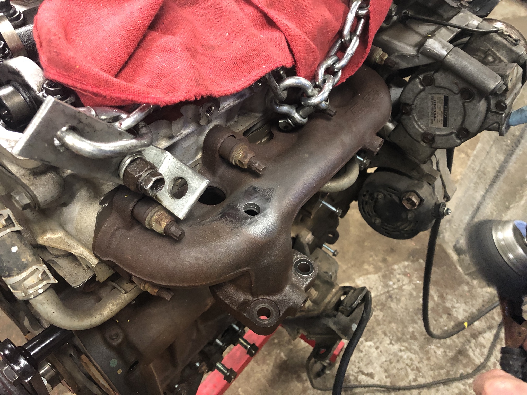

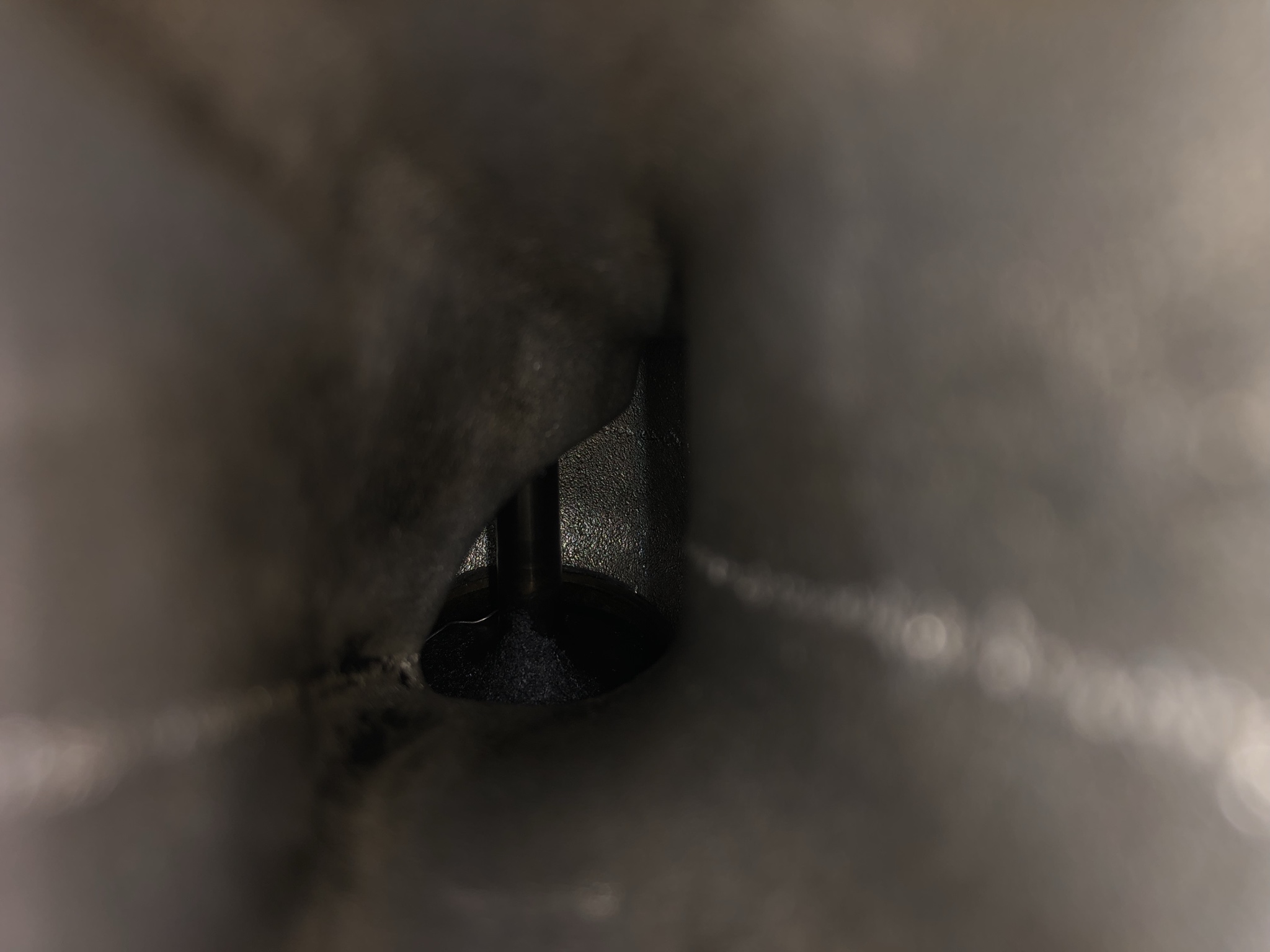

Did some cleaning on the head intake runners and welding the EGT bung into the exhaust manifold.

Welding on the cast manifold for the EGT bung

Just welded that to the cast iron? How well did that work? I assumed you kept it hot while you worked?

What solvent did you use to remove the EGR gunk?
Yep, used a MAP gas torch and had the heat(voltage) cranked on the welder. I never realized just how thick the manifolds are, now I see why many guys just NPT tap the manifold.
I bought a gallon of Sea-Foam, worked really well after letting it soak. Many of the 1KDs I've seen getting an EGR cleaning seemed to be much dryer than what I had, most seem to flake and scrape out. However, My mess was a black gooey substance that needs to be agitated to get removed.
