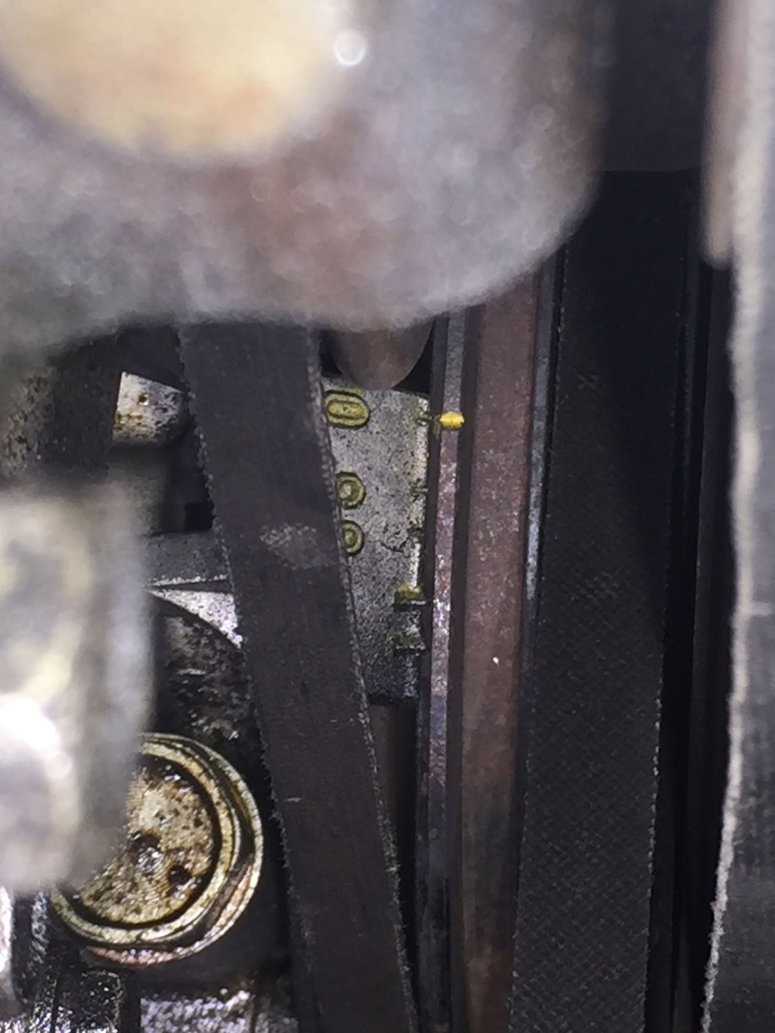

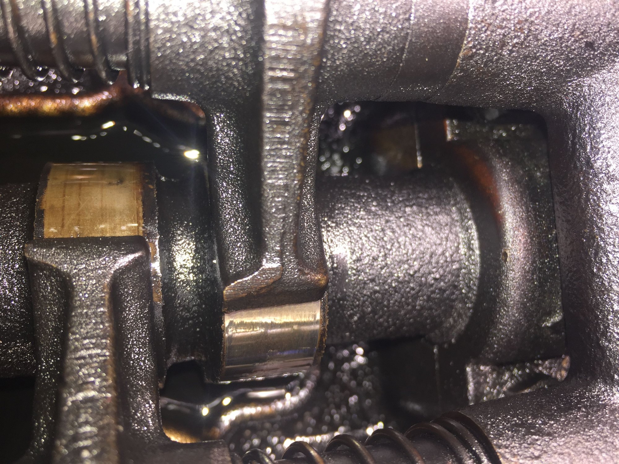

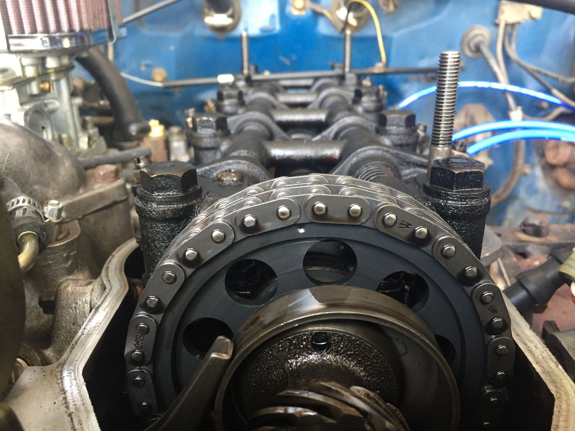

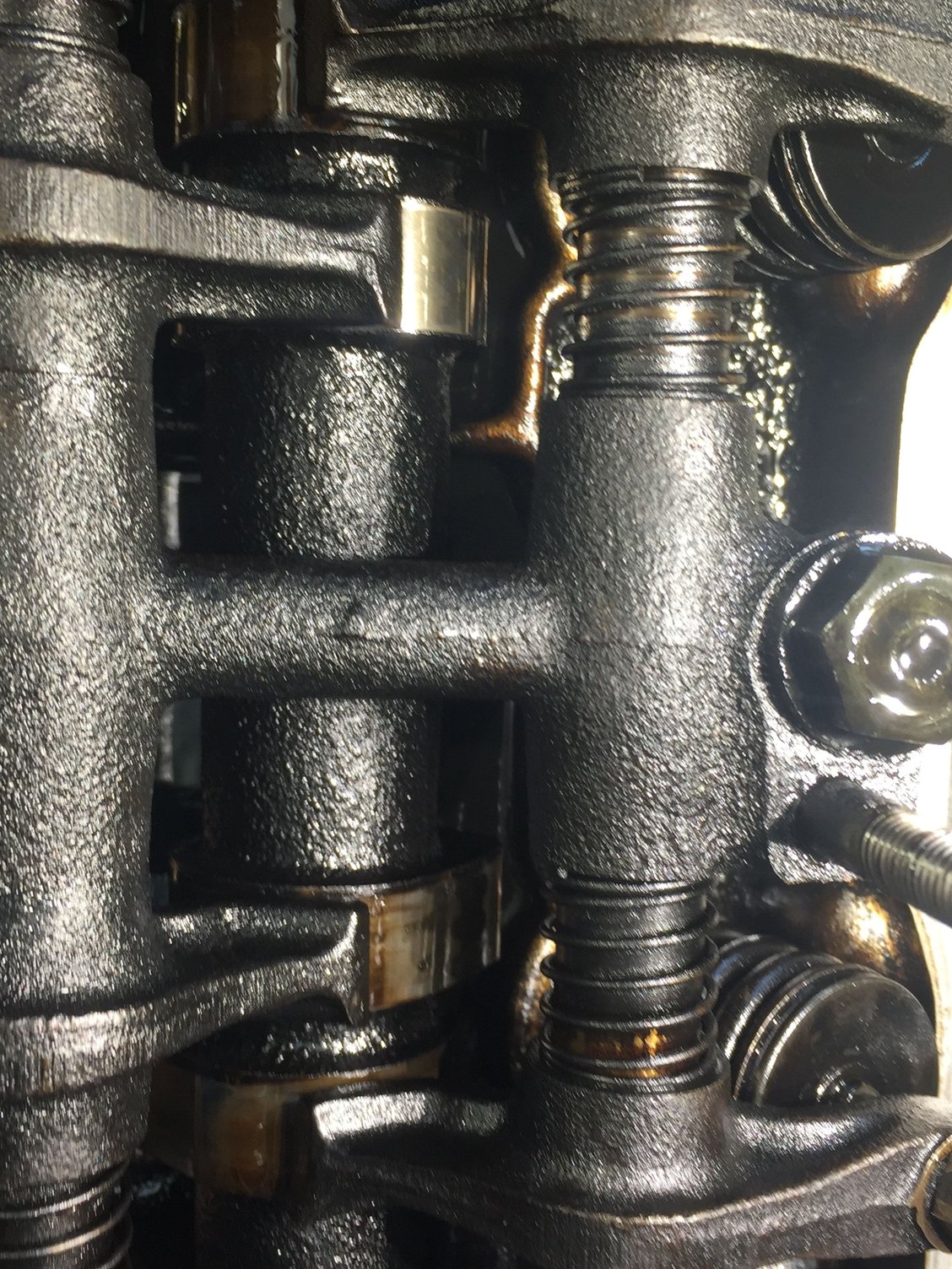

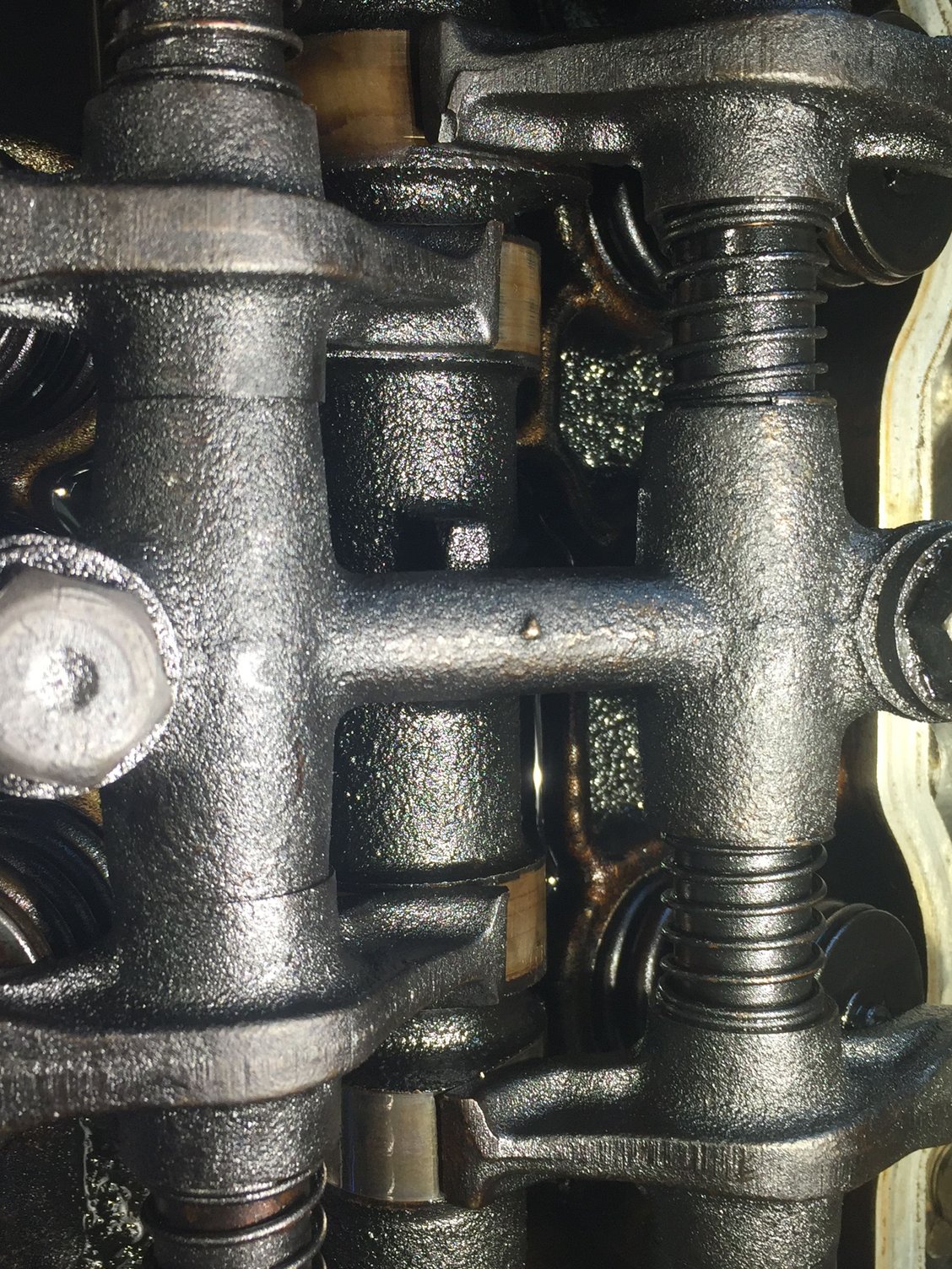

Need advice!!! My 1980 4x4 pickup has, I believe a hybrid 20/22R - and a noisy rocker has recently gotten worse - it now sounds like a little fella with a machine gun hiding under the rocker cover. From 0.008 (Int) and 0.012 (Ex) I gapped down to 0.006/010 cold. This just made to worse, louder with a very real metal on metal ringing noise. So went back to 008/012. I haven't removed the cam/valve train from the head yet. But on closer inspection, the valve adjustment screws are all in good shape with no pitting and the little polished hourglass shape is plainly clear on the valve stem end. The cam followers and valve screws are all nicely lined up. The cam is discolored see pix attached. Oddly the TDC mark on the cam sprocket is about 1/2 a link off - not sure what that means. So all you 20/20R geeks - do I renew the lot, change the cam, what? I REALLY need the help!

Timing marks are perfect. The dots are used for lining up the bright links on the chain upon assembly. There is a corresponding dot at the bottom of the lower chain sprocket (which you can't see with the timing cover installed). The bright links only line up with the dots on the sprockets once every few rotations of the engine so don't worry about them if they don't seem to line up now. When the crank is at TDC, the cam dowel pin should be precisely at the 12:00 position which yours is. So no worries there.
The darker areas on the cam lobes are normal. When the valve clearances are adjusted correctly, the rocker makes zero to barely any contact with the base circle of the cam. It only really contacts the lobes which should be shiny and smooth. The last picture appears to show some metal transfer or galling on the cam lobe. If that's not an illusion caused by the camera and reflections, that is definitely not good. No telling how much longer it will last. If no other damage exists around the engine a new cam and rocker assembly should fix it. Beware of any aftermarket "new" cams. They are made of soft metal and will flatten very quickly. Cams and rockers must be replaced as a set. They wear into each other. Cam replacement requires removing the head bolts and rocker assembly. Unfortunately this removes all the clamping force on the head gasket.
