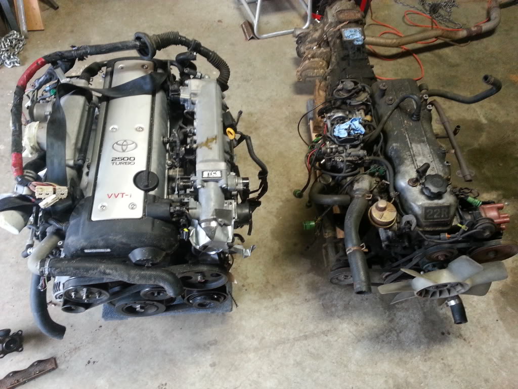

WOOOOHHOOOOO ITS HERE LOL FINALLY!!!!!!!!!!!!!! Hahahaa ok so on the left is big brother on the right is like, well like that cousin that's cool with a little time and effort it could be really cool...... lol

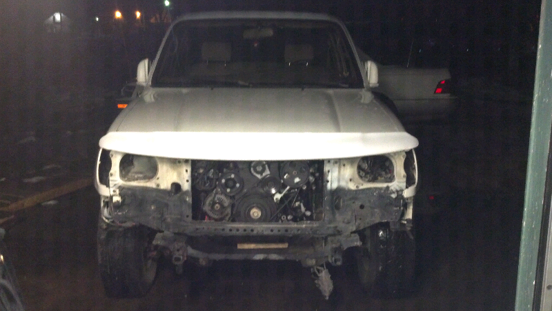

Got it in lol
