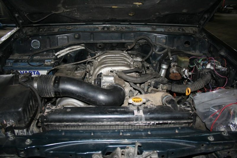

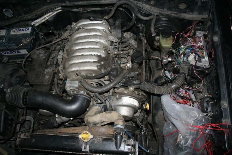

3UZ+A650+Prado

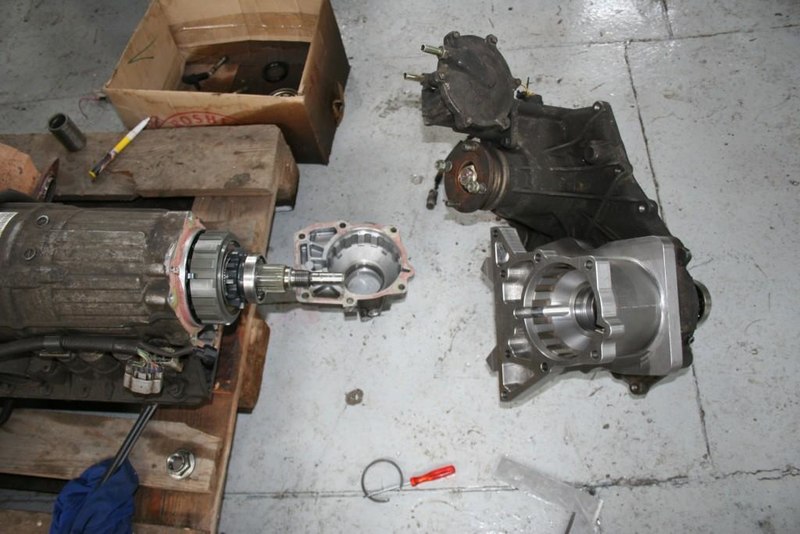

Cool pics. What adapter is that? What transfer case?
Old Sep 2, 2013 | 04:21 AM
  #53
serg4x4's Avatar
Joined: Jan 2012
Posts: 31
From: Russia
adapter is made in a single copy.
transfer case - vacuum TLC 70-series

serg was the adapter made by you?
Old Sep 2, 2013 | 10:23 AM
  #55
serg4x4's Avatar
Joined: Jan 2012
Posts: 31
From: Russia
No. I just consulted on the device gearbox and transfer box 1UZ and A341.
He performed another person in another city in Russia.
The man went on. For SWAP took donor LS430 .

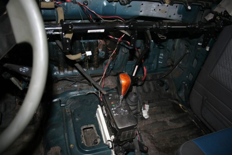

these are different machines, different designs, different engines, made ​​by different artists from different cities of Russia.
I personally made ​​just 10 prekte 4x4 automatic transmission and a motor 1UZ, 5VZ for different cars.
I could tell a lot - but I do not I talk in English ...
Google transliteration does not give a correct translation of technical terms.

my work on this project - only transmission
