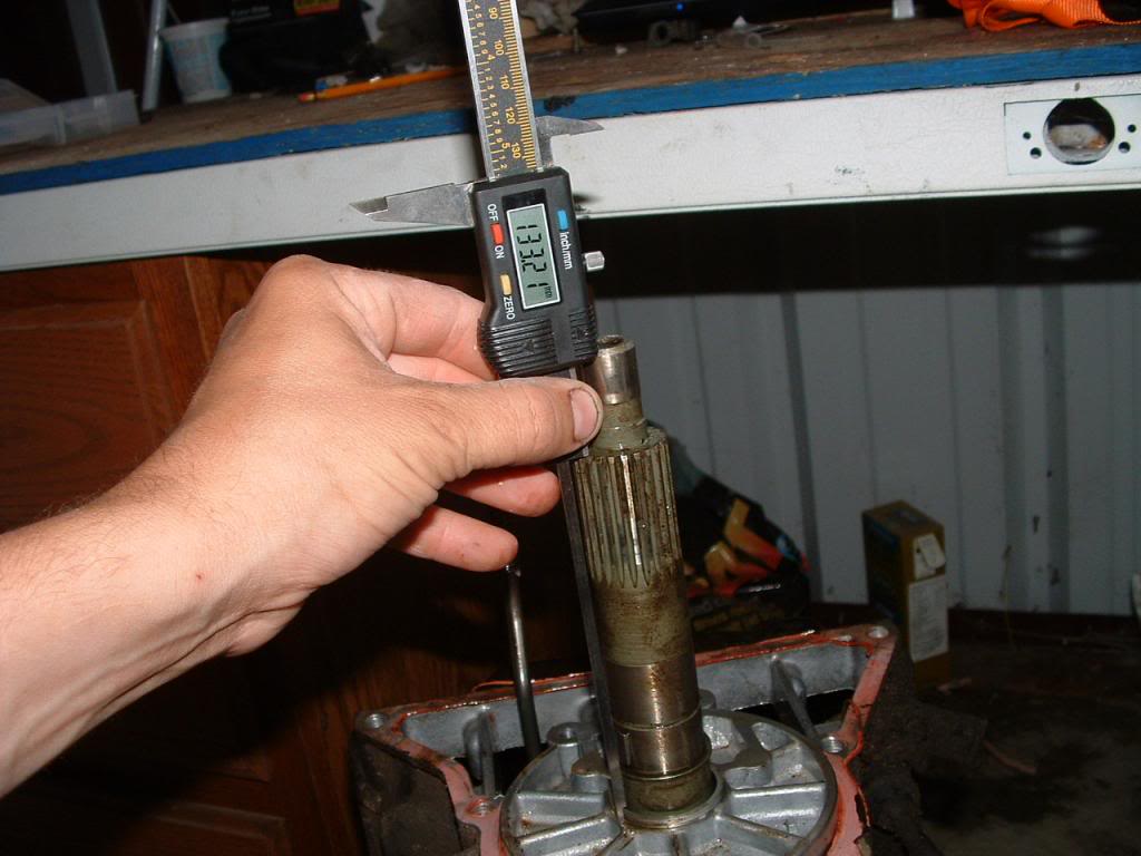

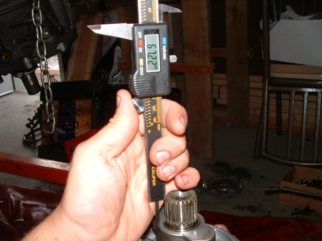

Today i disassembled the tails from the 340h (for practice) and 340f
here is what i found
This is the 340f from an 88 22re 4runner
This is the 340h from a 91 3vz 4runner
what i found is the shafts are in fact the same spline just different lengths
also i took the drive flanges from the 340h and slipped them on the output of the 340f it was a perfect fit.
seeing this i am lead to believe you could take one of these and replace the lexus 3 bolt flange then be able to use a 4 bolt shaft from the trucks. this would be obviously 2wd but maybe a much more affordable option.
both of these trans incorporated a 2 sided rotor of sorts for a speed sensor (i believe) i was thinking the pickup in the transfer adapter could be used to output a speed signal for the lexus cluster

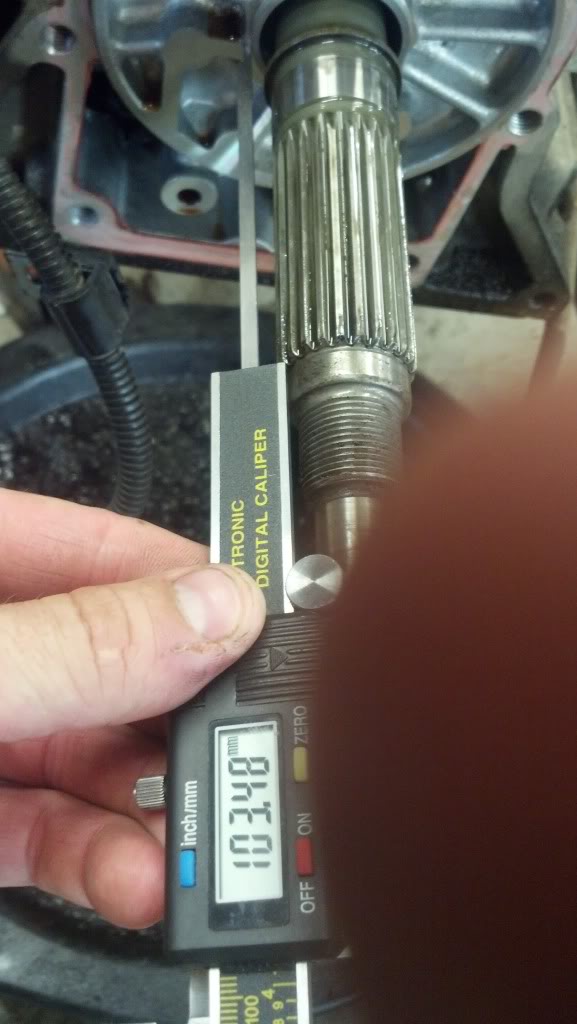

as i had expected the 4 bolt flange slipped right on
so if you were looking for a cheaper 2wd option for the uz there you go
here is the shaft from the 341e

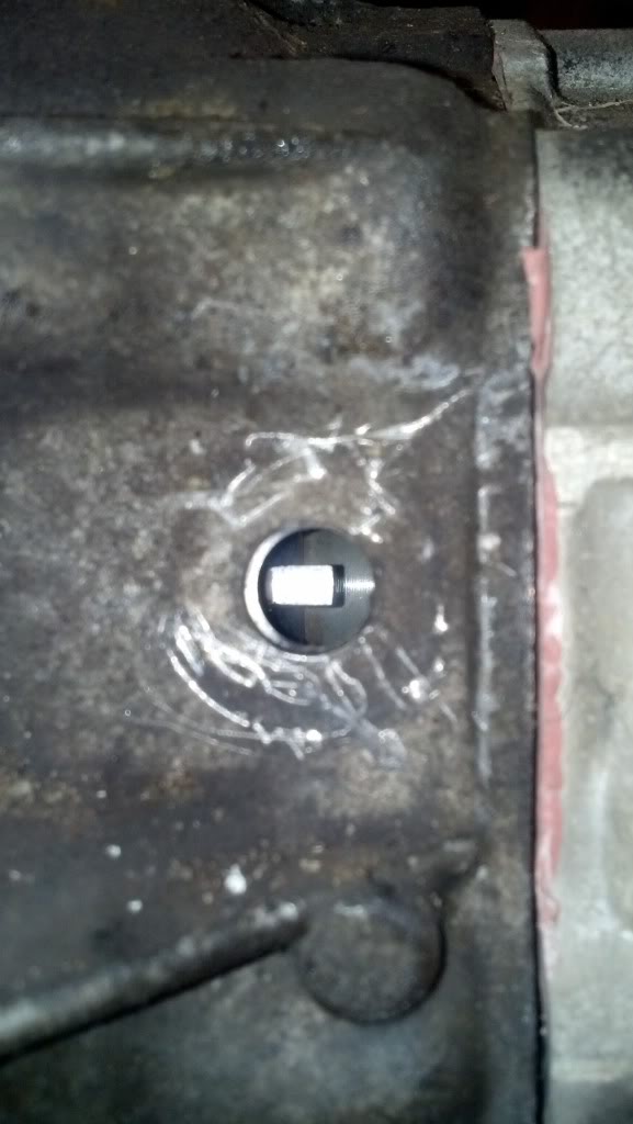

this is a view of the pickup rotor through the 340f transfer adapter
initially i was going to bore this hole out to fit the lexus sensor
341e sensor
340f
but after cutting down the shaft to fit the transfer i could no longer use the rotor assembly.
i am going to attempt to use the drive shaft nuts for my rotor signal

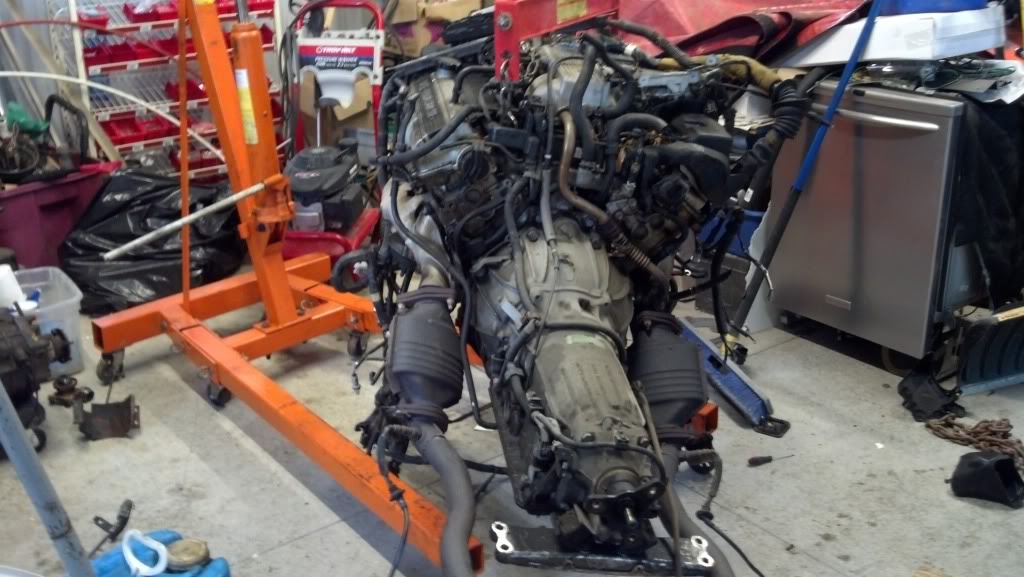

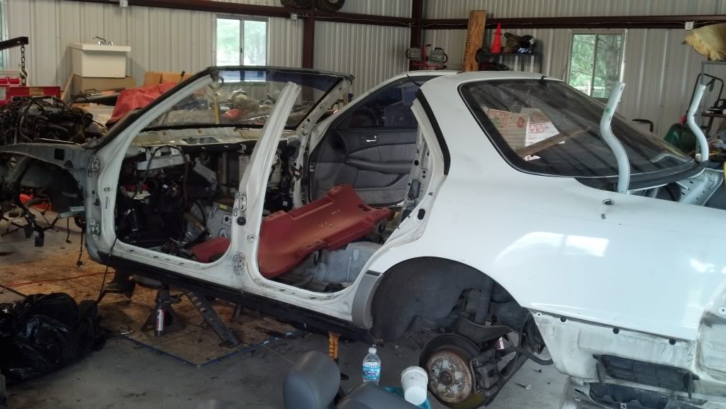

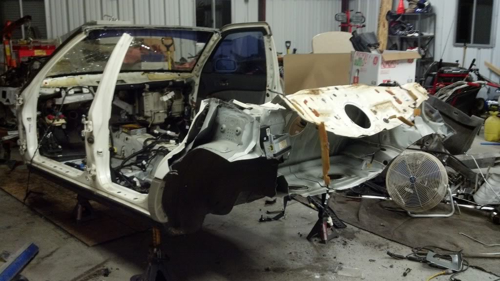

I dismantled the transmissions on july 10
i dismantled the lexus starting july 11
i scrapped the rest of what i wasnt going to possibly use or sell yesterday july 16
so about a week so far... but it is a yota so really the project is never done.
i have to do everything my self as i dont have access to a fabrication shop or a big budget
the motor looks gigantic with all the wiring crap on it

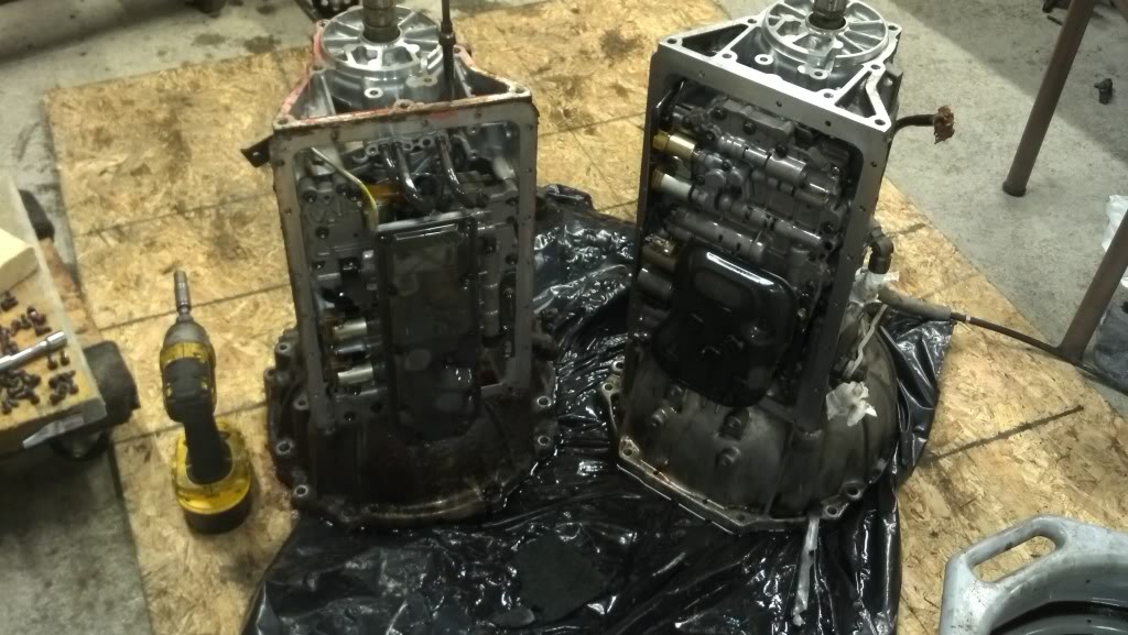

340h left Lexus 341 right
I am going Lexus 341 to 340f case using the drive shaft bolts for the rotor sensor and maybe an electric Speedo for speed sensor #1 if needed but would like to keep the cable Speedo if possible
