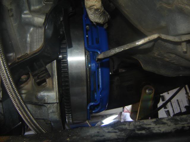

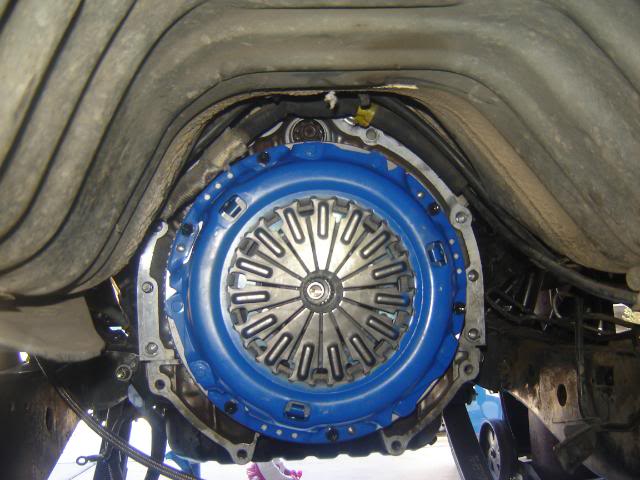

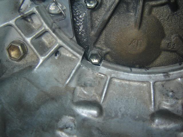

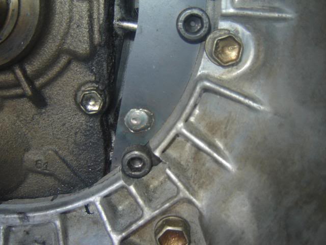

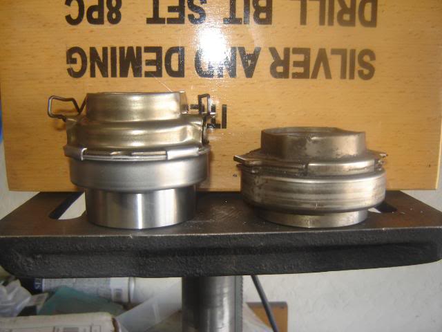

I got the clutch installed but I couldnt put the trans back in. I am using a Tacoma 3.4 clutch but I have to use a 3.0 through out bearing so now I have to order one. Hopefully I can locate one tomorrow local but we'll see. Here are the installed pics of the clutch and the through out bearing difference. I also had a few members asking about my adapter and installing the 1UZ bell housing. Here are some pics to show were I had to notch the bell to clear some of the bolts. Also notice I had to use some hex bolts in a few places.

Thats because its a 38lb billet steel flywheel.

This is going to be a crawler so I want the extra weight to keep the engine spun up. Most places that manufacture flywheels either build them lightweight or high torque. There is no way I was going to run a modified stock flywheel. "Modified" meaning enlarging the stock holes to match the 1UZ. I plan on beating the hell out of this thing and I'd really like to keep my legs. I wanted the 3.4 flywheel because the clutch disc is bigger.

What is that throughout bearing out of the longer one I might need to get that
