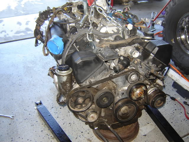

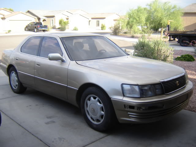

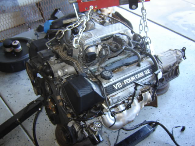

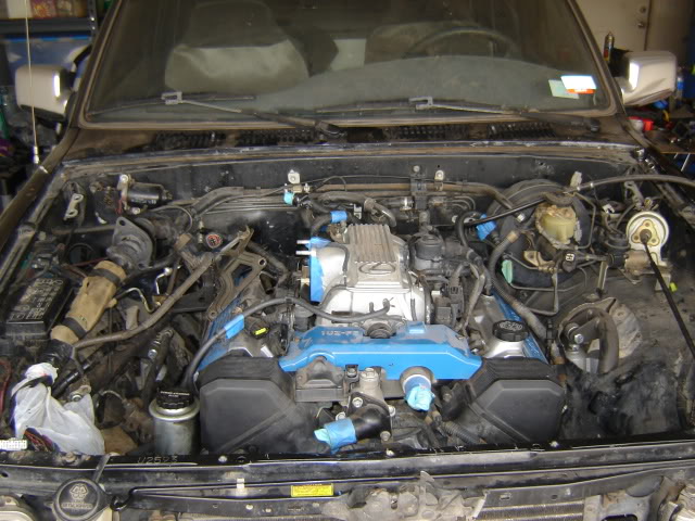

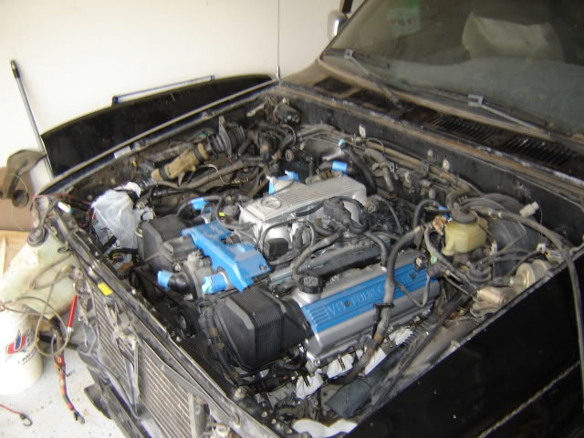

I have a thread over in the SAS section but thought this portion should be over here. I bought a 1993 LS400 for $550. Got it running before I removed the engine. I will be using a R150 with duals. I will be buying a adapter from New Zealand and modifing a stock 3VZE flywheel. Here are pics of the truck, car and motor. More to come.

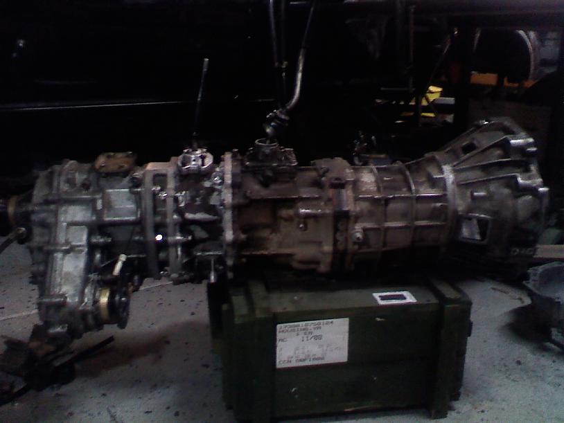

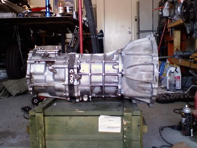

Still gathering parts but got enough to start fitting the engine. I picked up a bell housing adapter from a guy over on Lextreme and I got a V6 to gear drive T-case from a local guy.

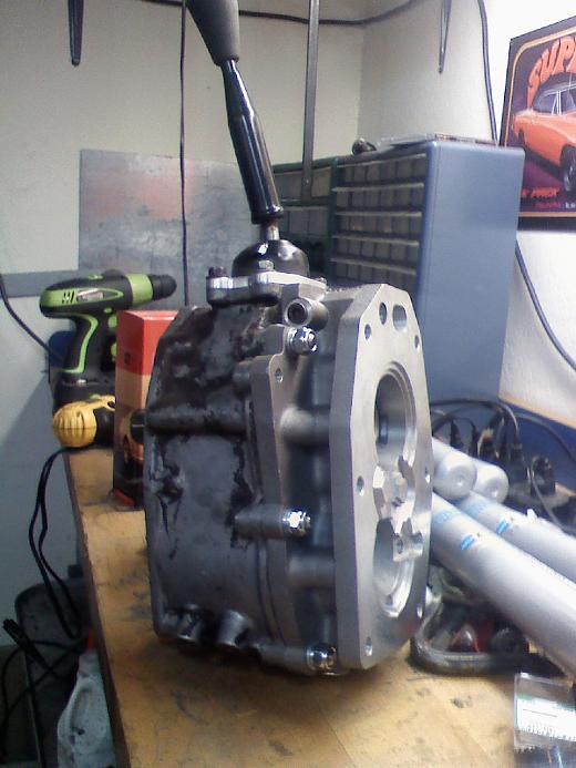

Wife got me a 23 spline dual adapter for xmas.

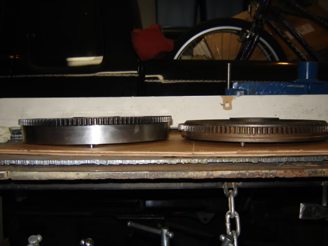

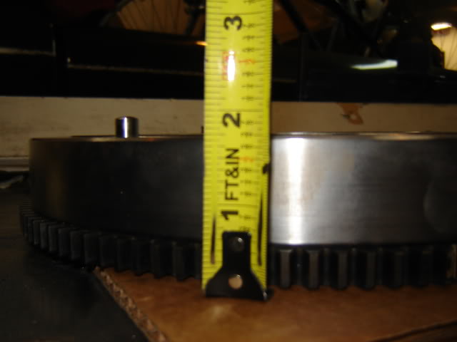

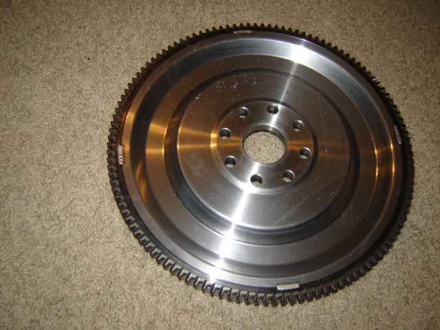

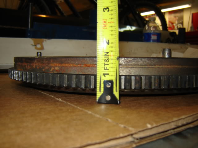

I have been in touch with John at LC Engineering. I put a $200 deposit on my 38lb flywheel. I sent them my flexplate and spacer to get the measurments. The ring gear on the 3VZE and 5VZE are the same as the one on the 1UZ flexplate. Since LC already makes a 38lb flywheel for the 5VZE they are just modifing one to to fit my application.

Got a phone call from UPS this morning saying I will have a package from LC Engineering being delivered today. Sure enough 3 hours later I had 38 lbs of pure sexy delivered to my doorstep. This thing looks awesome.

Took the engine out and made a stand for it. I'm working on my triple shifters and clutch set up.

So your using a modified 5vze flywheel, do you know what was done to it exactly to fit your application?
Old Mar 3, 2010 | 03:01 PM
toy4whatever's Avatar
Joined: Oct 2006
Posts: 207
From: Buckeye,AZ
They had to drill the bolt holes to match the 1UZ and move the ring gear closer to the engine side. The 3VZE and 5VZE share the same bolt pattern but the 1UZ's bolt pattern is a little bigger.

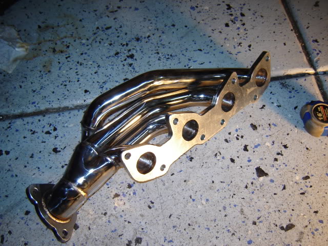

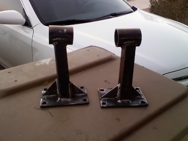

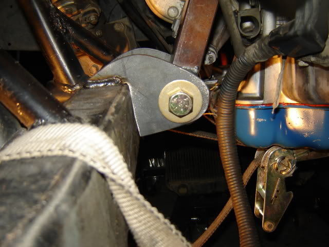

My engine mounts and headers came in the mail this week. Got the engine mounts completed and the headers in today. Headers are for a Tundra.
