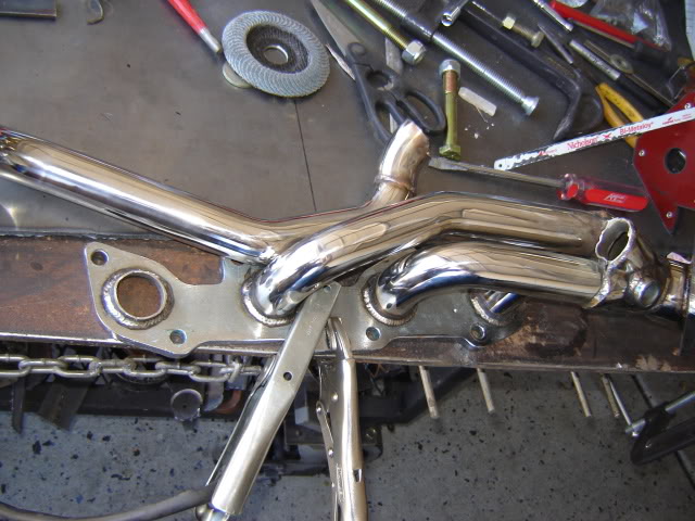

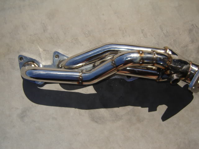

I decided to modify the driver side header to clear the steering.
Here are before and after pics.
BEFORE
AFTER

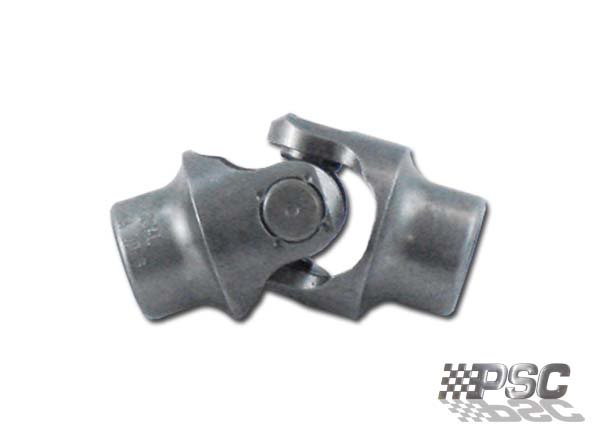

I will be replaceing the stock rag joint with one of these.

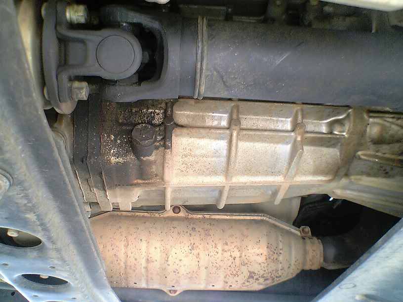

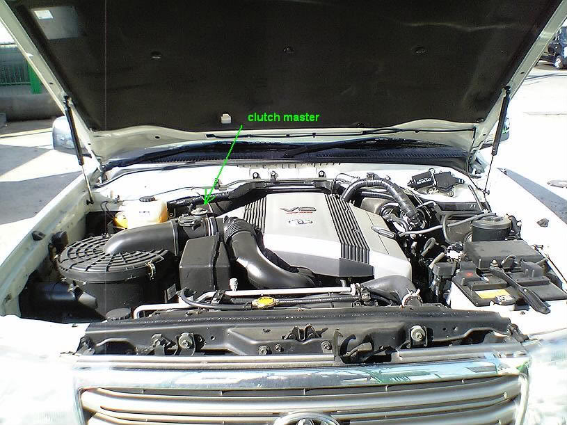

Have you guys seen this ..
H151 manual tranny behind the 2uz in Austaralia, This tranny is supposed to be here in the states just need the Bell housing from Australia.

Well that would make it a lot easier to make my auto a manual. I would what the specs are on that transmission? RMA that last picture you posted is gorgeous. I want it to just throw in my 4runner.

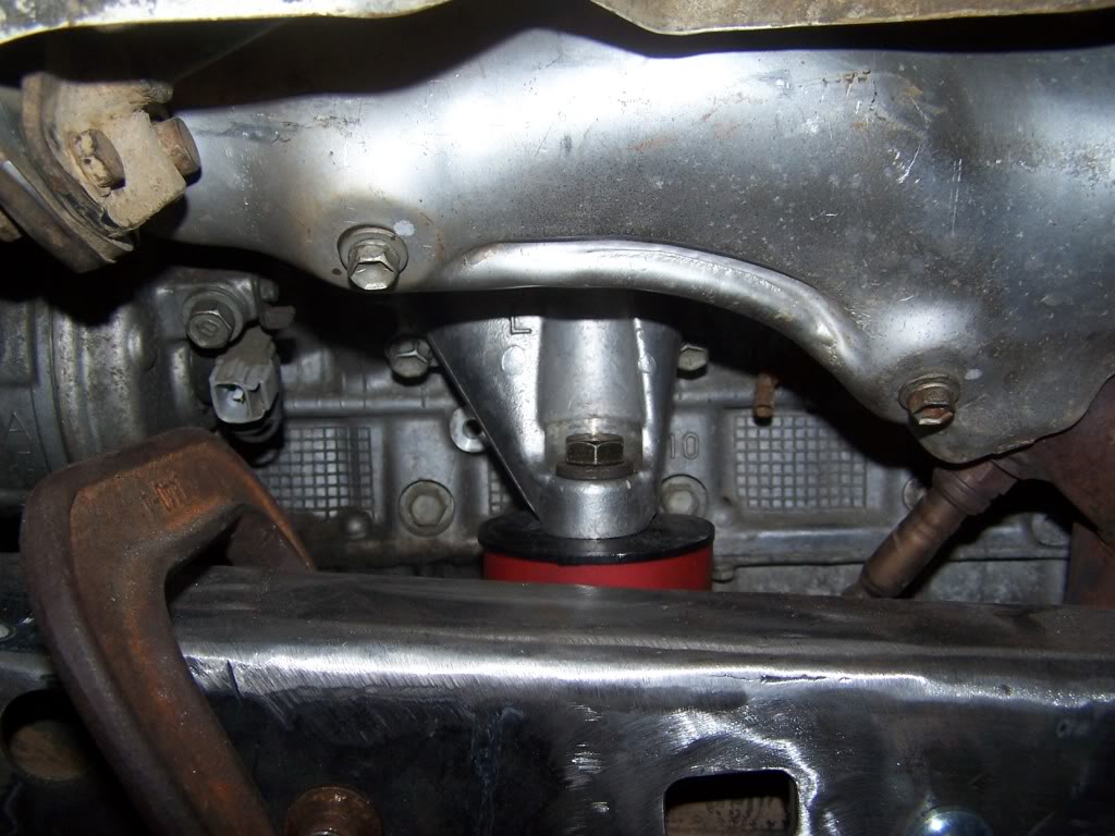

I wanted as low a center of gravity as I could get. The way I made my motor mounts I can set it up higher simply by puting a spacer between the urethane mount and the factory aluminum piece.

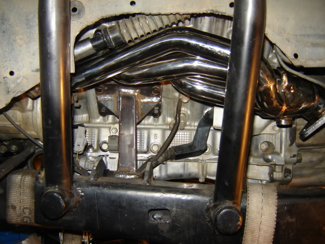

Here is the left side of toy4whatever's engine.
Here's mine.

hey man , what happened to your reworked header pics , those were great pics ..
