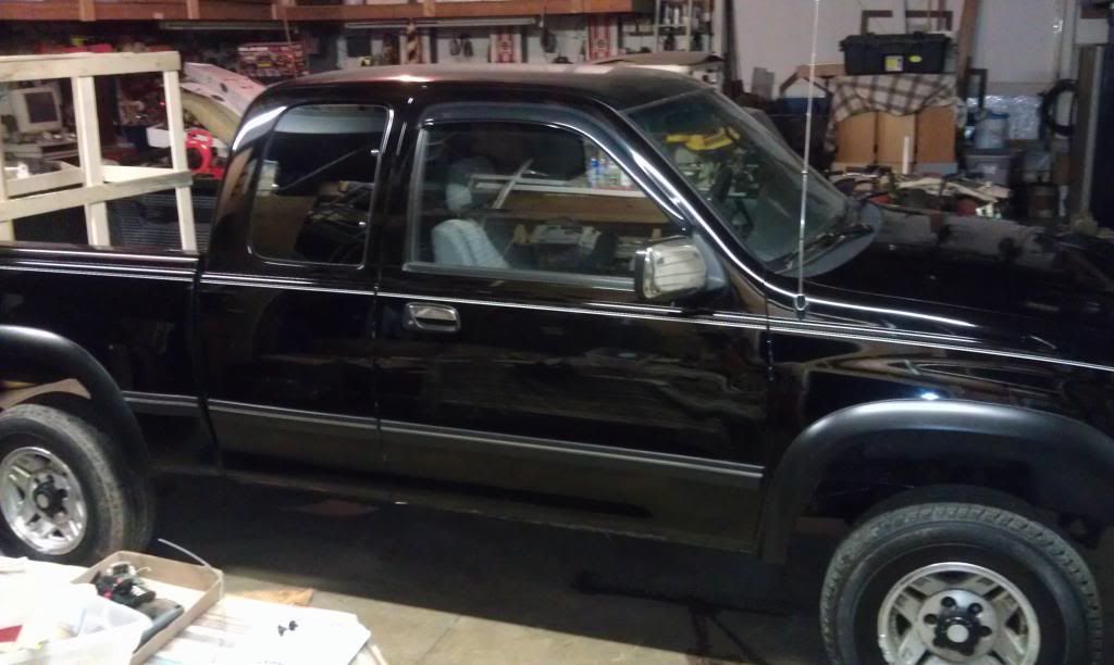

Hi I have a toyota T100 with a great healthy 3.4 in it with recent timing belt chain. I was wondering how much work a Non VVTi 4.0 V8 would take to be swapped into my truck. I was wondering what would be needed for the swap (engine mounts, ECM Ect.) and what parts would be changed and would we need any new exhaust work or anything like that. I have no problems getting a parts car to complete this swap. Thanks I would like any and al info regarding this swap ad also an estimated cost . Thx
