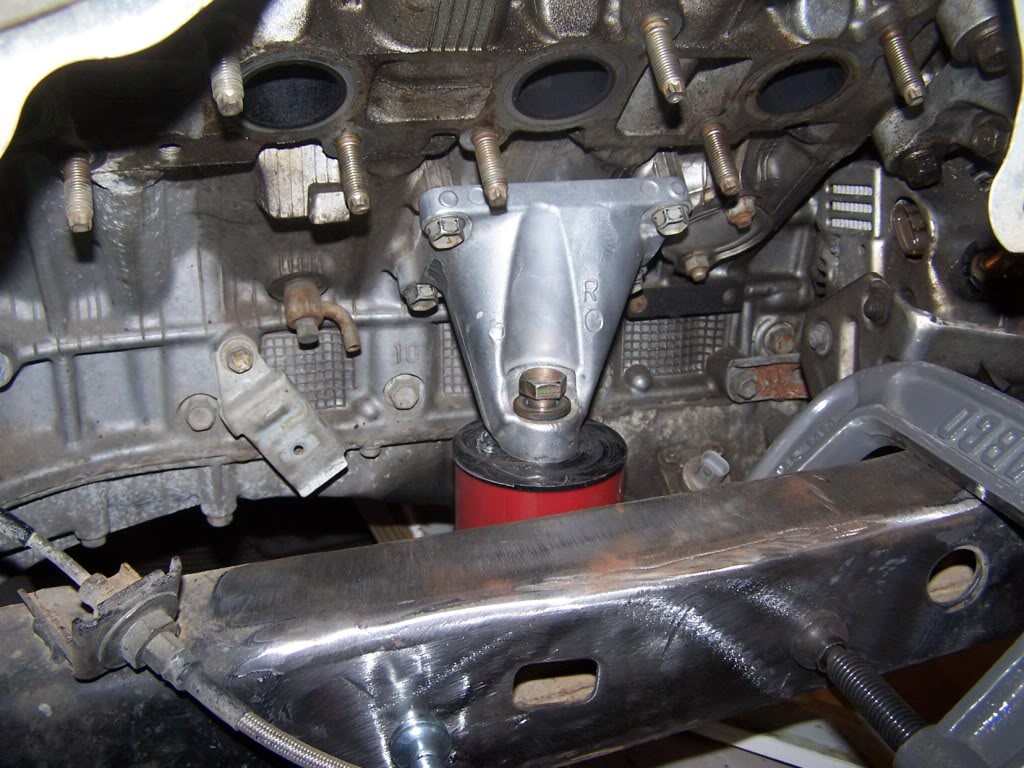

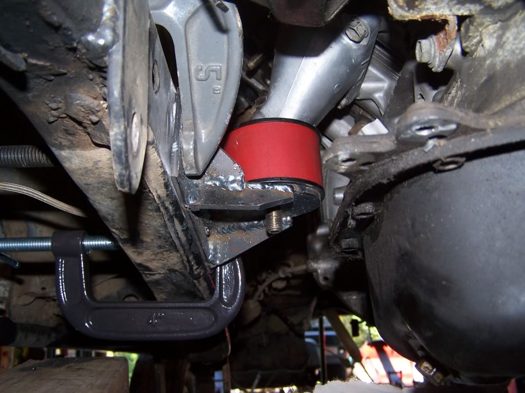

Old Sep 7, 2012 | 04:31 AM
  #139
toyminator2000's Avatar
Joined: Jan 2008
Posts: 601
From: St. Louis, MO
Here's my mounts.
Old Sep 9, 2012 | 10:44 AM
  #140
Man4God's Avatar
Joined: Apr 2007
Posts: 366
From: San Diego, CA
Originally Posted by toyminator2000
Here's my mounts.
That's the way I am going to do it when I get around to it. Having to measure all these odd angles and stuff doesn't make sense at all when the stock set up with a simple ear setup will do the job.
What size plate is that? 3/8ths?
