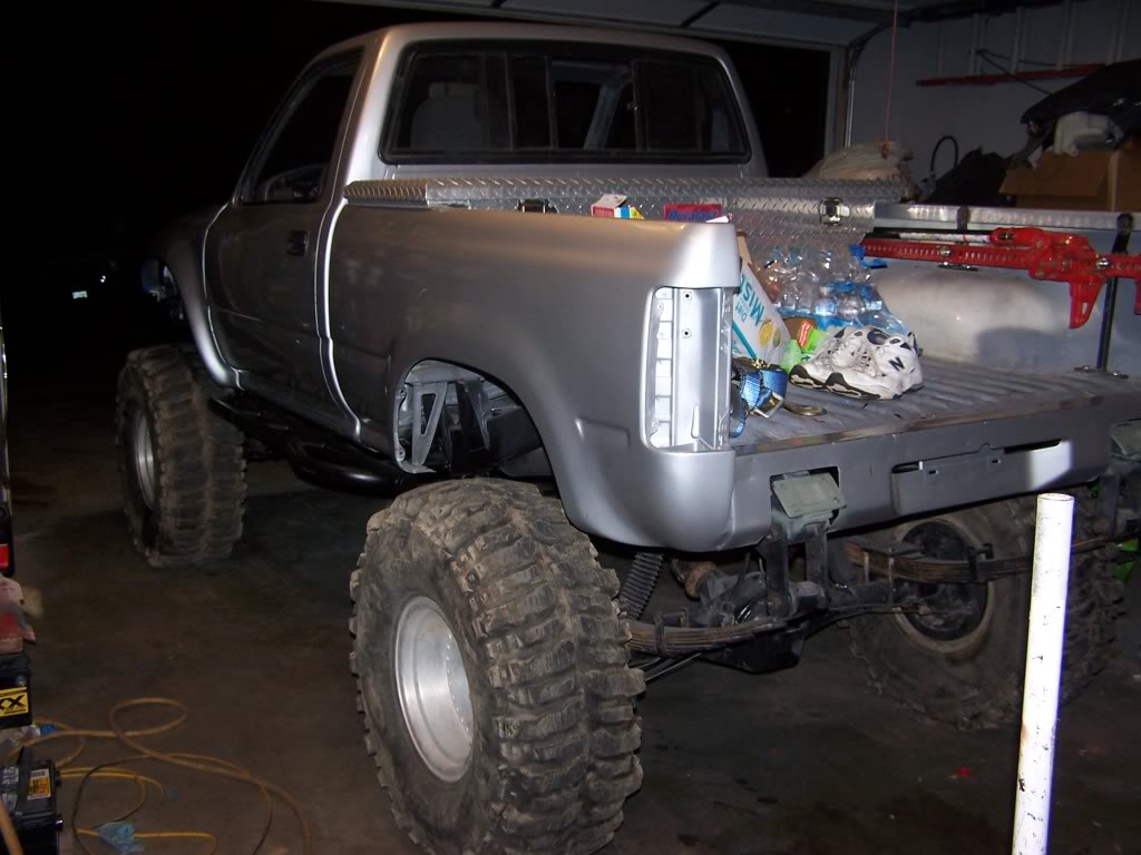

Got the truck home this weekend. Now all I need to do is get a windshield installed and I can re-assemble everything.

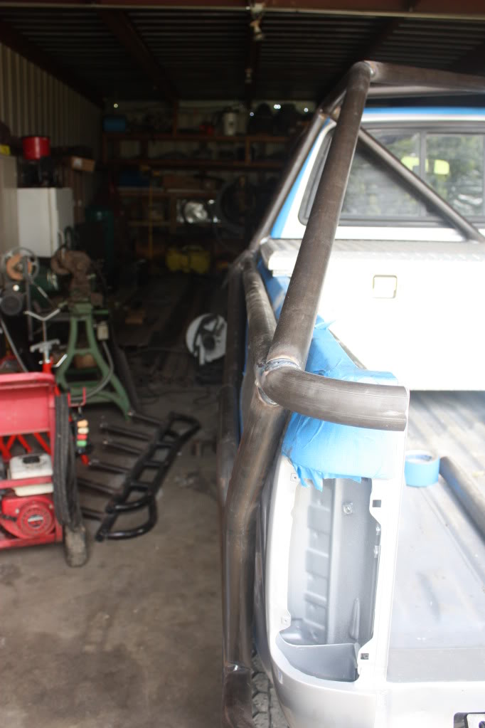

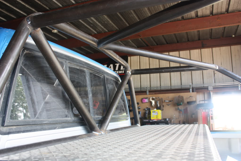

I've had a few hurdles in getting my exo cage built. the first builder I waited for several months for him start the project and once I got it to him he got it partially done and then let it sit for two months. I ended up just getting it back and had to find another builder that would build from what was already started. I'm supposed to take it to this builder this weekend. We'll see. I really wish I would have just bought the bender and notcher and did it myself.
Here are a couple of pics of the partially completed exo

Them bends are really tight, worried about flexing and getting a rub spot all over the paint? Or is there some kind of camera illusion haha. Great build btw!

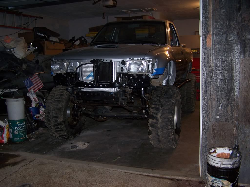

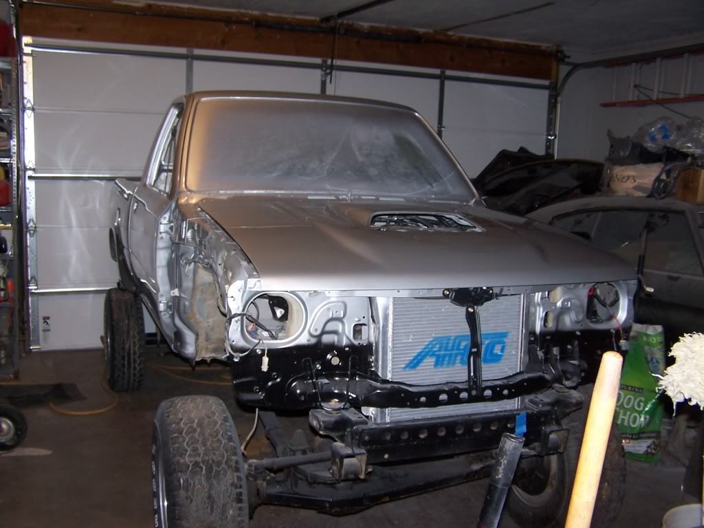

Close to being put back together.
