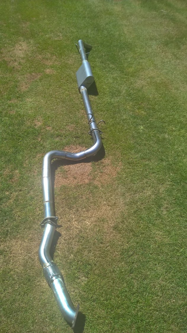

Make a new exhaust. You will need to make it from the turbo on back. I am not here yet but i will order prebent 3" pipe. On a regular cab truck you pretty much have to run the exhaust under the transmission and out the driver side. I am going to attempt to run mine out the passenger side just prior to the gas tank. Since i have an Xcab I have a lot more room to make this work.

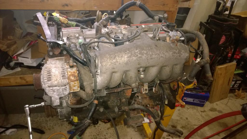

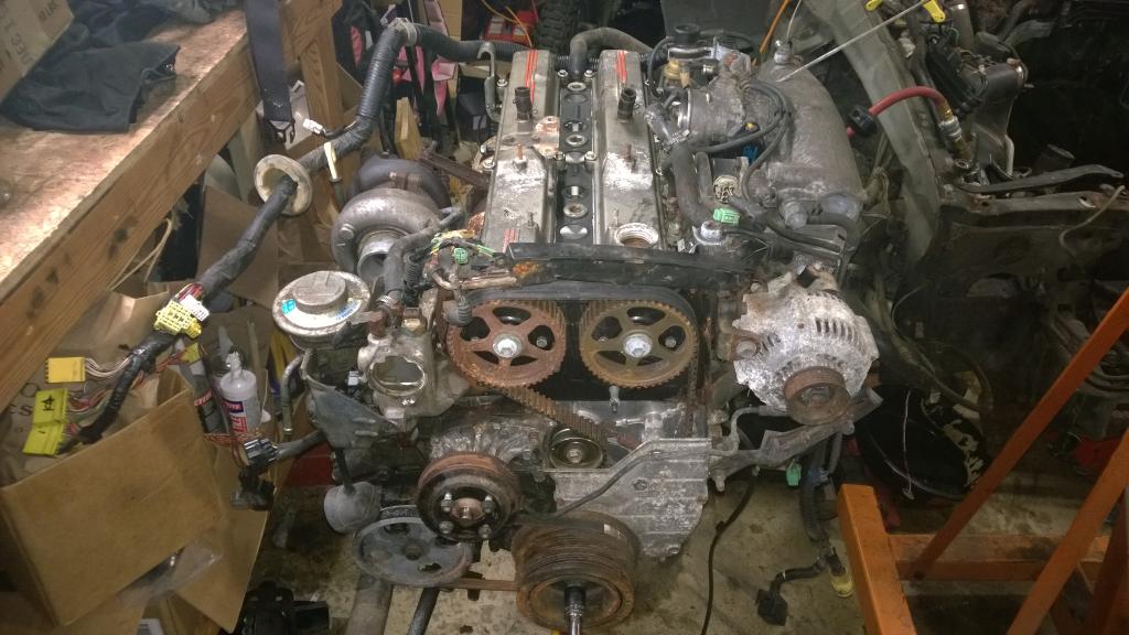

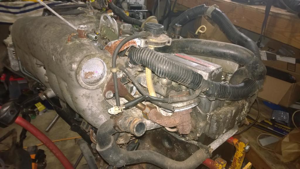

Your wiring harness looks nice and it looks like all your sensors are there. What's the plan with the motor?
Since you have it out and on a stand, I'd go ahead and put a new oem headgasket in maybe some head studs as well. With the known headgasket issues these motors have and the fact that the head is near impossible to remove once the motor is in the truck, its probably a good idea.

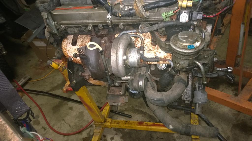

I also removed the egr stuff on mine. My egr valve touched the firewall when the motor torqued under accel/deccel and worked itself loose, creating a boost leak. Its super crammed in there, so I just decided to remove mine altogether and made a couple block-off plates. Its been running like that for 15k+ miles now.

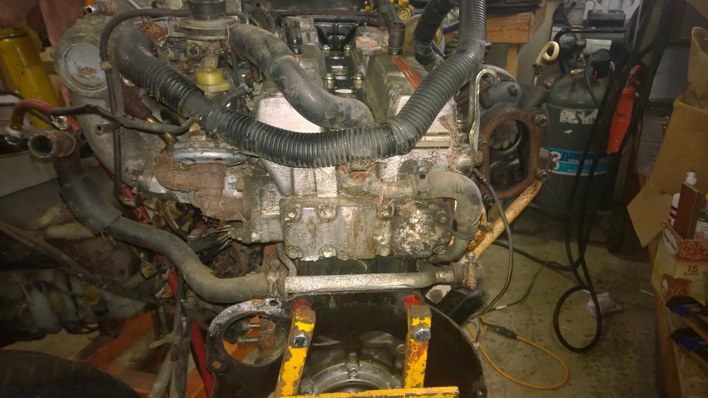

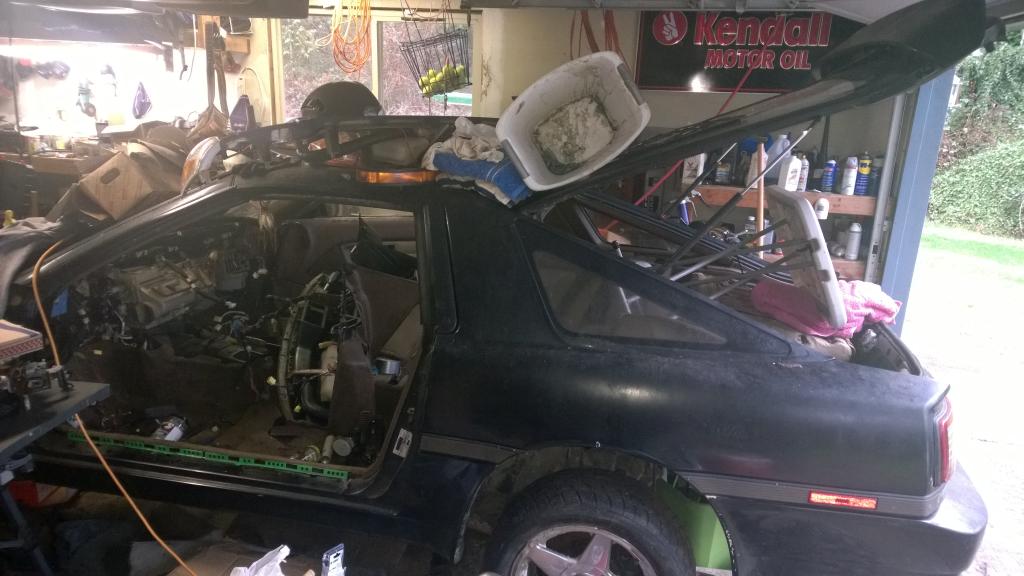

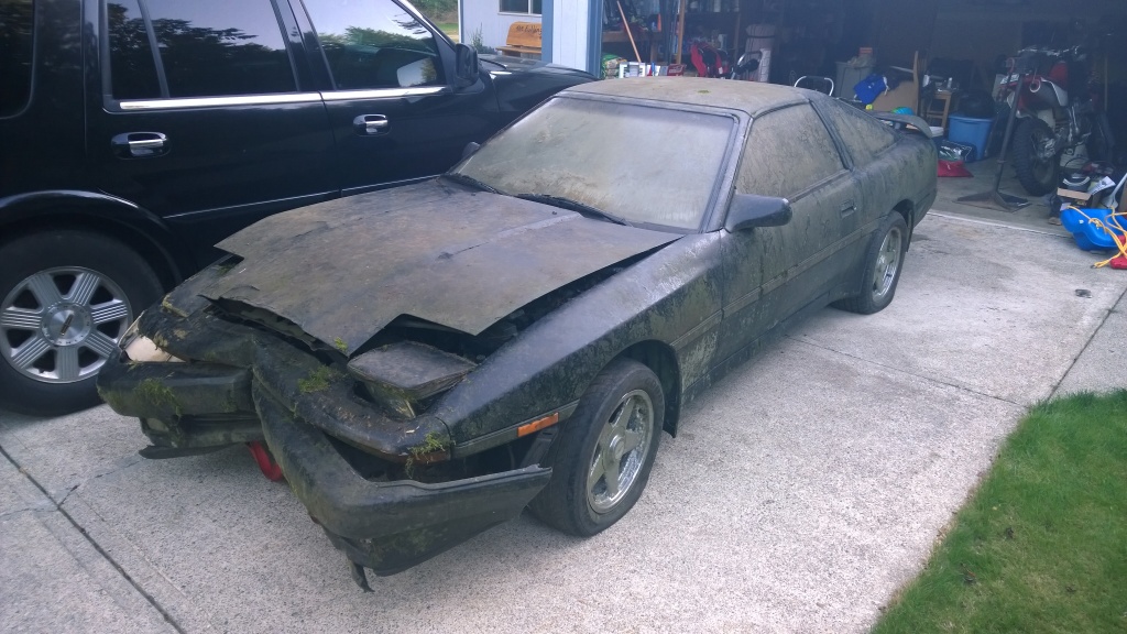

Short answer is, I bought 3 toyota supras in a group buy. This engine came from the wrecked one
and the supra is still in my garage.
Sold the other two supras to get my money back, so i basically ended up with this wrecked supra for free.
So while the engine is complete and i'm told it runs, last started about 3-5 years ago, the crash happened in 1999 or 2000 as that is what the last time the tabs were renewed on the car. Since it was front end collision, the hood was all messed up and this engine was swimming in moisture for 15 years. I have no doubt it will run, but with all the corrosion it has, I am sure gremlins are just waiting to peak out.
My friend, who has done this exact swap on his truck, figured out all the hard stuff and shortcuts. Most notably, cutting the upper radiator support off and bolt it in place (doesn't actually support the radiator, just easiest way to name it).
Before:
After:
This SIGNIFICANTLY makes working on the engine, removing and installing super easy. This was done by using a $2 spot weld cutter from harbor freight and a cutting disk. I'm told you can remove the engine in as little as an hour to an hour and a half, by yourself with this modification done.
I have not given up entirely on this engine, if it runs really well then i will fix it, like do the timing belt, head gasket, and other cleaning up kind of stuff. Since i removed it from the car, I have all the little parts, sensors, and stuff that i need to do the swap with as little problems as possible.

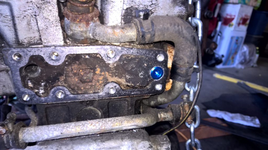

Blocked off the EGR system. Straight forward. I just cut some steel and grounded it into place.

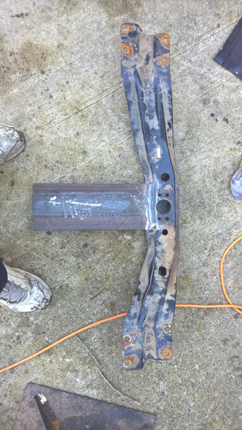

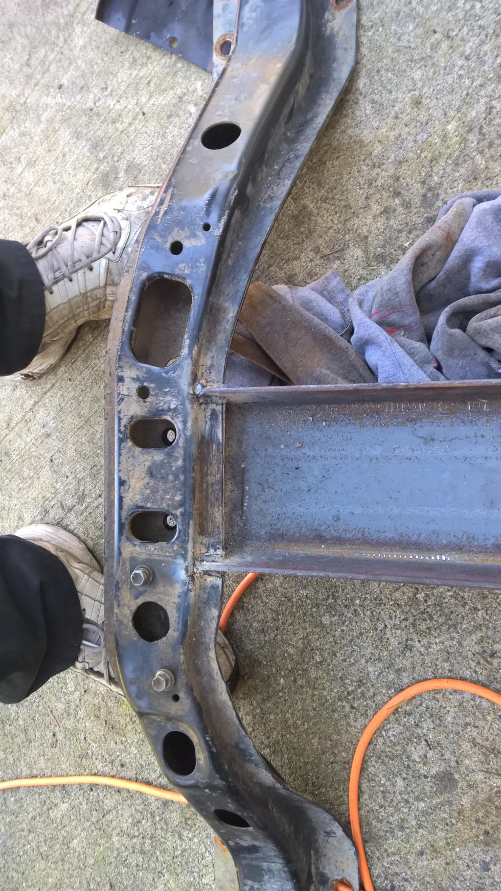

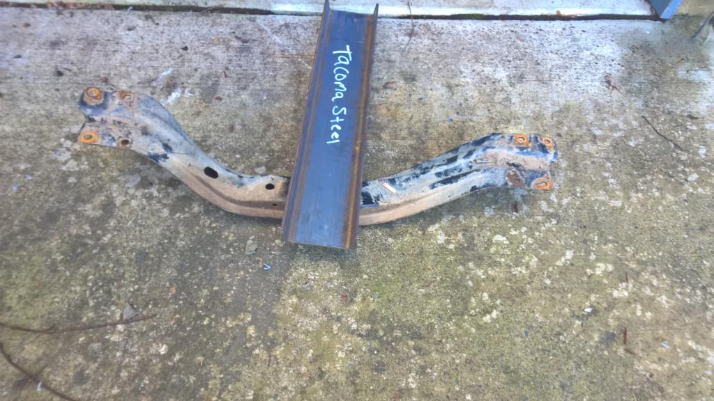

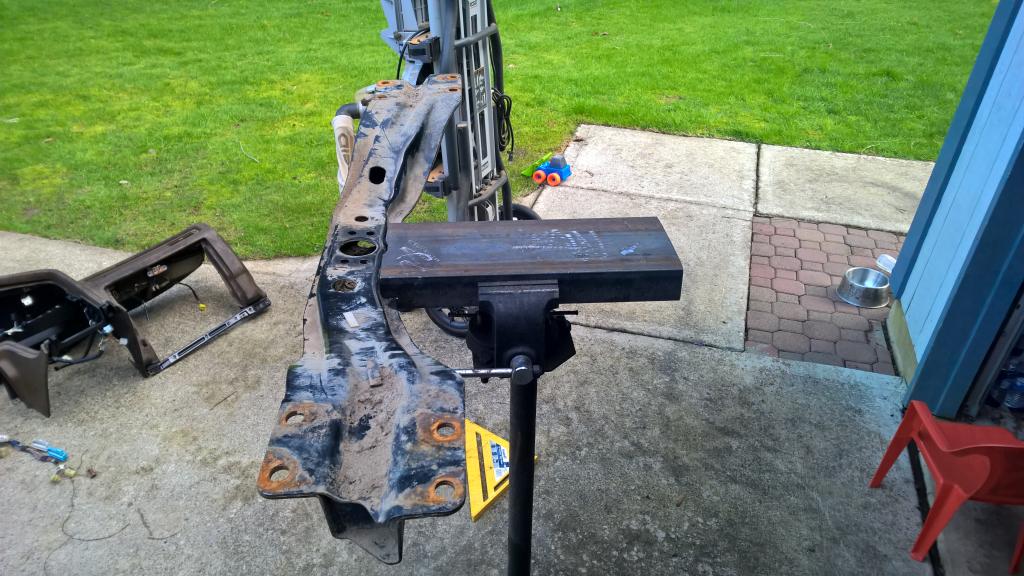

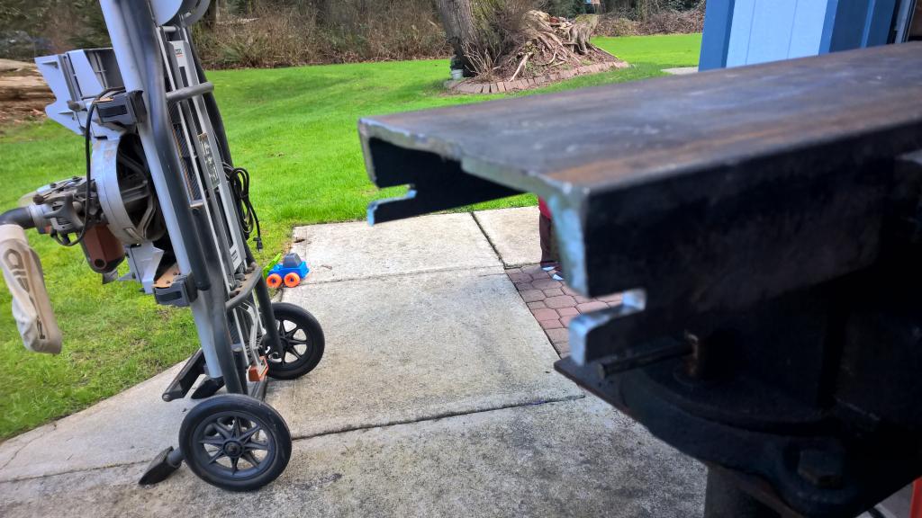

I bought some scrap metal to do my transmission mount and other things.
Ended up going with this piece of U shaped Iron to make my transmission mount.
Pics do the explaining...

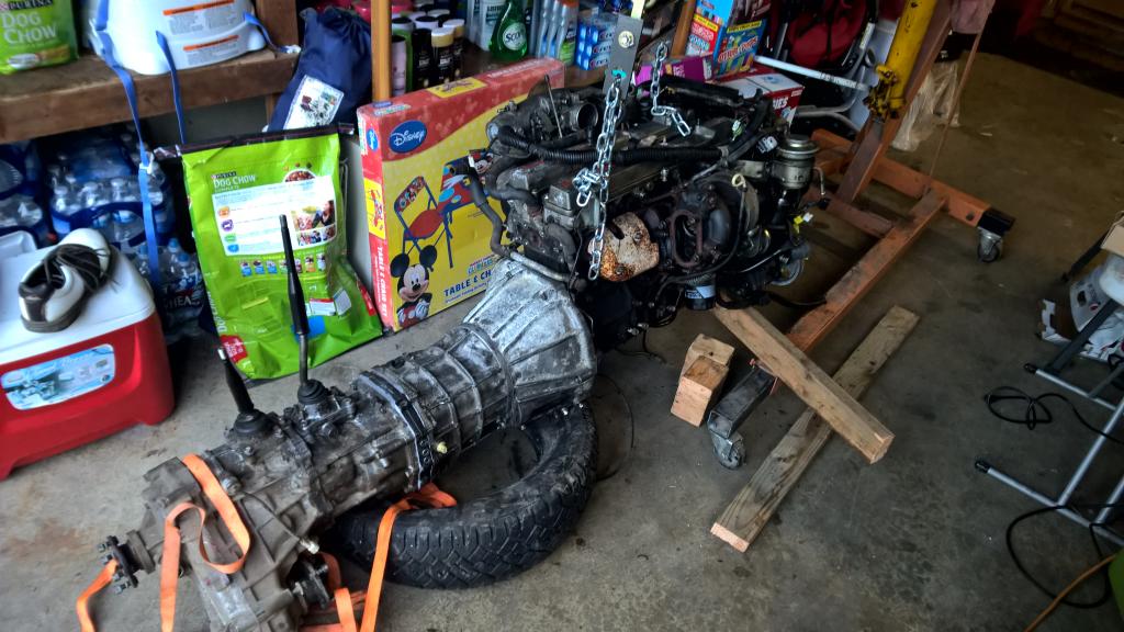

Put the clutch on the engine, used a clutch alignment tool (cheap, like $6) and had no issues.

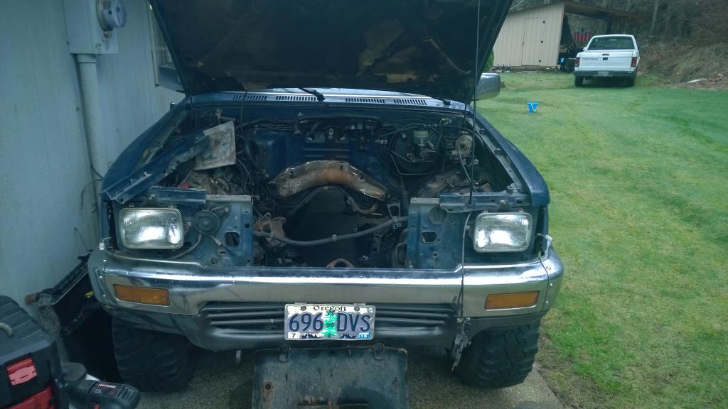

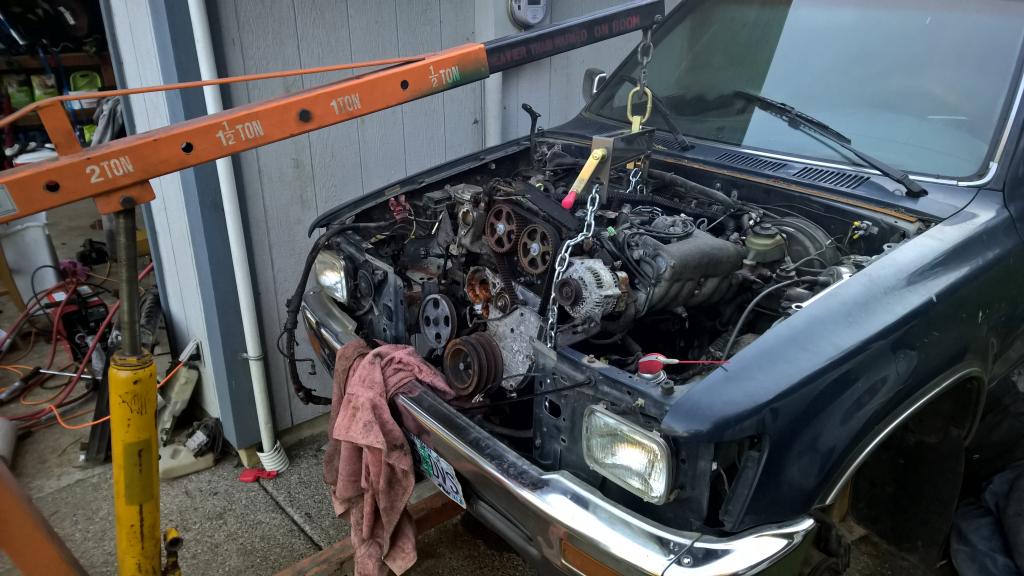

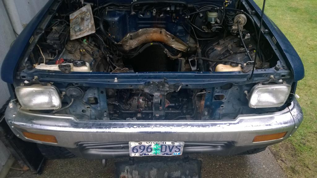

Dropping engine in the truck

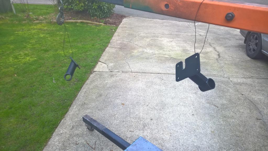

Couple things to note, My friend has made a bar out of 1" square pipe that sits on each frame rail and fits nicely between the crank on #1 across both sides of the block. This puts the engine at the exact height it needs to be. I will take a picture of it when i am done using it. It is shaped like --__--
This allowed us to put a jack under the transmission and set the engine on this bar in the front and we could move it around in there without the engine lift being attached. It made making the engine mounts, Way...Too....easy...

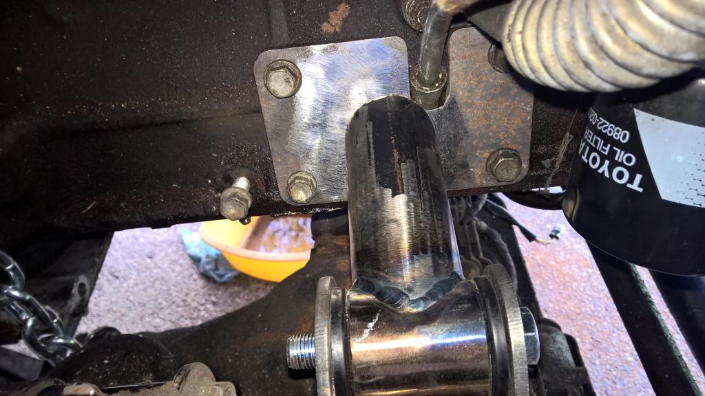

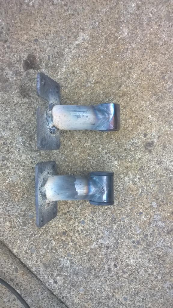

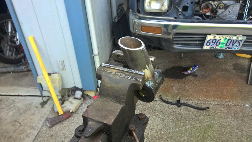

We used the standard pipe and bushing type of mount.
The tabs that we welded to the frame and the mounting plates on the engine were pre cut on his plasma table. (Let me know if anyone wants to order these, I dont think he would mind making a few $$ cutting these out.) The pipe is your standard pipe, Not sure on the size as that was all him. (engine mount bushing part #, ENS-9-9489G) Initially the pipe was almost 12" long, It ended up being like 4.5" on one side and 3.5" on the other. Lots of putting in, taking out, cutting, putting back in, taking out, grind some more, put back in...etc...
Once i got it in, I tacked it to the engine mount plate, then unbolted and removed it and welded it together
Now i have two engine mounts all done that will work perfectly!

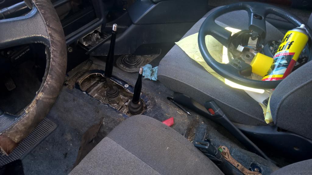

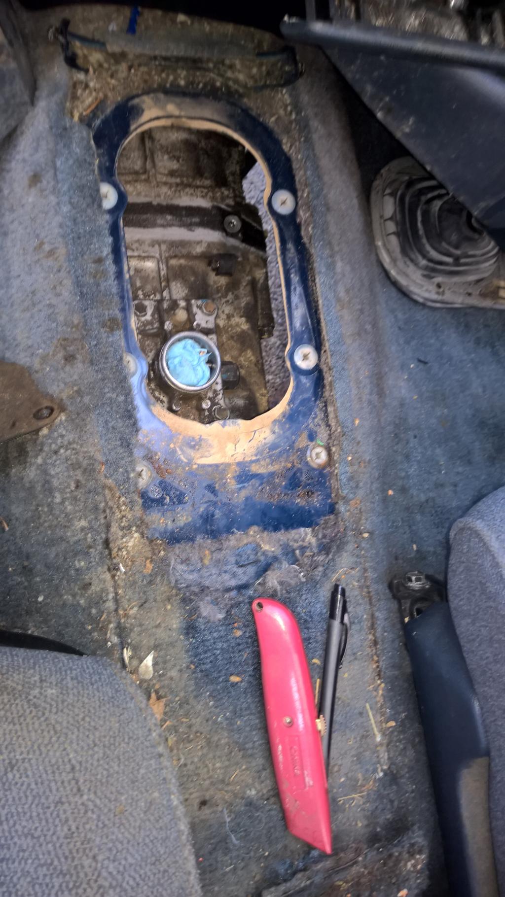

The transmission was pushed back a good 4-6" so this is waht it looked like in the cab.
a quick cut with a sawzall
and ready for action

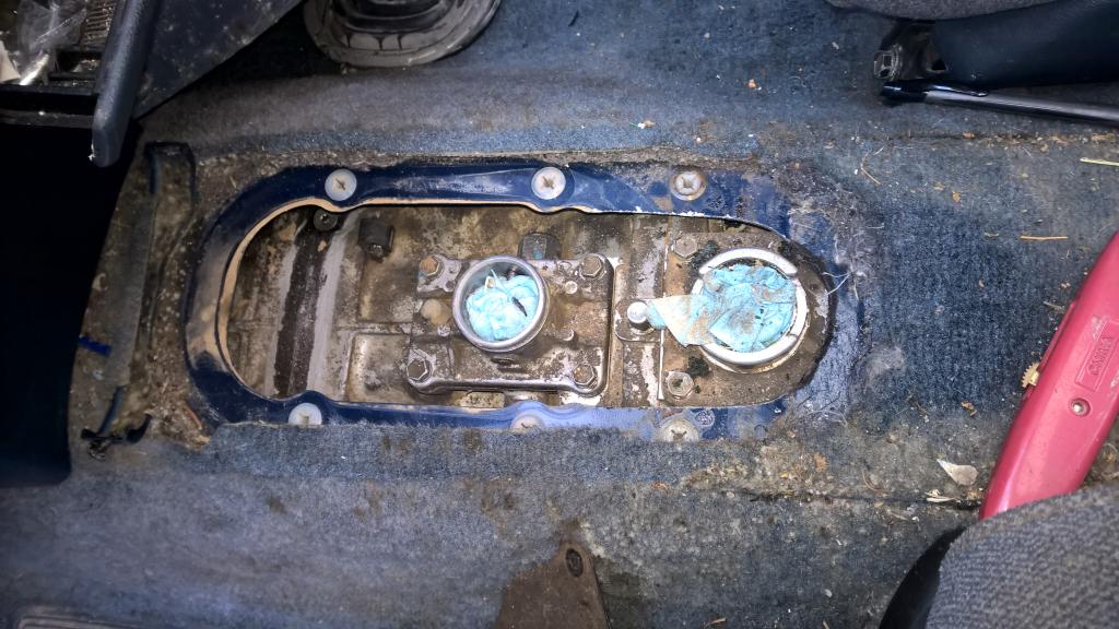

(Note, we bent the shifter to make it more straight, stock is bent backward a good amount which when pushing the transmission back, would put the shifter at your elbow vicinity, hard to shift like that.)

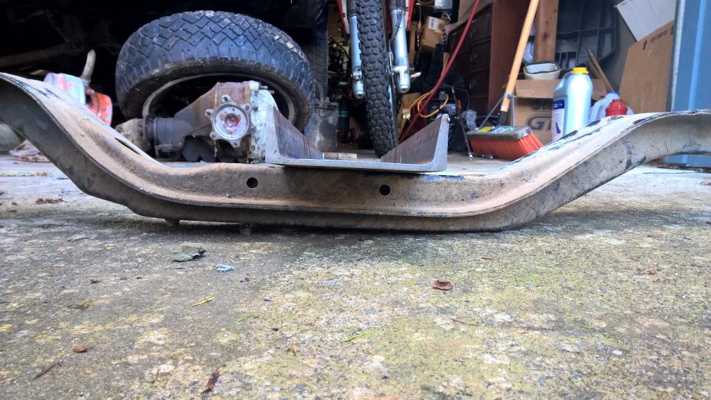

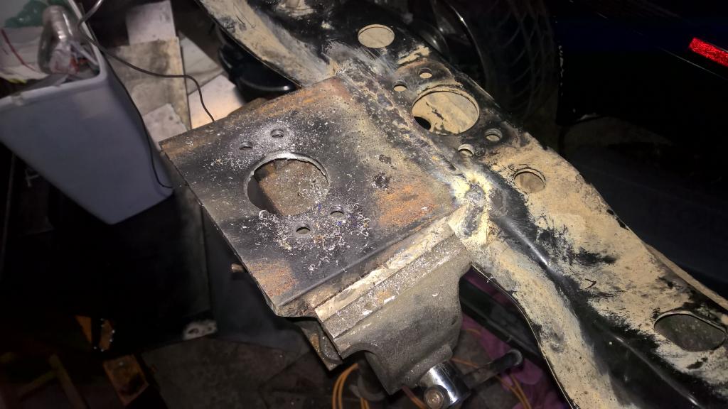

Bolt up the engine mounts and make sure your transmission is centered. I bolted up the transmission crossmember so the bottom round thing was flat on the support. Then i used some spray paint to mark its location. unbolt the crossmember and set in vice for cutting/drilling.
Note, My hole saw bit got bent while driling because it just happened teh thickness of material and the distance between the tip of the drill bit and saw part were identical, in wood that's no problem but in this case it made the drill bit snag and bent it out of alignment. Had to use a different drill bit to finish the pilot hole before continuing...after trying to bend the bit back in alignment, I went for it. instead of a 2 1/8" hole i think i ended up with more of a 2 1/4" inch...anyway. dont make my mistake, pre-drill the pilot hole.

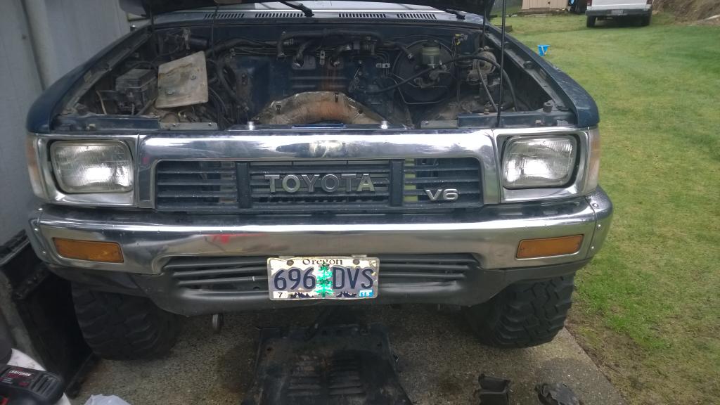

for reference, here is a before shot
I also cut off the excess support that i no longer needed. (wasnt a square cut but no one will see it under the truck, unless i end up upside down. On second thought, maybe i should square that up....)

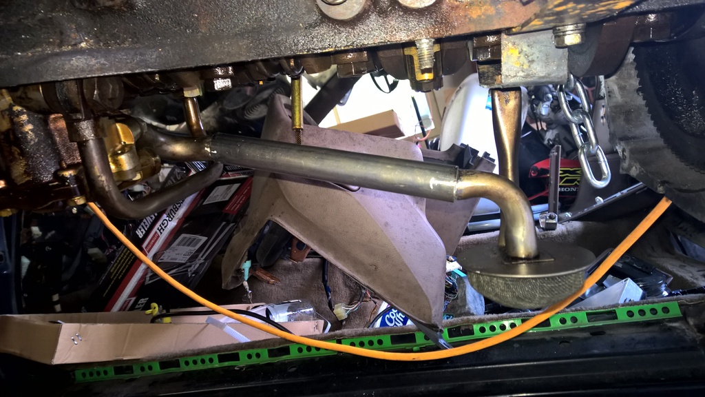

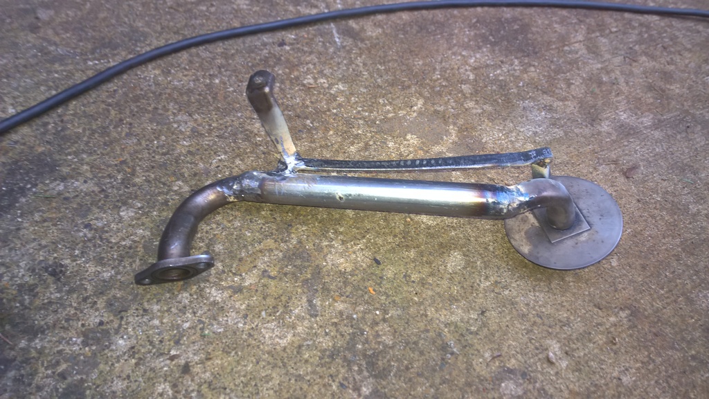

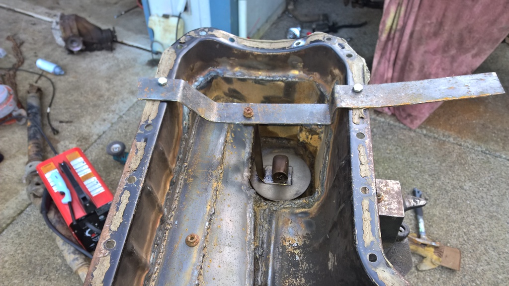

My oil pan was horrible. It leaked and i met my match. I ended up taking it to a local welder and they had to go over every single weld with a TIG to get it water tight. I had to make the oil pickup which was pretty easy actually. I use scrap metal to make a bracket that i could bolt to the oil pan which i could then bolt the oil pickup to where i wanted it to be.

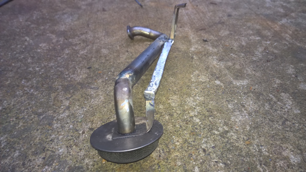

Then i bolted the bracket to the corresponding bolt holes on the block so the pickup would still be located in the right place. I cut the pickup tube in half so i could bolt the one half to the oil pump and the pickup side to the bracket. Then cut a tube to weld in between.
Then remove the bracket and built a support to bolt into the stock support location.

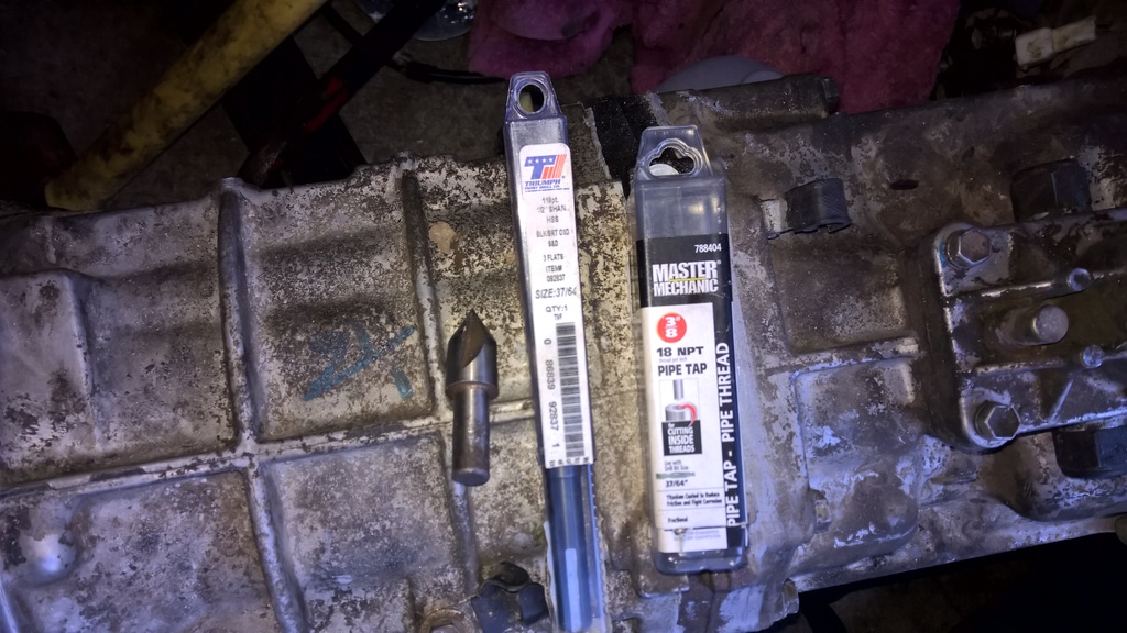

I also finished the EGR delete by drilling out the exhaust hole, putting 3/8" threads in it and screwing in a 3/8" aluminum plug
Needed these tools

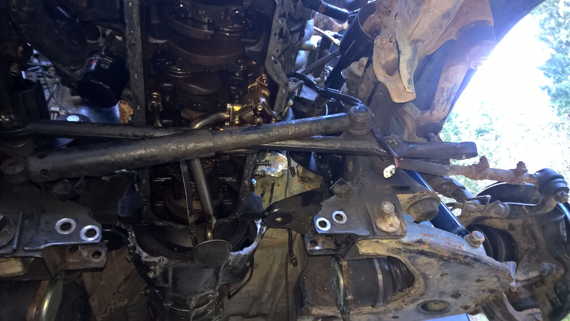

Oil pan...Take the time to do this right. Bolt in the engine to the truck with oil pan. Cut oil pan so that Differential fits. (best to remove CV axles so this is a 1 person job). Use heavy poster board and tape to make your template for the oil pan. Then you can remove the differential and the oil pan. The oil pan is removable from the engine with the engine installed! You just have to unbolt the differential cross member and one bolt from the steering bracket. Now weld up your oil pan. DO NOT USE FLUX CORE WELDING WIRE. just dont even bother, If it is all you got (IE, ME) just use it to tack everything in place and hand it over to a professional to make water tight.
Now you can have your engine installed with oil pan and bolt up your front differential.

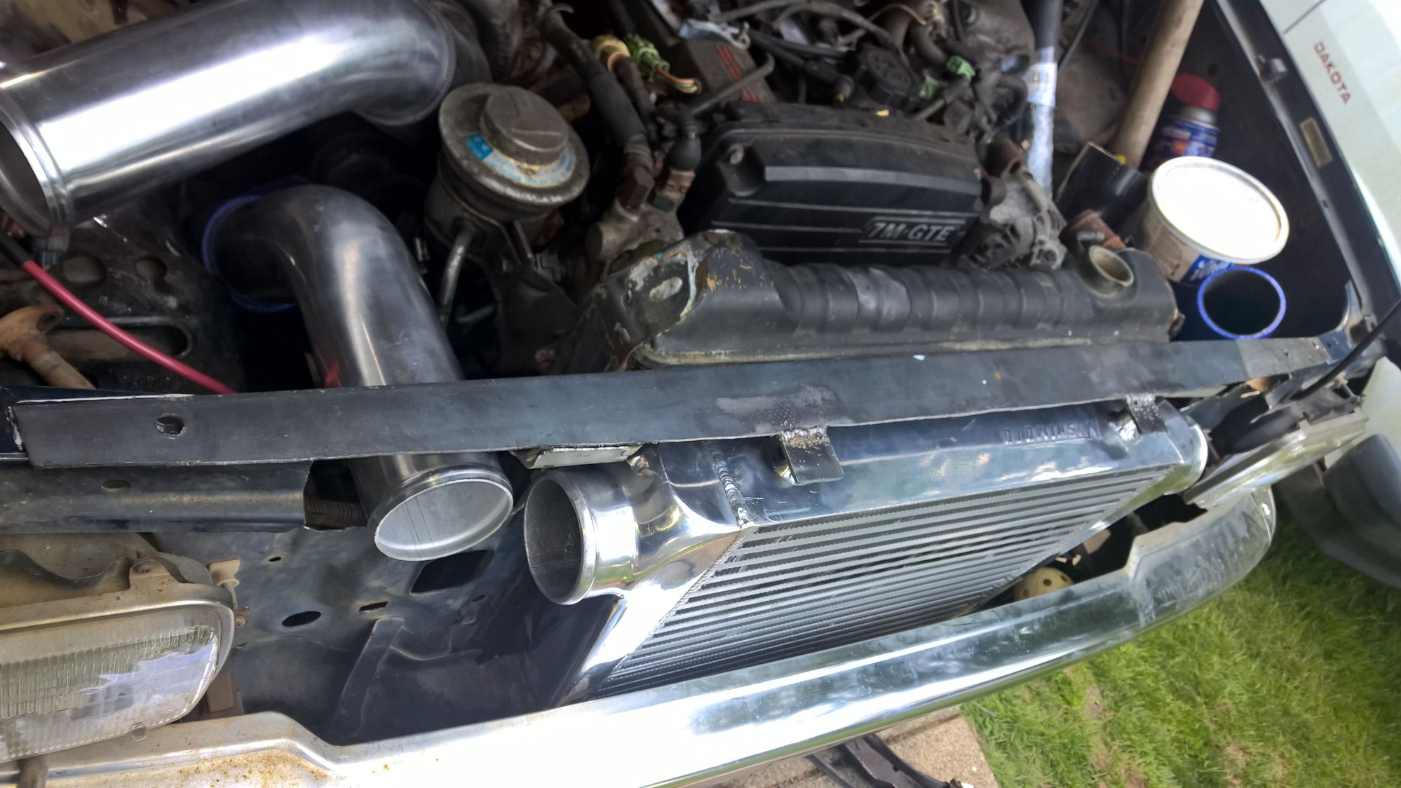

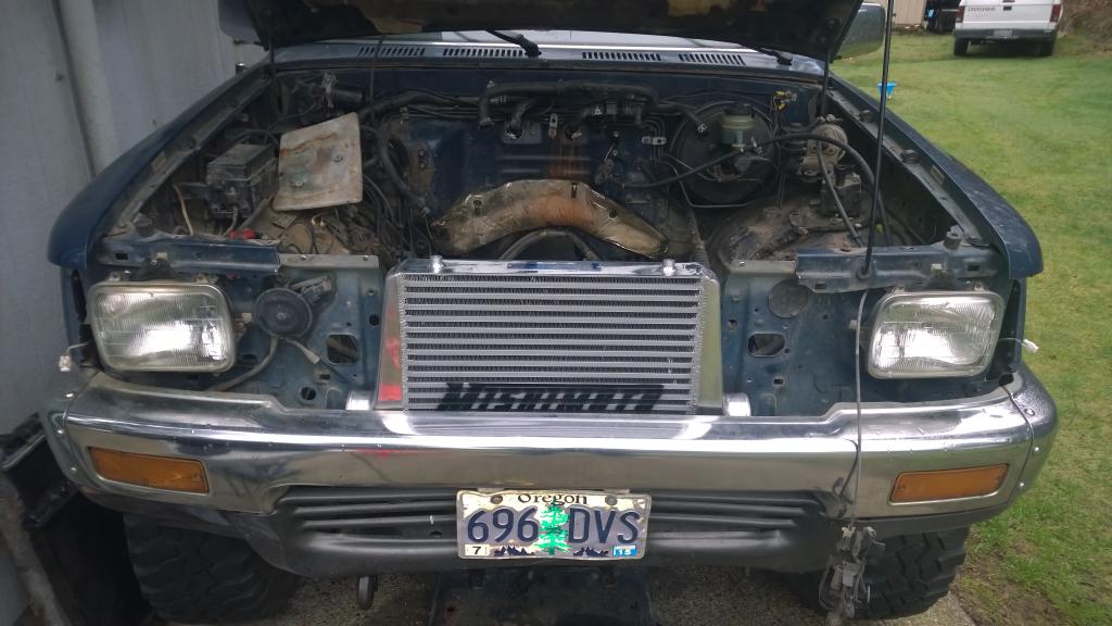

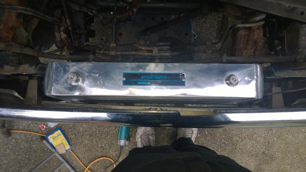

Route your intercooler. I am bolting my intercooler in front of the radiator. This requires making a new radiator support crossmember. It also will require hood pins as the latch mechanism is now displaced by the intercooler.
Luckily i was given a radiator that had the input/output holes moved to whre they work with the 7mgte engine. You can use the stock truck radiator but you have to get creative with hose routing.

Made the exhaust. Going to weld it up this weekend. (it is tacked only right now.)
I also finished up the radiator cross member. Have a long list of things to accomplish but they are small like putting hose clamps on, fluids, and other misc projects that should take 10-20 min each. It all adds up but there is very little fab work remaining.

- Exhaust welded and installed

- Painted radiator crossmember
- Installed intercooler and radiator

I didnt mention this before but i was pouring oil out the back of the engine in the bellhousing. I thought it was the rear main seal. I decided to pull the engine (and transmission together cause its easier). That was fun. Anyway it ended up being the oil pan was too warped to seat on the block so i had to remove the oil pan, put the engine on the engine stand and pound the oil pan into mostly straight. It doesnt leak anymore, but what a pain the ass...
My high idle was the Idle Air Control Valve (IAC) being stuck open. I took it apart and cleaned it up. It is now stuck closed...oh well. It doesnt idle worth crap but i can drive it.
I took it for a drive and wow. What an amazing feeling. Engine sounded great. BOV worked flawlessly and i was having a grand time. This was 10 at night. Instead of just getting gas and straight home i decided to keep driving...well, I was doing a 3rd gear pull. Boost building up then boooom! I pulled over and checked the engine. Sounded like an intercooler pipe came off. Ended up being the case but i couldnt see it in the dark. What was concerning was the turbo and down pipe was bright red!!! That cannot be normal! I got it started right away, it would run in low rpms...I wanted to keep oil and coolant flowing in the turbo to try and save the bearing. I think I was successful.
At home, under lights i got the intercooler piping hooked up and drove it to work the next day. IT ran like crap and when i would check the engine it looked/felt like the turbo was running wayyy too hot. It felt like there was no low/midrange power and lots of backfiring and almost stalling. I have a number of things to check but i am worried that the engine was running rich/lean and something got broken. Turbo sounds fine but it seems like boost is leaking or something. Hope to get it figured out on Sunday.
