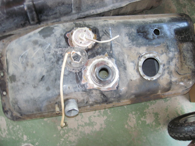

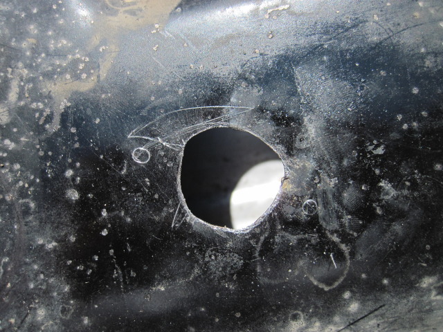

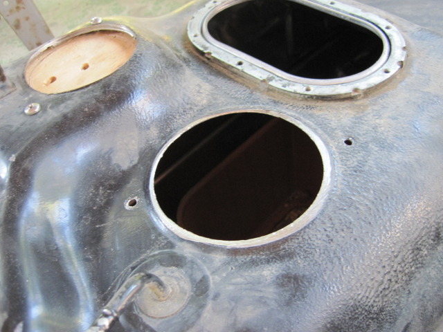

Most of the things I did on this swap was a first time for me. I didn't get the exhaust done because I just didn't have the skills or tools to do so. Same was done with the tank.
I had a buddy help me with it because he knew what he was doing.

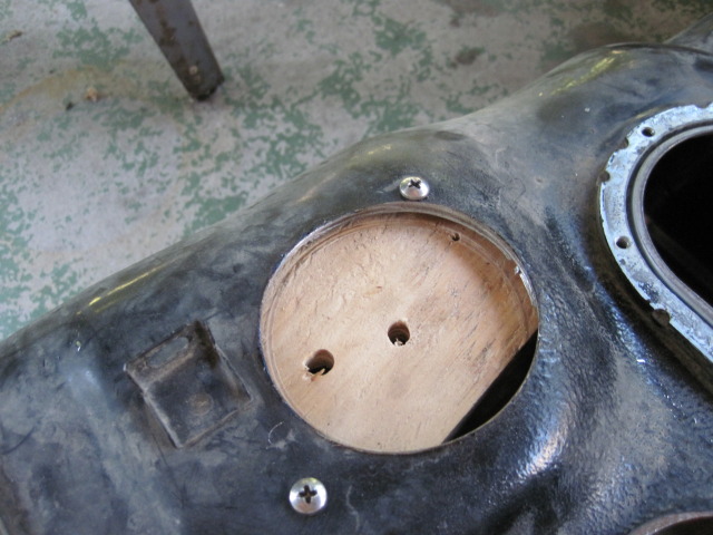

We first attached a piece of wood to the bottom of what we were going to drill out with the hole saw. (pictures are of the aftermath)

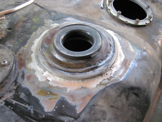

Clean the paint off of the tank and new piece you just cut out. Use a hammer to get the smallest gap possible. Apply flux and heat up with a propane torch. Feed the soldier as soon as it melts on the metal.

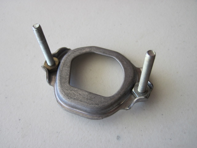

If you look at how the pressure sensor it is mounted to the 5vz fuel pump. You have to take the pump out to get to it. I didn't use the 5vz pump, but kept the old pump. So I had to have bolts come out to the tank so I can secure the pressure sensor.

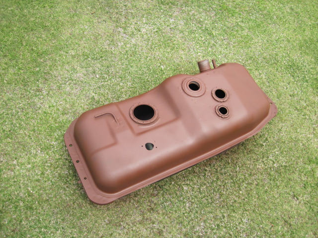

Prime:

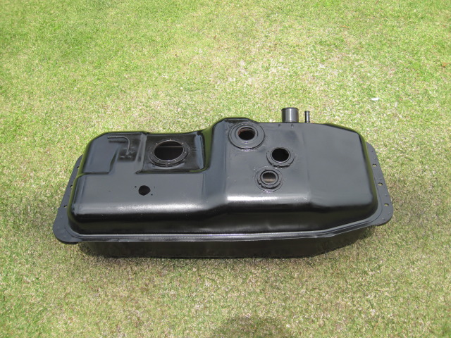

Then paint:
I'll throw one more coat today and rinse the tank out tomorrow and mount her up.
