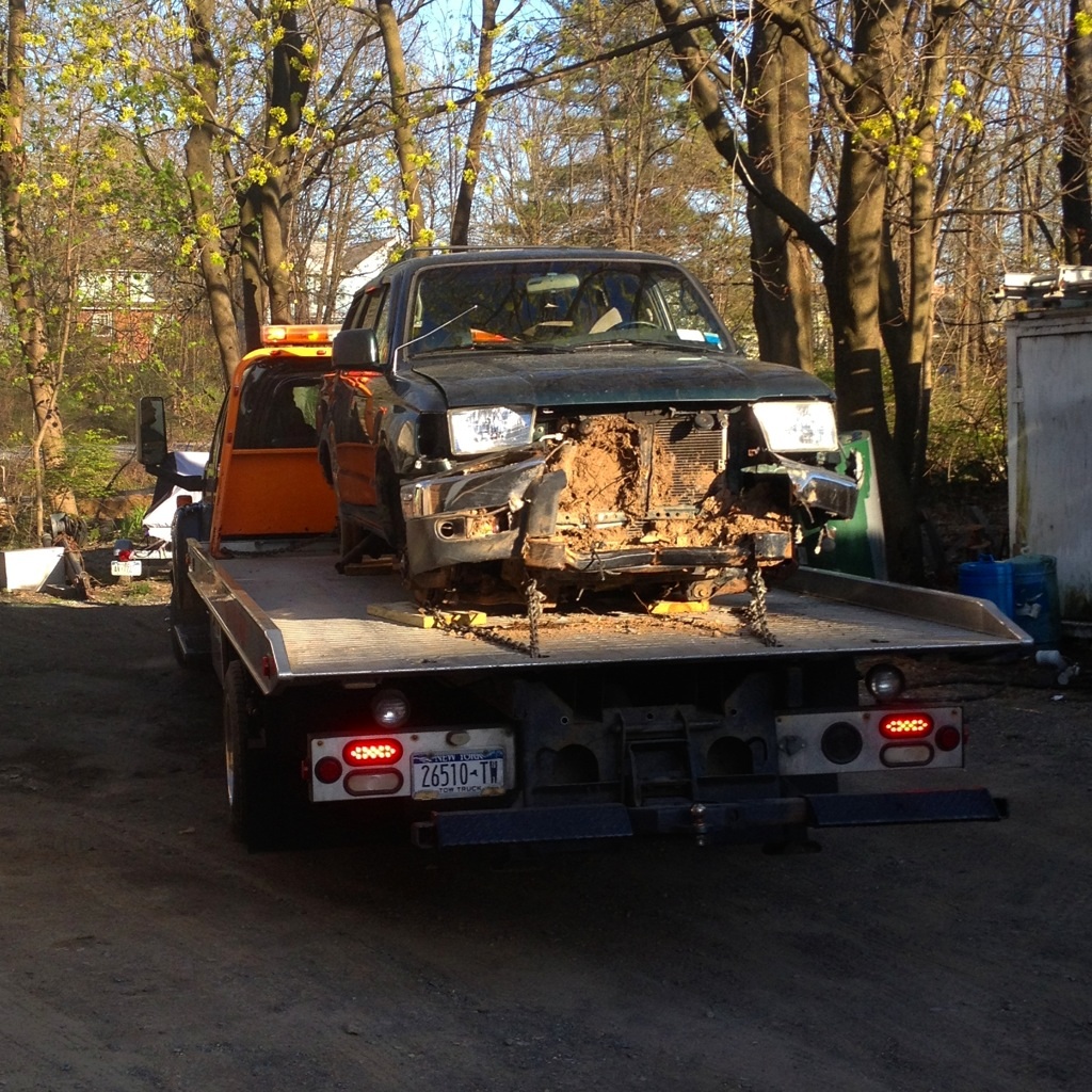

Old Apr 26, 2013 | 04:59 PM
Sas954unner's Avatar
Joined: Apr 2013
Posts: 116
From: Hudson valley-New York

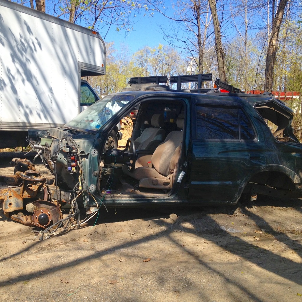

5vz donor vehicle
Backing the 5vz donor 4runner in the garage

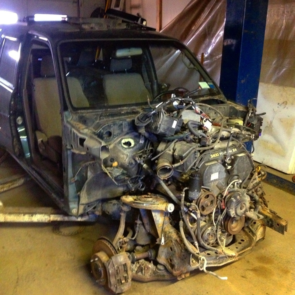

Old Apr 26, 2013 | 05:15 PM
Joined: Apr 2013
Posts: 116
Stripping
Stripped the front off today and soaked the whole drivetrain with penetrating oil
I'm planning on starting again first thing tomorrow morning.
My goal is to have the 3vz and 5vz both sitting on engine stands by tomorrow night. =]

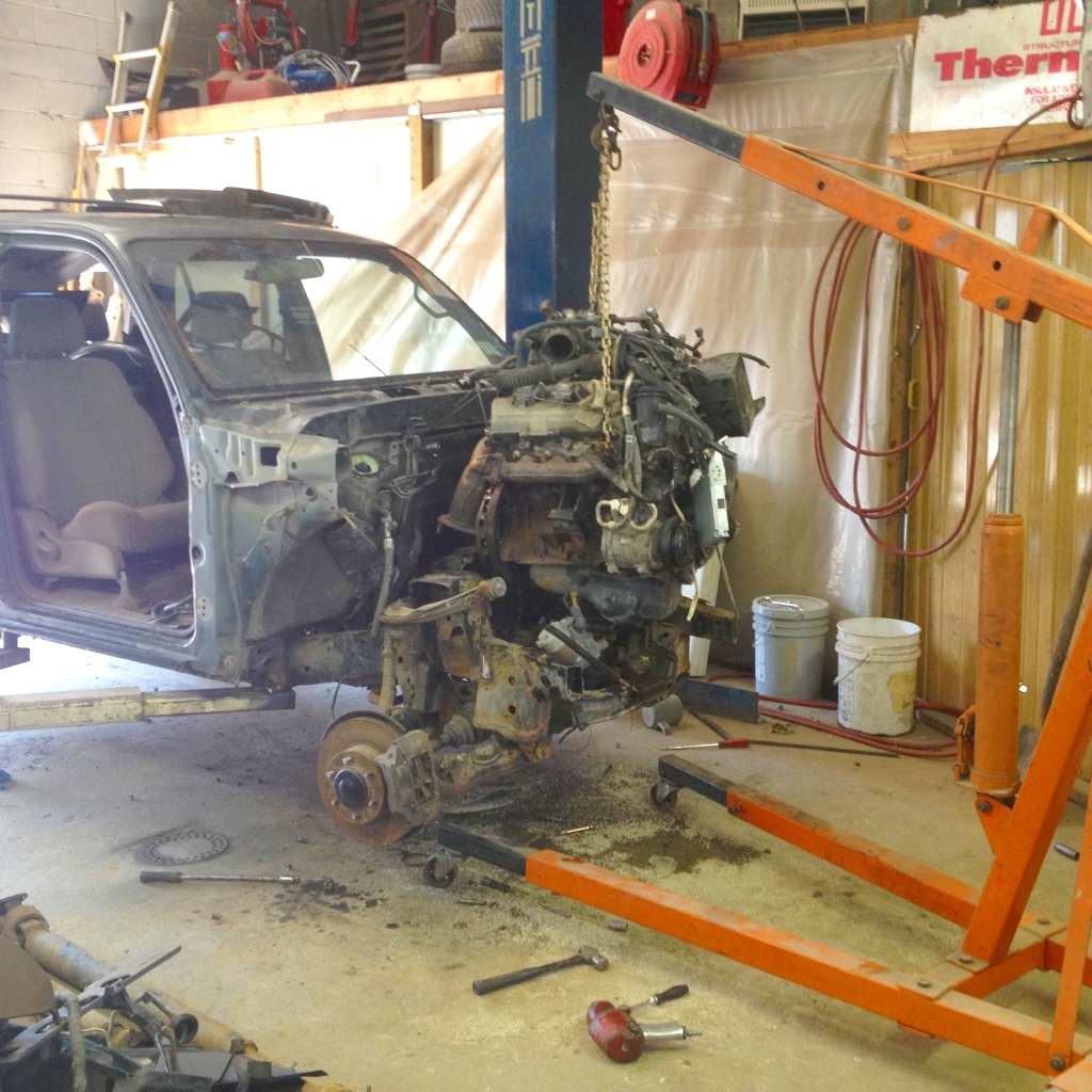

Old Apr 27, 2013 | 02:05 PM
Joined: Apr 2013
Posts: 116
Pulling the motor
Got hungup a bit on the dowel pins around the bell housing. Nothing a few pry bars couldn't handle
Attached Thumbnails My first 3vz-e to 5vzfe conversion in my sas'd 4runner(any pointers appreciated)-image.jpg

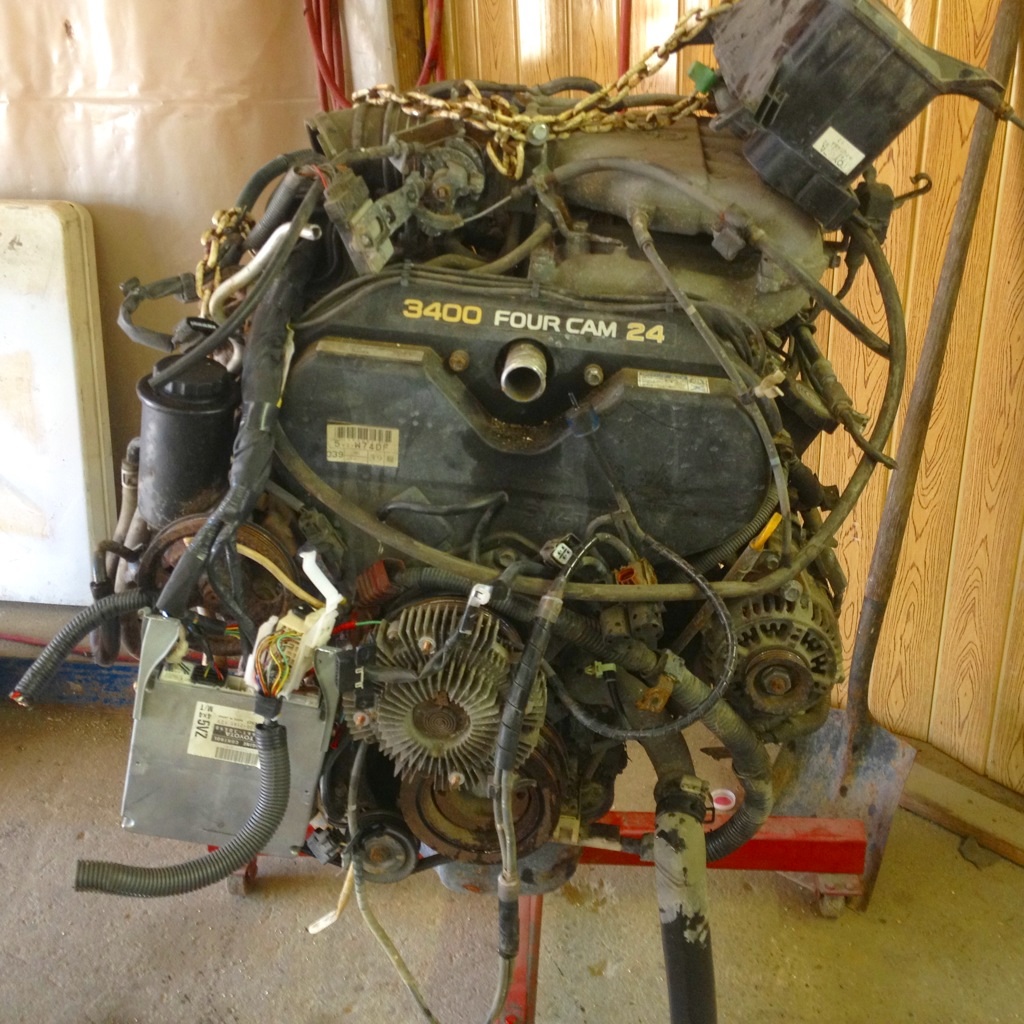

Engine stand
Unfortunately the oem tranny bolts weren't long enough to make it through this snap on stand and bolt it into the block. So I ended up cutting a piece of threaded rod up that was just small enough to fit through the threaded bel housing bolts.
Looking at the wires that had to be cut out of the car I'm not too excited about the amount of wiring that needs to be done, however it will get done one wire at a time

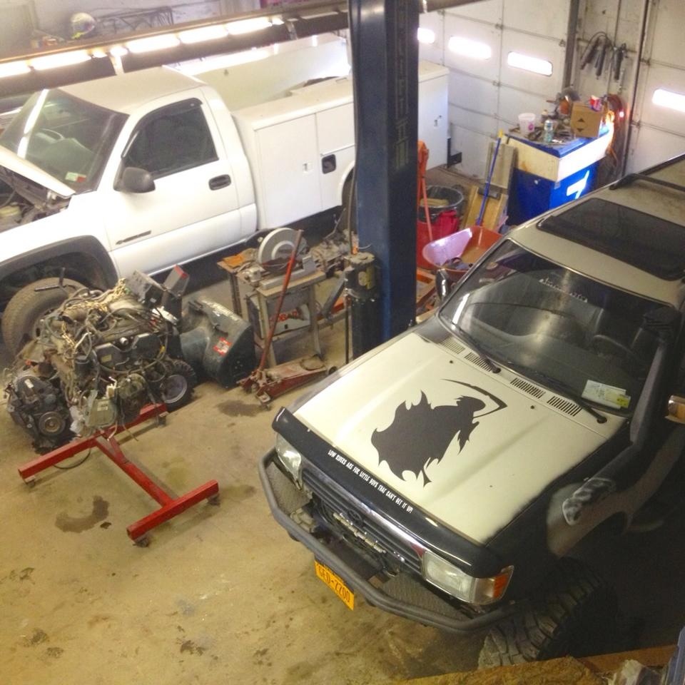

Old Apr 27, 2013 | 03:28 PM
Joined: Apr 2013
Posts: 116
Lights out for the night
Back at it again tomorrow bright and early!

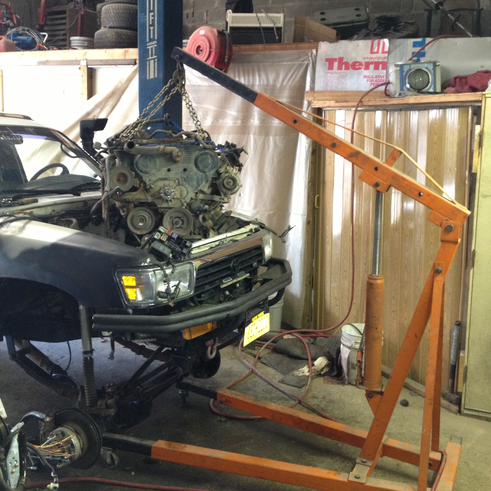

Old May 1, 2013 | 03:23 PM
Joined: Apr 2013
Posts: 116

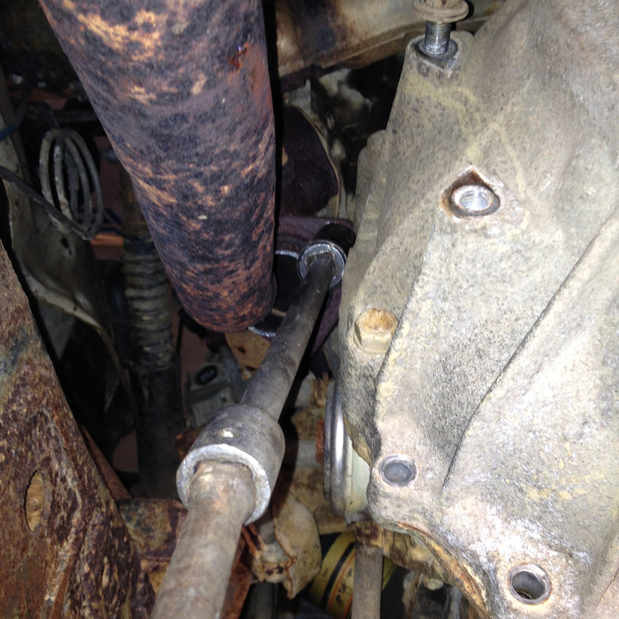

Cut
Had to cut the exhaust so I could get a socket on the inside nut
Old May 1, 2013 | 03:48 PM
Joined: Apr 2013
Posts: 116
Pullin out
Pulling the engine out
