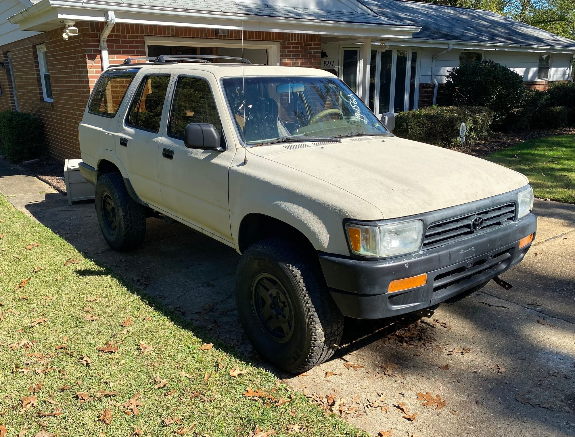

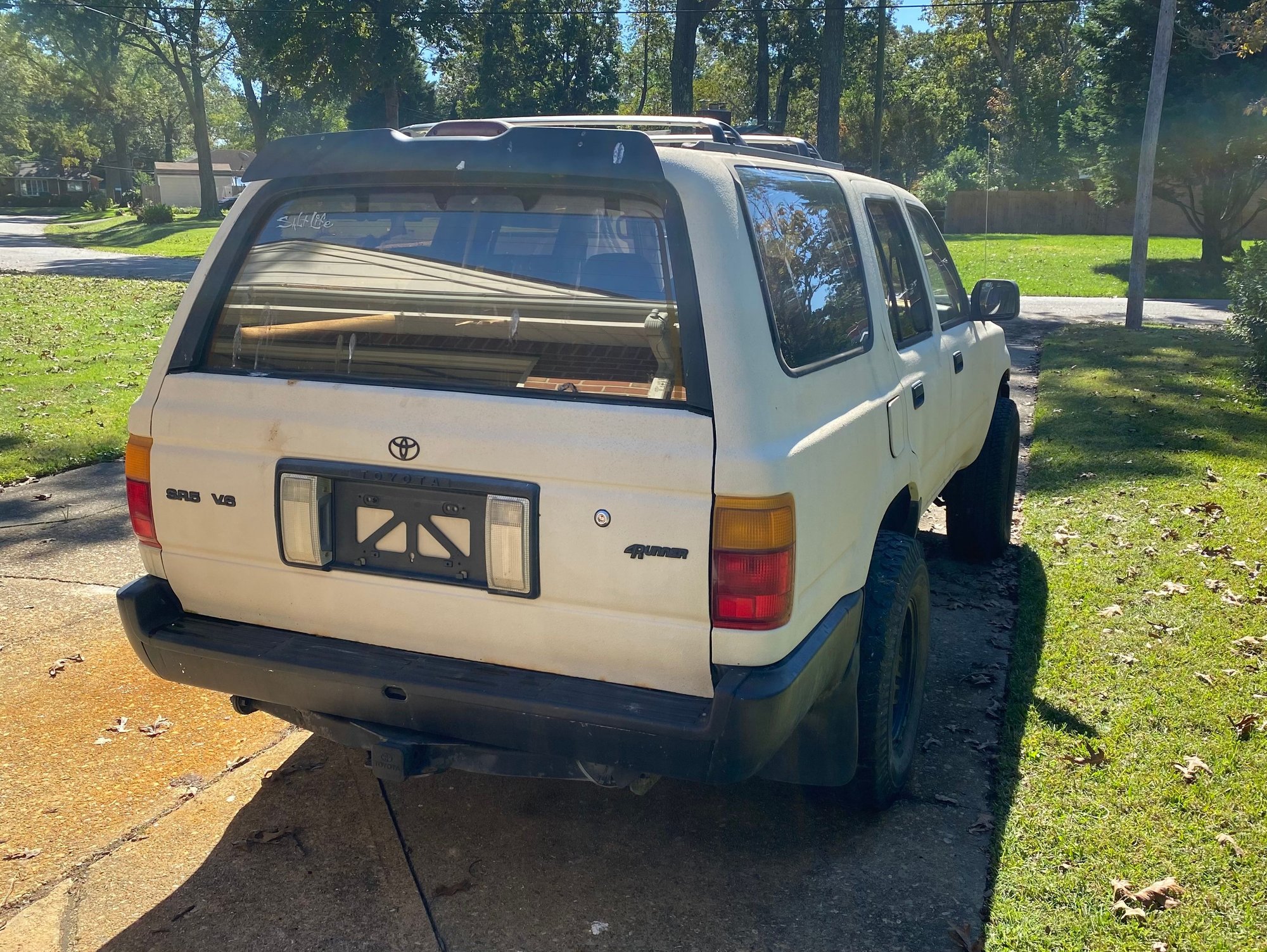

Putting this here to get the thread started.
The Basics: 1995 4runner, 4wd SR5, 5spd manual 3vz V6.
The acquisition: I bought the vehicle at auction just like the first couple photos without knowing whether it would run or not. Grand total of $200 plus free towing a-la friend-with-a-trailer to its current spot. Chassis and (original) engine has(had) 256,000 miles on the odo and it was parked at a sea-side impound lot. Needless to say, we're dealing with some corrosion issues, but I think that not all is lost. Hooked up a battery (129 die hard gold) and swapped out the starter ($95 aisin remanufactured) and alternator ($136 carquest 80 amp remanufactured) (corrosion made me doubt the old alt). Truck started right up without a hiccup. Accessory belts squealed to high heaven, so I let them run a bit to knock off the rust, then swapped all three out. For roughly $575 I had a running 4wd that went into all 6 gears and engaged 4wd properly. Pretty dandy if you ask me, but the fun didn't stop there.
I got on here to do my research (naturally) and the 3.slow rumors started to get me worried I might have future head gasket problems. the 3.4 swap sounded appealing, but I've never done an engine swap before. Casually cruising FB Marketplace, I came across a (no !#$%) $100 complete 1997 3.4L 5VZ. 238,000 miles on its ODO. Included starter, alt,(supposedly) working a/c compressor, power steering pump, engine mounts, fan, engine harness and ECU (later found out were from a 2001 automatic 4wd. Major head ache for the swap. We'll get there.)
Bought the engine, naturally before I had a hoist or an engine stand for the rebuild.
Shocks top mount hardware was all rusted out, so bought replacement Bilstein 4600s. (wish I had gone with the beefier 5100s in hind sight.)
Picked up an air box, MAF sensor, emissions equipment, 02 sensors, and a manual ECU at a local 3rd gen part-out I found on FB Marketplace. totaled $60. These are not realistic costs normally, but I packaged them all for a steal.
Stainless BYO Exhaust kit (2.5"), DNJ Engine rebuild kit (wasn't going to just throw the 238k unknown history engine into it without tearing it apart first to know what I was working with. It was only $100 for pete's sake.), Magnaflow muffler, and Flowmaster cat for the good sounds and efficient flow.
Realized the crosstube was from a 2001 also (not the kind that's easy to convert to a driver side downpipe) so bought the toyonlyswap version for $300. Seems like it's in excellent shape so far. Am I insane for buying all these parts for a truck that only cost me $200 to begin with?

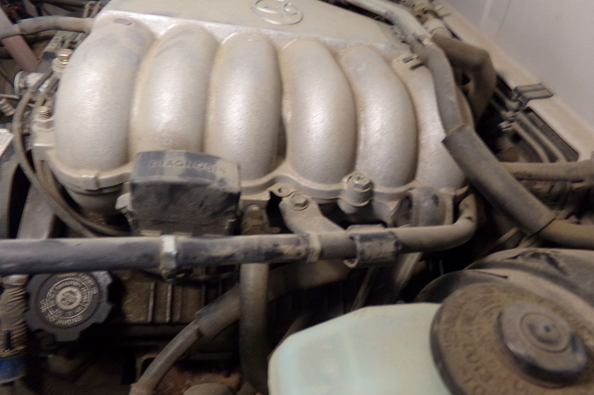

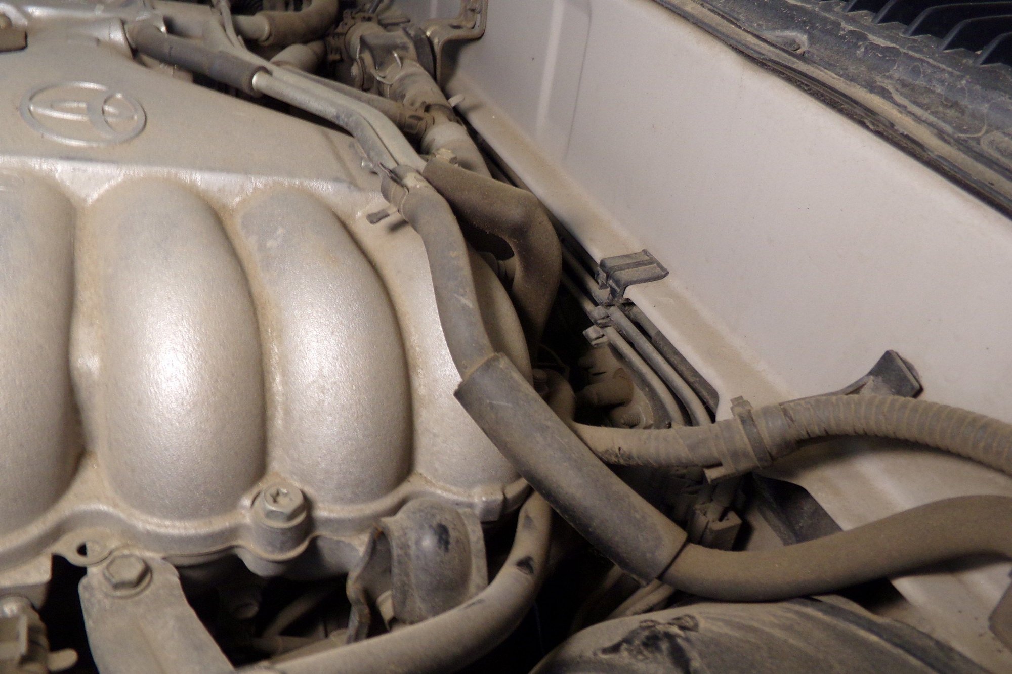

plenum connections
Here's two pics from a 99. The pic of the plenum; that's the brake vacuum on the 3rd runner between mount bracket and Diags connector.
Not sure which other tube you refer to, so second pic is most of stuff on backside.
