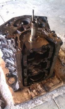

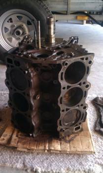

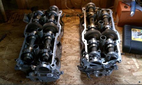

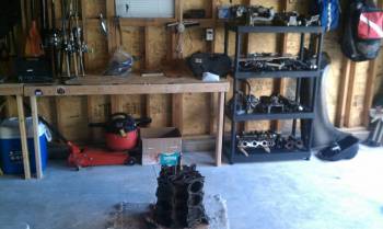

OK new heads have been purchased got a sweet deal 2 heads that have been reworked for $300. The engine is stripped down to block crank rods and pistons and ready to take to machine shop. Here are some pictures of the block and my garage work area, no much to look at but trying to document as I go along.
Attached Thumbnails I am doing it 3.0 to 3.4 swap with complete engine rebuild-resized1.jpg   I am doing it 3.0 to 3.4 swap with complete engine rebuild-resized2.jpg   I am doing it 3.0 to 3.4 swap with complete engine rebuild-resized3.jpg

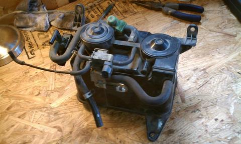

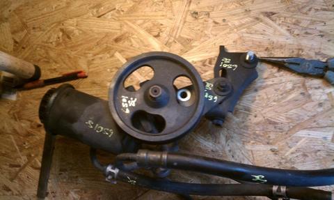

My new heads came in today along with all the gaskets and head bolts. I have also started to take pictures of all the parts required for the swap psp, starter, vsv and so on.
Attached Thumbnails I am doing it 3.0 to 3.4 swap with complete engine rebuild-new-heads.jpg   I am doing it 3.0 to 3.4 swap with complete engine rebuild-power-steering-pump.jpg   I am doing it 3.0 to 3.4 swap with complete engine rebuild-vsv-canister.jpg

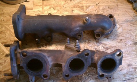

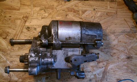

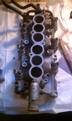

here is the starter, intake and manifolds
Attached Thumbnails I am doing it 3.0 to 3.4 swap with complete engine rebuild-starter.jpg   I am doing it 3.0 to 3.4 swap with complete engine rebuild-intake-injectors.jpg   I am doing it 3.0 to 3.4 swap with complete engine rebuild-rsz_exhaust_manifolds.jpg

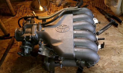

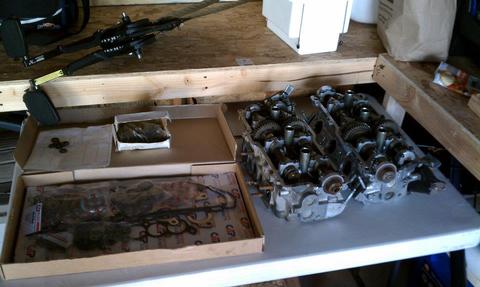

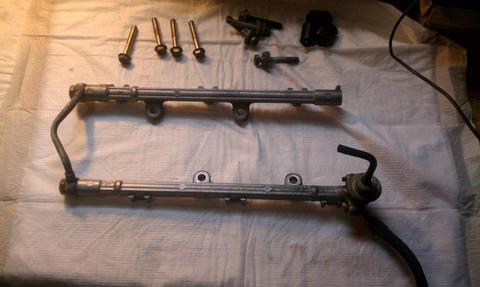

Lastly here is the rest of the intake/throttle body, fuel rails and heads with gaskets. I have been cleaning all the old parts getting them ready to install. Also still need to get the block into the shop to get worked over. I am still looking over all the yards for a crossover, I am going to go with the toyotaonlyswaps crossover but I need to get a core to send off to them. This week I hope to start to look at the wire harness and mark all my wires to make the whole process faster.
Attached Thumbnails I am doing it 3.0 to 3.4 swap with complete engine rebuild-thottle-body-intake.jpg   I am doing it 3.0 to 3.4 swap with complete engine rebuild-fuel-rails.jpg   I am doing it 3.0 to 3.4 swap with complete engine rebuild-new-heads-gaskets-head-bolts.jpg
