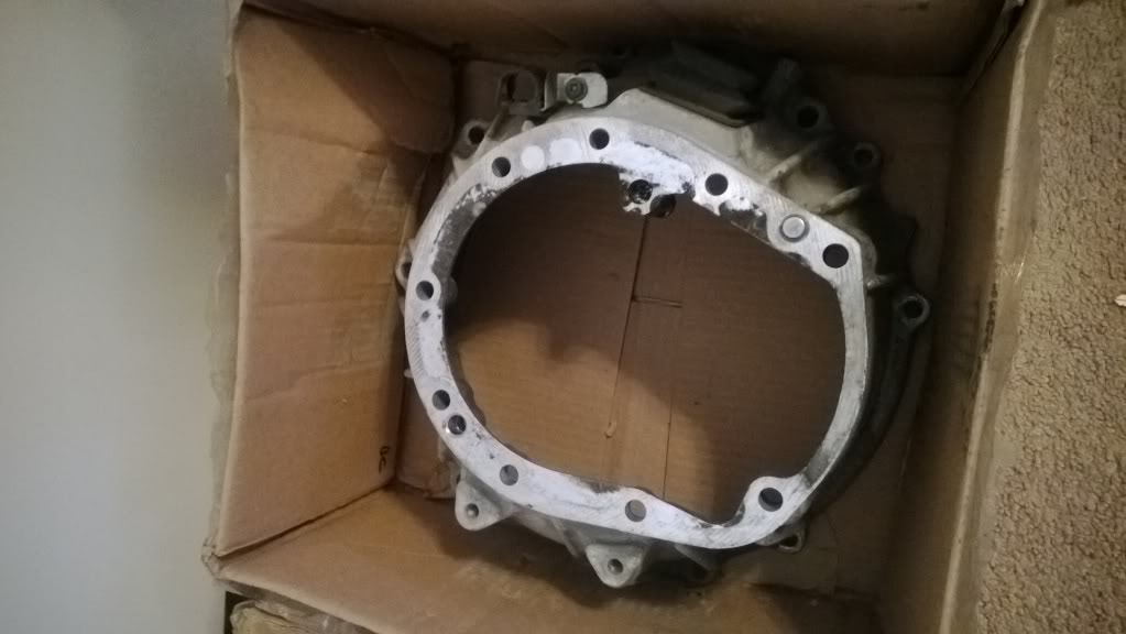

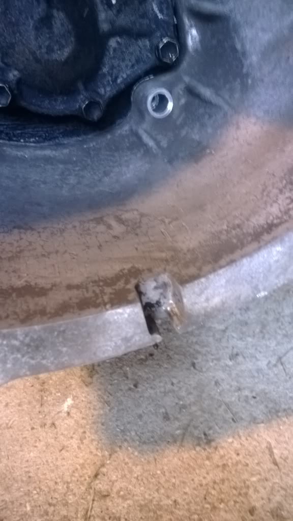

bellhousing came in
it fits the tranny, this should be the ticket for my swap

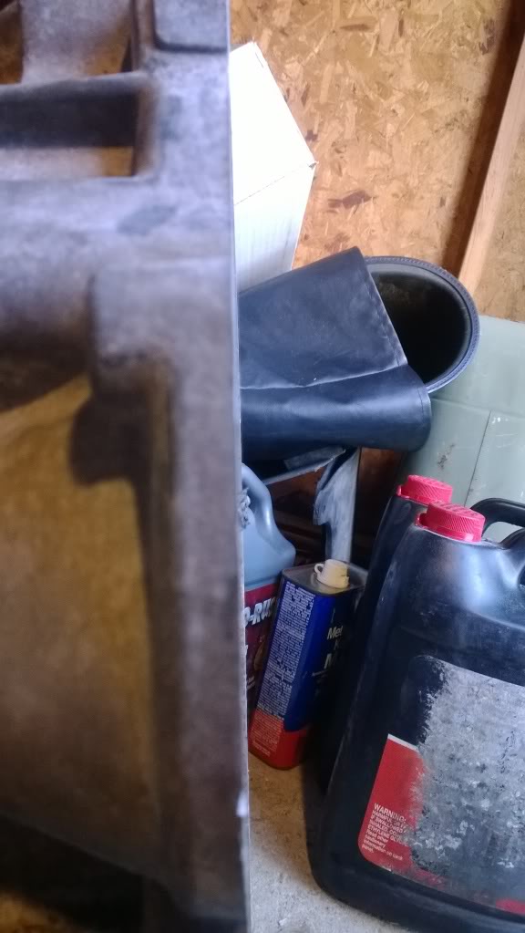

the shaft sticks out about 0.125" from the face of the bellhousing (i estimated)

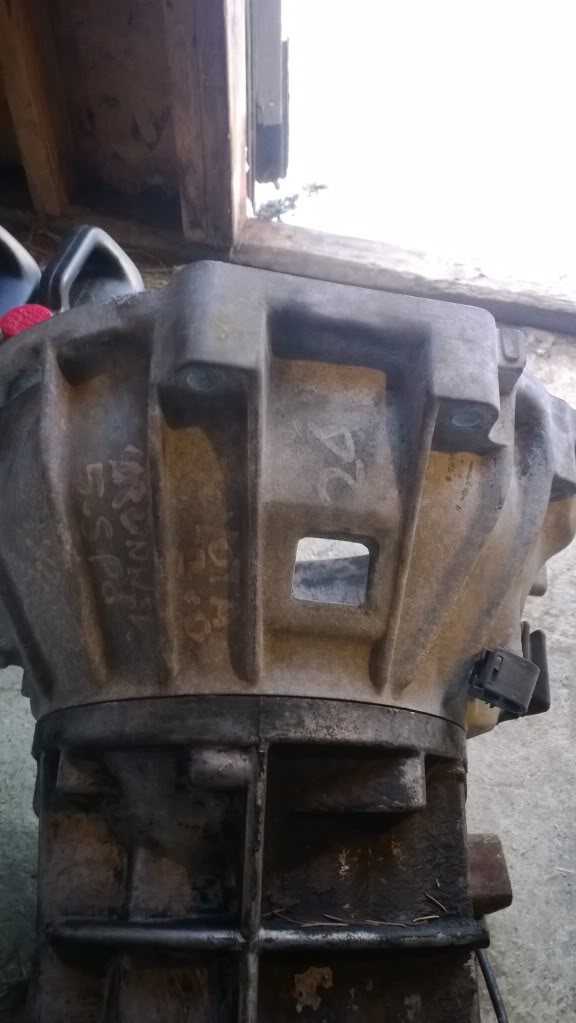

drain at the bottom
vent at the top
hole that needs to be covered

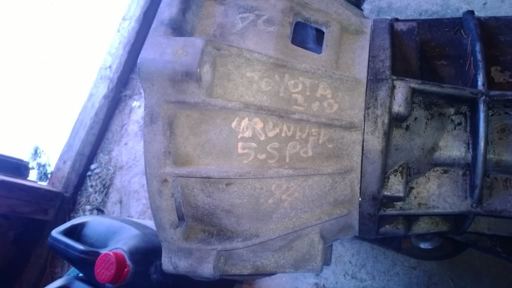

"toyota 3.0 4runner 5-spd 94"

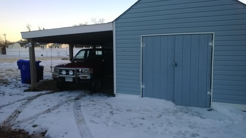

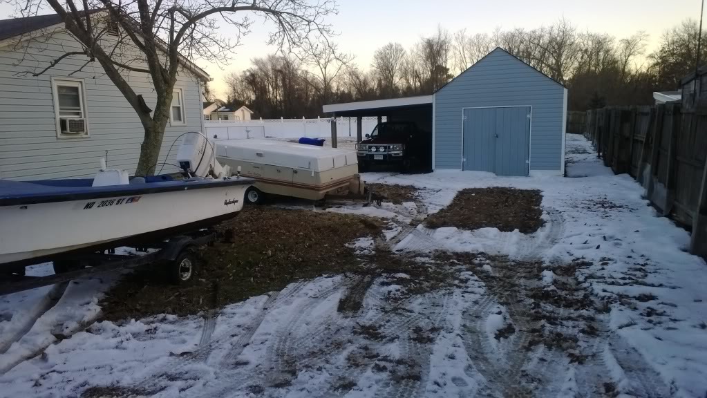

moved the toys and parked the truck where i'll do the swap
ready for the parts truck (hopefully i can pick it up next weekend. there was a huge snowstorm - 2 feet - where the runner is right now)

Looks like you are missing a dowel on the bell housing. Make sure you have them both. Should swap from the other one. Make sure one isn't stuck in the trans or you might crack something when you tighten the bolts down.
There is a rubber vent thing for the hole in the top.
Snow sucks! Unless you're playing in it. 94 degrees in Az today. Summer's going to suck though.
Glad you found a donor. Your swap will go so much smoother.

thanks. i took that dowel out as i already have both in the spare trans. i'll probably be ordering a bunch of hardware for that, seeing as i don't have a v6 with bolts already there.
since i'm doing mild trans tunnel work, i may also add a top hole for ease of transmission removal (for the two top bolts). just a thought for now
