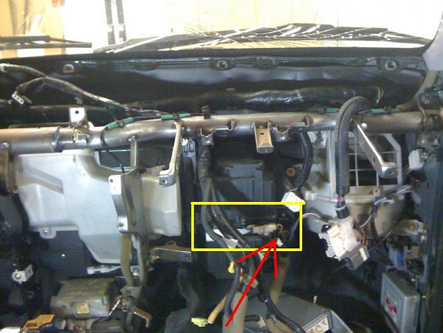

Where is the 3.4 amp located at? I know virtually nothing about AC some this I am not sure of.

a/c amp is screwed into the heater box on passenger side

Any way you could highlight it from this photo please?

you may need to pull the heater box out to get the temp probes out.

Thanks! I'll be sure to grab that out before I scrap it.
