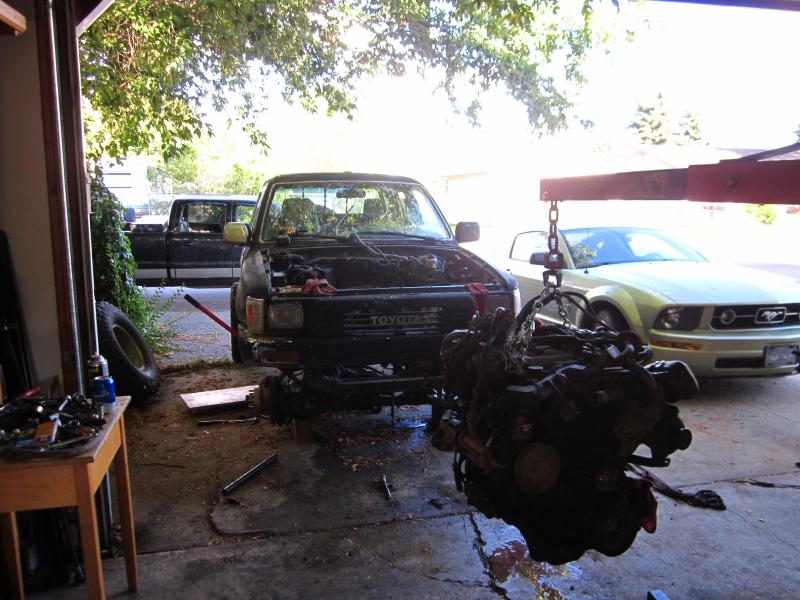

The donor, 1995.5 Tacoma.

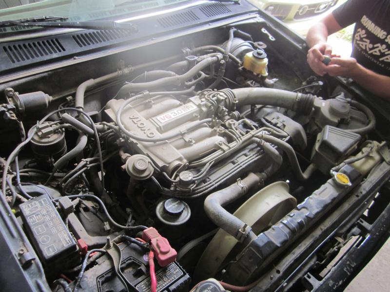

Pulled the 3.0 a few weeks ago.

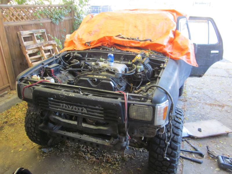

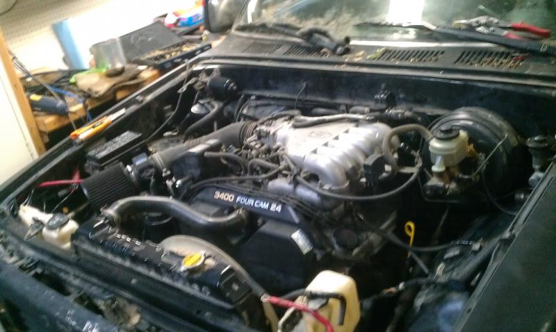

And dropped the 3.4 in last weekend.
Didn't take many pictures while it was on the engine stand but I also installed a new timing belt, water pump, pulleys, valve cover gaskets, intake gaskets, etc.
ADD system and rear heater are also being removed.

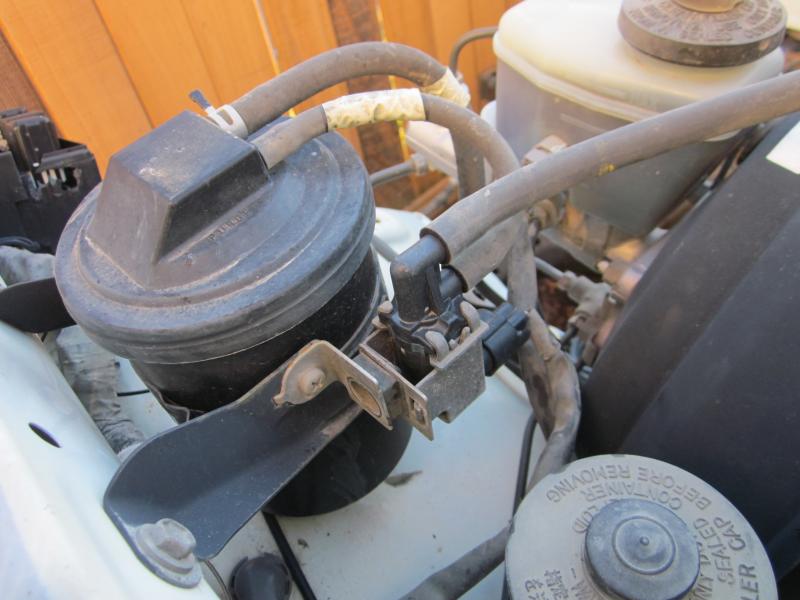

1) The Tacoma has no EGR system or an EVAP box. It just has an old style charcoal canister with the addition of a single VSV.
So basically all I have to do as far as EVAP goes is hook up this VSV between the intake manifold and charcoal canister, correct?

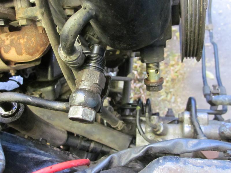

2) Most of the info I've found says that you can use the 3.4 power steering pump with the 3.0 lines as long as you use the 3.0 bolt. But after looking at the two side by side it doesn't look like there's anyway the 3.0 bolt will fit. Am I missing something?

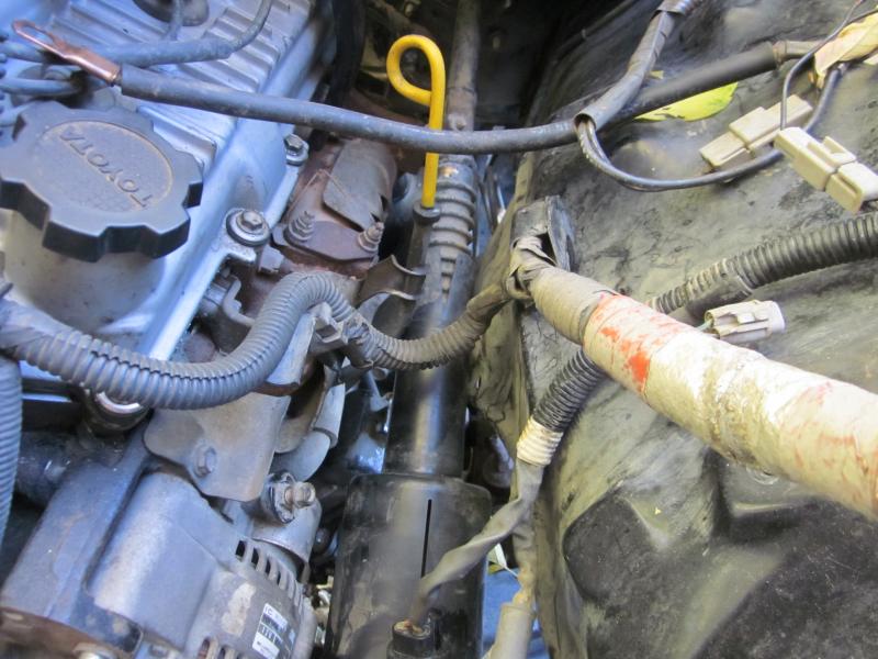

3) There's barely ever any mention of the transmission wiring/connectors.. I assume for a manual the only sensors would be for speed and 4WD, are the connectors the same? Also, any tips on routing this part of the harness past the exhaust and steering shaft?
I'm sure more will come. Any comments or advice are appreciated.
Cheers!
Old Sep 30, 2013 | 05:18 PM
vital22re's Avatar
totally a bro
Joined: Feb 2006
Posts: 8,158
Likes: 47
From: kick yer face
swap over all the emissions components including o2 sensors.
The power steering fitting youre holding still has the bolt stuck in it. You need to remove the bolt from the "nut" and it will bolt up to the new pump.
I usually run the wires for the trans down and along the torsion bar then cross it over to transmission running under the heatshield for the exhaust.

What Vital said..............except I have no torsion bars anymore so zip ties are my friend as tight to the trans as possible and away from the exhaust. Not much to work with but doable.
Interesting.....I have never seen that EVAP setup before on any 96+ Tacoma or Runner.

Thanks man. I'll try to loosen that nut from the power steering bolt, its really on there!

Yeah the whole thing had me a bit confused at first since most swaps I've seen involve that evap/squid box.. I'm really liking it though, no EGR system and only one vsv for evap. Should be a very simple, clean engine bay when all is said and done.

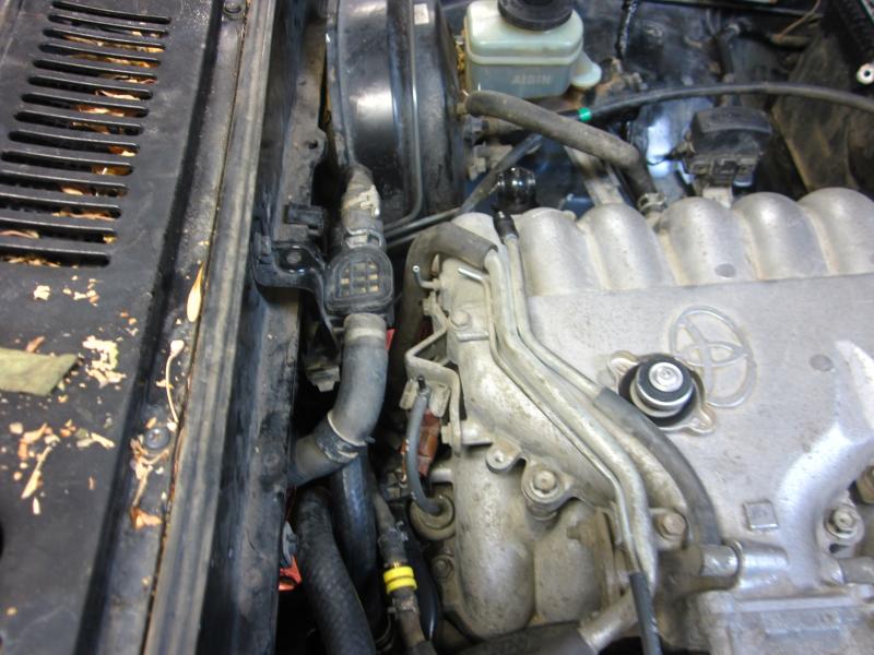

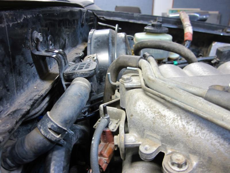

There's a few vacuum lines on the back of the intake manifold that were knocked off while the engine was being dropped in.. Specifically the 3 ports shown below.
I'm pretty sure there was a T fitting between the three but I can't remember.
Does anyone know how these hook up? I would really appreciate it!

those need to be tee'd together. That hose comes up from the fuel pressure regulator. Connect the three for now, that should solve some of the fuel deprevation.

Actually I found some old pics from when it was on the stand, the two metal ports tee off to the ADD system and the VSV was just missing its cap thing.
