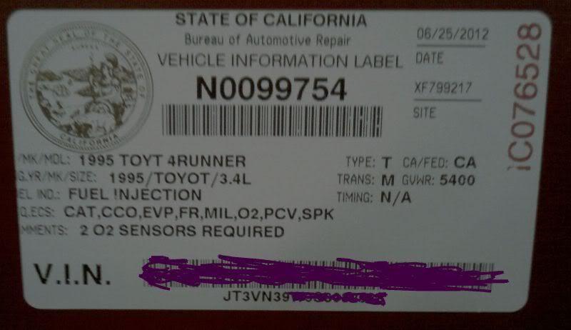

I PASSED!!!!
I'll post the pic later....
I have been blessed by the State of CA for the privilege to drive my truck in this beautiful state again!
Old Jun 25, 2012 | 10:21 AM
  #152
anthony1's Avatar
Joined: Oct 2003
Posts: 1,561
From: torrance, CA.
Here it is!

WOO HOOOOO! Great news, man! Congratulations.... NOW I know who to go to for input on "CA Legal 3.4 Swap", right? hahaha...
BTW, if I were to do this swap, 1UZ or 3RZ, any swap... I have to go straight to the ref?
Old Jun 25, 2012 | 11:48 AM
  #154
anthony1's Avatar
Joined: Oct 2003
Posts: 1,561
From: torrance, CA.
Yep. The smog shop is not suppose to touch it until you get that sticker on.
I'm glad that I can go through the process with my integrity intacted. I know poeple that can help me go around the process but then I'll have to keep paying more for smog test...know what I mean?.....
